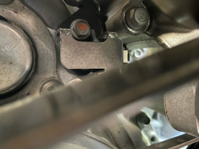

Update: I used my boroscope to look at the pigtail and connector to the CMP. The CMP bolt bolt looked pretty clean compared to the other parts around it. That said, I re examined the invoce on the trans work including the pigtail connector. The Ah Ha moment when I saw they stated replacing the pigtail and the CMP. So, I have the GM 19420911 coming from Rock Auto.
I'll update when installed. I am pretty sure this will fix it. (fingers crossed). oh yeah...I see that my issue is in the wrong section. Pardon me, Getting up there, detail eludes me.
