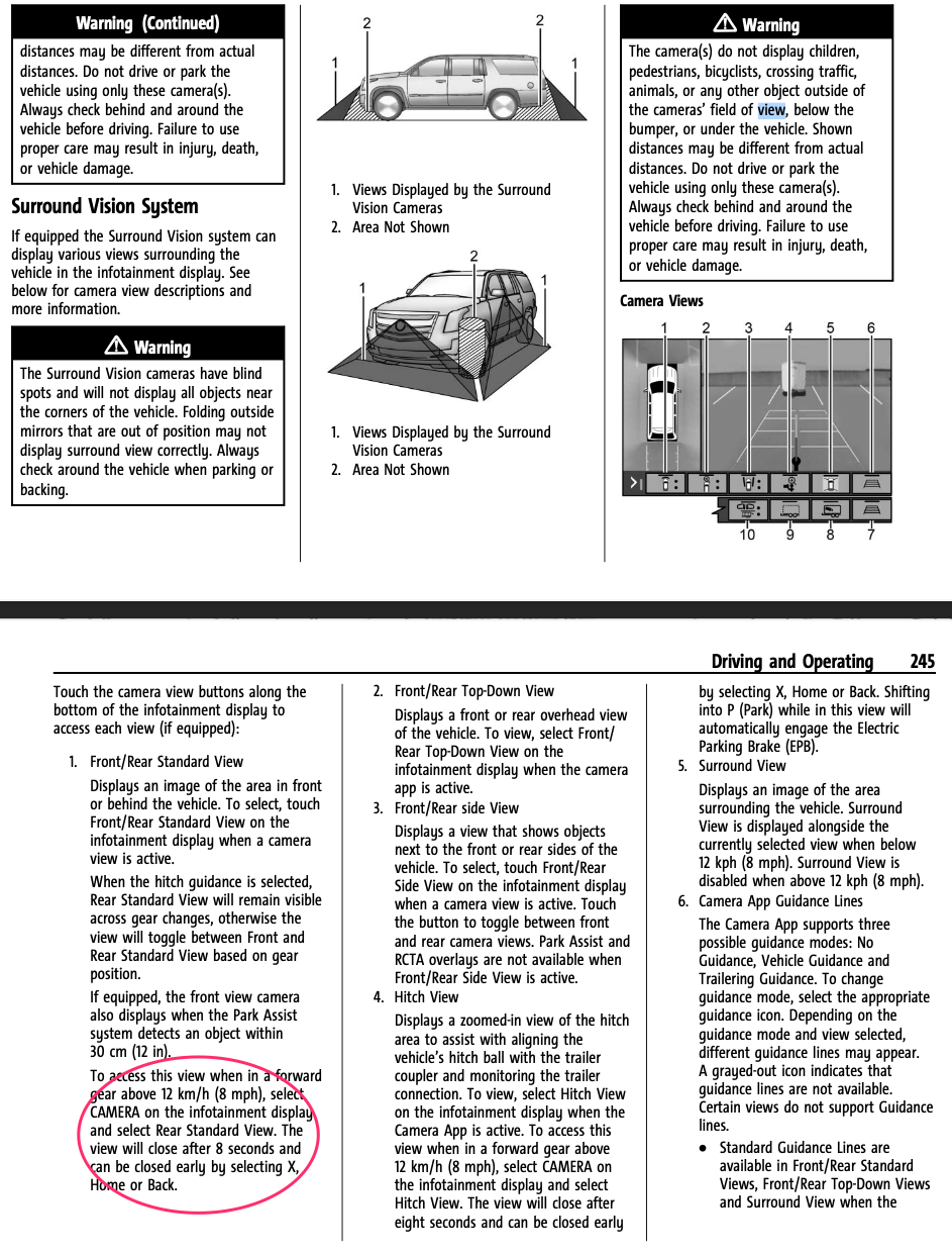

No, only a very limited number of them...Hitch View is one, as is front and rear facing, The owner's manual indicates which ones can be accessed when going more than 8MPH...see example below:

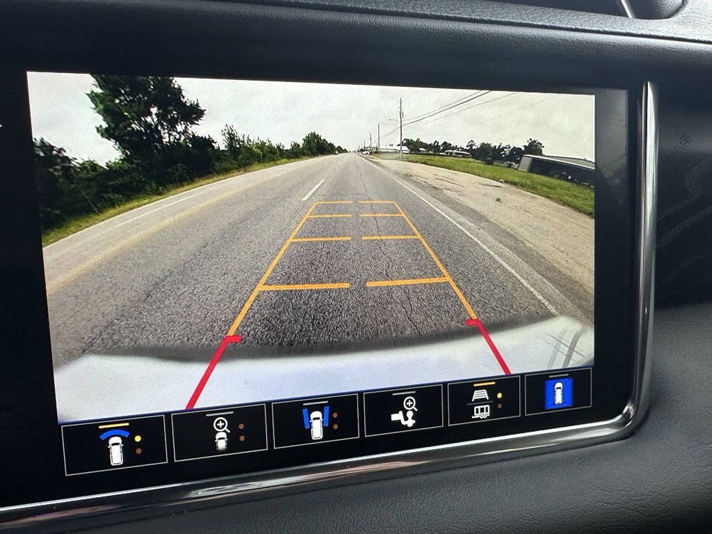

I have a 2023 Denali and the front and rear camera stay on at any given speed and do not turn off until I hit the X. My 2022 Denali only lasted 8 seconds before it auto shut-off. I bought the 2023 used so I don't know if the previous owner did anything special to it. Service records don't show any work for this feature being modified.
BigdawgR6
Feb 6, 2023
188
116
Actually, all the views are available while driving and don't turn off. This was at about 45mph.
