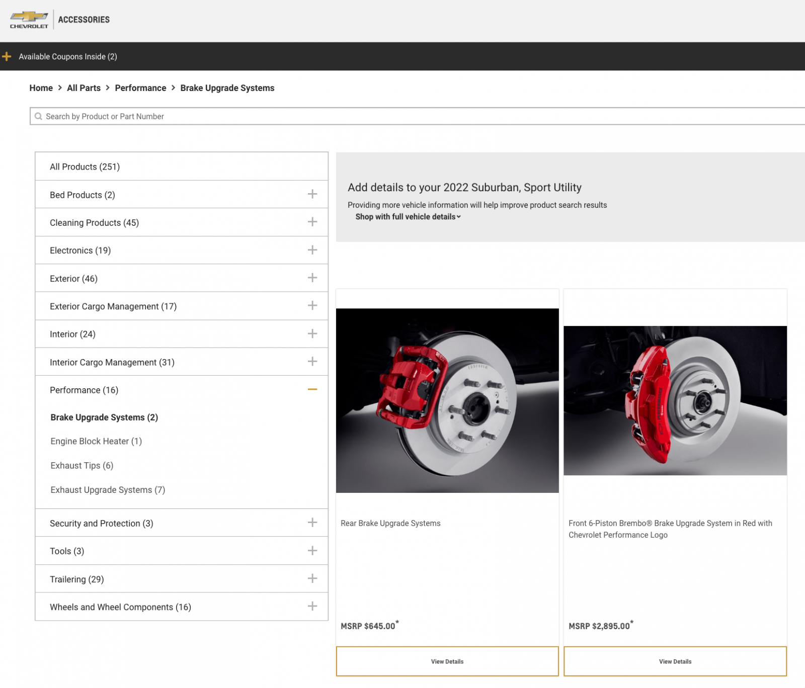

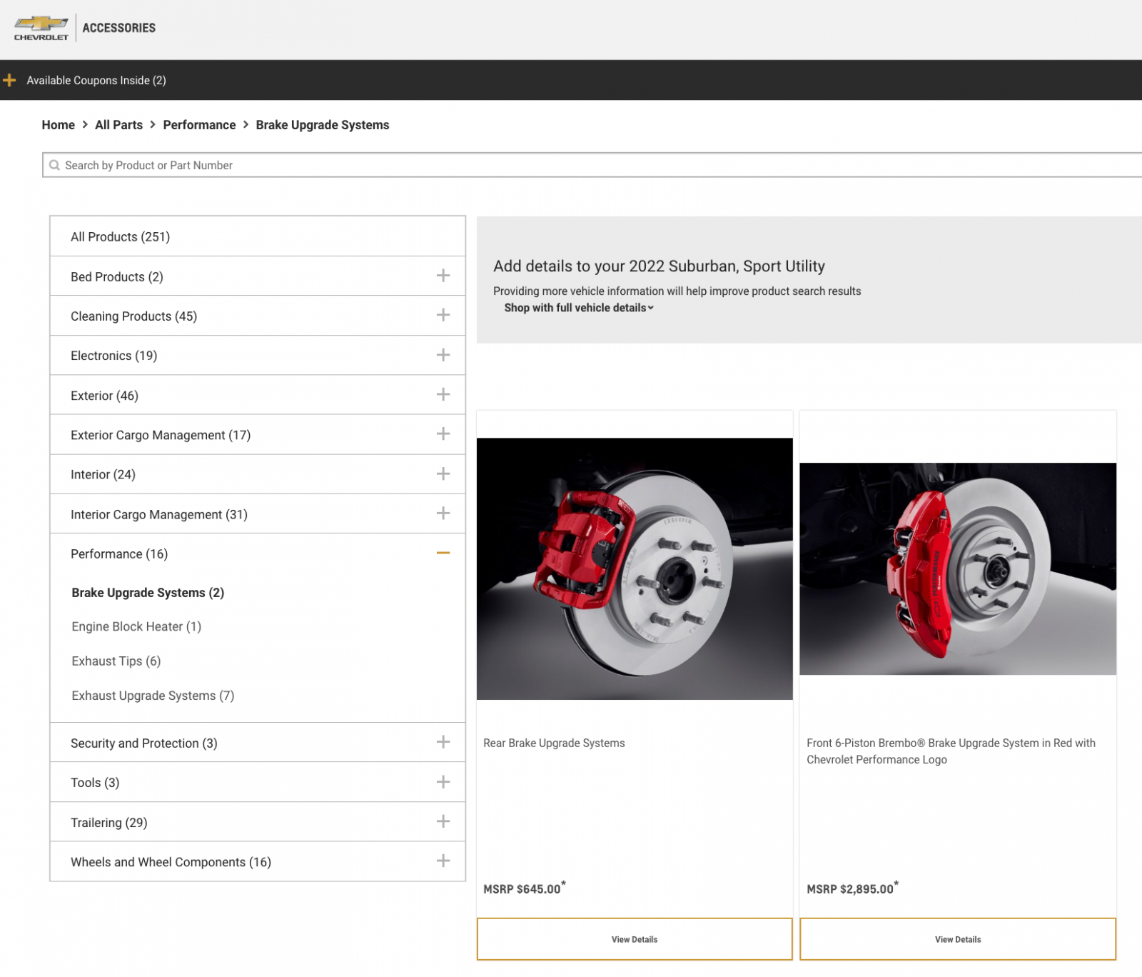

There are 2 accessory kits available, one for front, one for rear. Rear set is really stock calipers painted red to match...front is a true brake upgrade including brembo calipers and larger rotors. See screen shot below.
Had not heard that you lose TPMS capability, I do think you may lose pad wear indicator capability.
Per Chevrolet Accessories Web site:
-Font Kit P/N is 85138043
-Rear Kit P/N is 84436255
