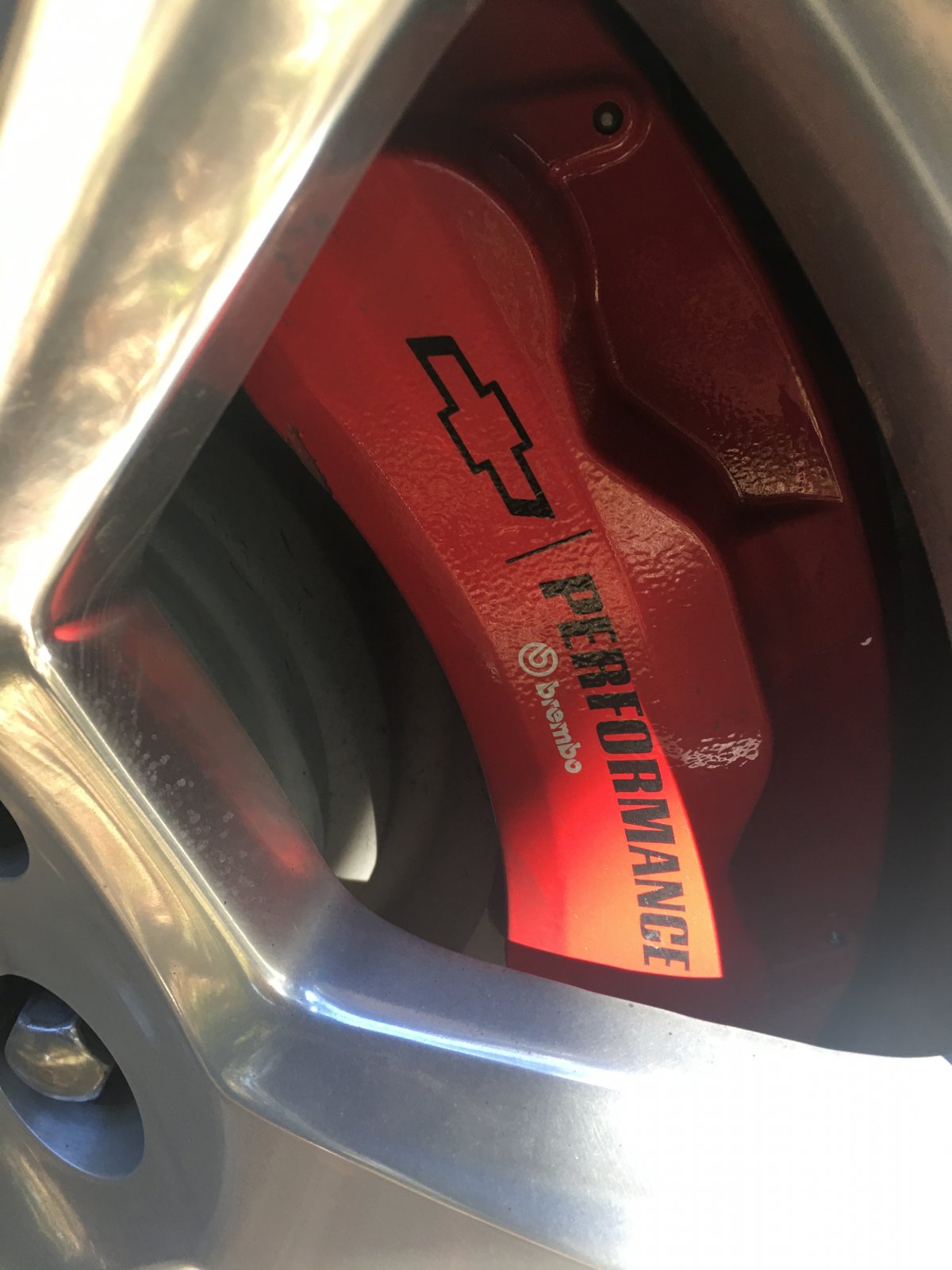

I finally got around to doing the Brembo upgrade. The rotors are massive and there is nearly no space between the caliper and the oem 20” wheel.

Do you have sticky wheel weights on those wheels, and if you do, is there enough clearance for them?
The weights are close to the spokes of the wheel. But there would be clearance for one row.
