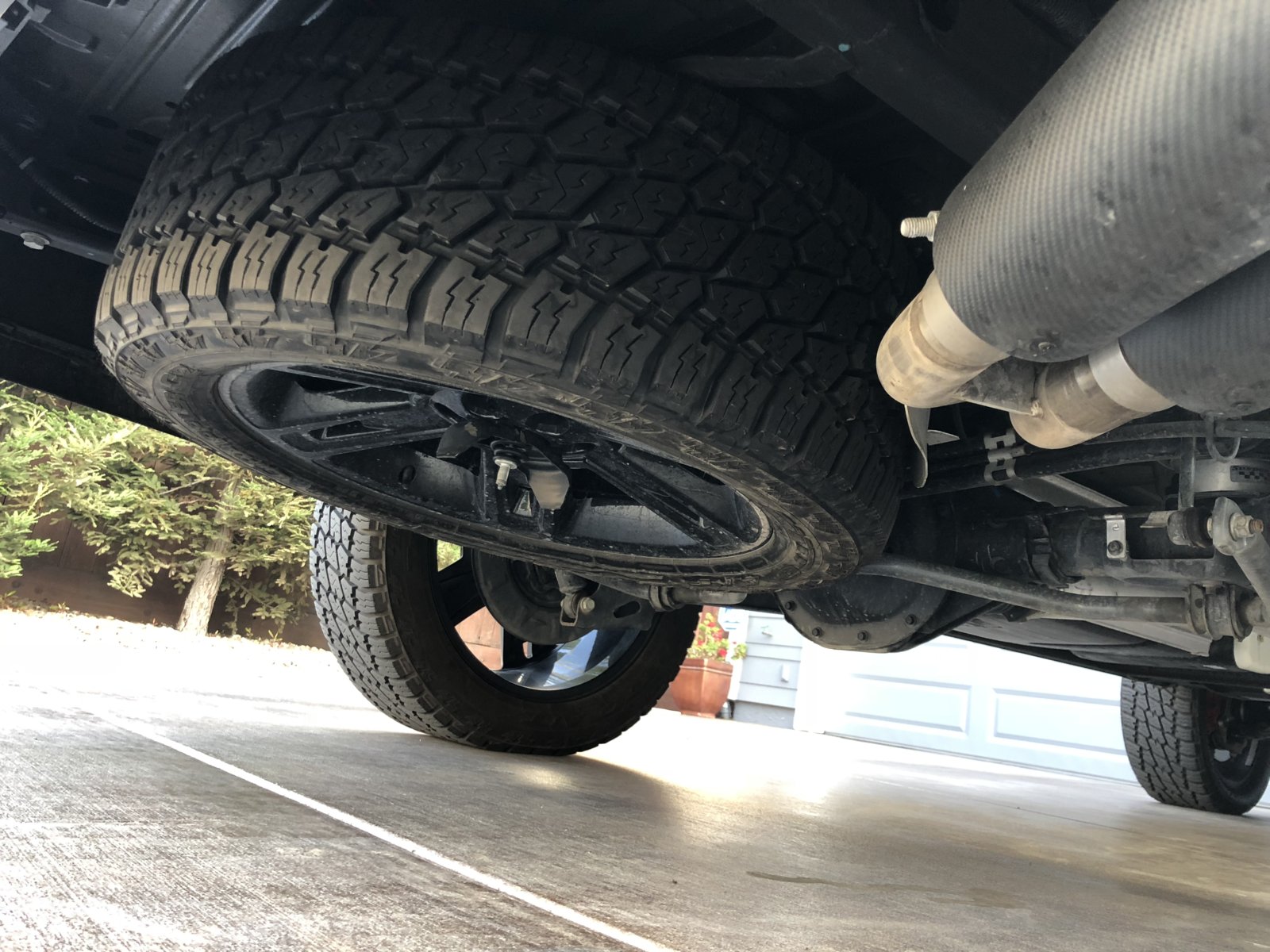

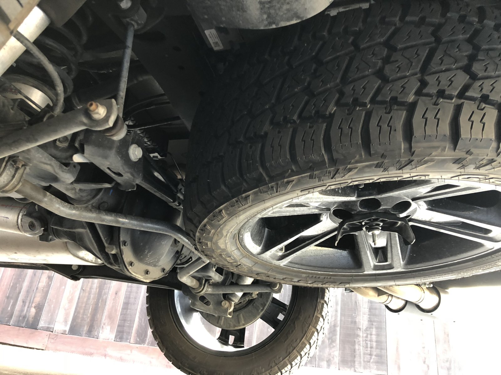

I have an oem 22" GM wheel and a 285/50/22 (33.27x11.69) Toyo ridge grappler for my spare
cbraga
Dec 29, 2009
64
48
Hello does it fit in place underneath of the regular spare?
Sure does, no modifications either
07454960-9F50-42EA-BA9C-BC3A92EC6104.jpeg D1C8A8EA-E856-4B5D-B38F-8FF5A139C0EF.jpeg

As you can see from my Avatar, the previous owner of my Z-71 Tahoe put a seven-spoke wheel on the front passenger tire (I am not sure why, but if you look at the step bar on that side it is bent too).
I got a six-spoke wheel and had them mount a 22 inch spare the same diameter as the stock 17 spare (I think it is a 255/45R22. However, from what I am reading the hole in the OEM wheel may not be sufficient to accommodate the hoist? Is that correct?
I see the pics with the black wheel above...can I flip my spare to face up and protect it or is there something under the back that might scratch it? Can someone please show me some pics?

The winch/hoist for the spare utilizes the center of the wheel for leverage - any 16"-22" rim that has our bolt pattern is going to fit under the truck. You remove the wheel's decorative center cap to mount onto the hoist.
Tire size - I'm pretty sure the spare tire can go all the way up to 34" diameter without rubbing any underside components. I'm running an 18" spare wheel with 34.25" diameter tire. At the moment, need to trim a little piece of plastic so that I can get my rear hitch cover to lock in place. Currently, the 295/70r18 spare is touching the plastic clip for the cover.
Yes - you can use a 22" wheel with your choice of tire as a spare. If you get the exact wheel and tire as your existing 4, you can have the spare move into the tire rotation as well...
