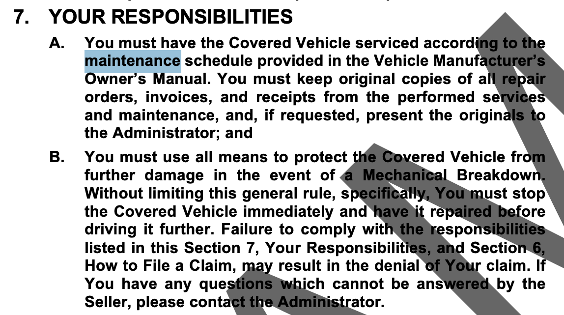

Now, I wonder about people that have a service contract...ever dove deep into the wording there? Virtually all of them have a clause saying something similar to: if you don't follow the manufacturer recommended maintenance schedule and use manufacturer recommended fluids, your service contract provider is not obligated to pay for your repairs.
However, you do make a solid argument that if you went w/ 0W-40, maybe your odds of repairs are not so good.
Man, this whole thing really just stinks.
My hope for my future is:
1) I pass the picoscope test
2) I get 0W-40 cap and oil change
3) I happily run 0W40 forever more (or at least until my trade in date, which is hopefully sometime past 2028
FWIW, here is the excerpt on maintenance from the GMEPP sample contract:
