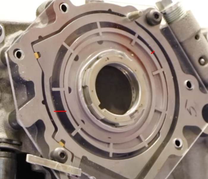

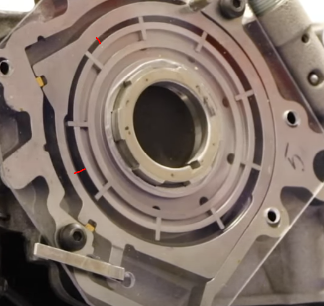

On the topic of the oil pump, look, the guy took the pump apart and showed how it works. It has an interesting spring that, when the pressure is exceeded, closes the pump, reducing the main channel. Now let's imagine what will happen if we fill it with thicker oil 0-40?
The oil creates more pressure, the oil pump closes the main channel valve, supplying less oil to the engine. This means that by pouring 0-40 oil, you are creating oil starvation of the engine with your own hands, reducing the volume of oil supplied by the pump.
The oil pump will work same way regardless of what viscosity oil is in it.
The fundamentals still apply—the higher viscosity, the higher pressure resulting from resistance to flow. I.e. try stirring peanut butter vs water.
From the pump perspective the change is on the discharge side. The oil will be a higher pressure meaning a higher input power to the pump to move the same amount of volume.
The two stage pump design is still a positive displacement, vane style pump. The difference is it changes the volute position such that the inlet side of the pump is pulling in a smaller volume of fluid and it is also not compressing it to the same degree as in it’s default mode of high pressure and high volume.
So the 2 stage pump has a maximum differential pressure across it in default mode, and a minimum differential pressure in its low pressure/economy mode.
It does this by recycling a small pin hole stream of discharge pressure to the stator which not only compresses a return spring, it moves the pump into a low differential pressure and low flow point.
It is like two different pumps altogether in one housing.
So even when the pump is in low differential mode, the pump fundamentals will still apply—the higher viscosity oil will make more pressure relative to the lower viscosity oil in the same pump.
blanchard7684
Senior Member
Dec 23, 2024
447
382
High differential, high flow mode
Low Differential, Low Flow mode
