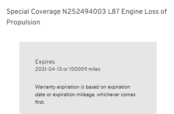

Yes - it's a 10yr warranty but like all warranties I've seen on a new rig, it's from when the rig was put in service, not from a pico test date where no engine parts were changed except the oil cap. If they put in a new engine, then the new engine would have it's own warranty? / different situation.
My 2021 Yukon, put in service at 2021-04-13, now has this additional 10yr (since new) warranty.... till 2031-04-13 or 150,009 miles.
