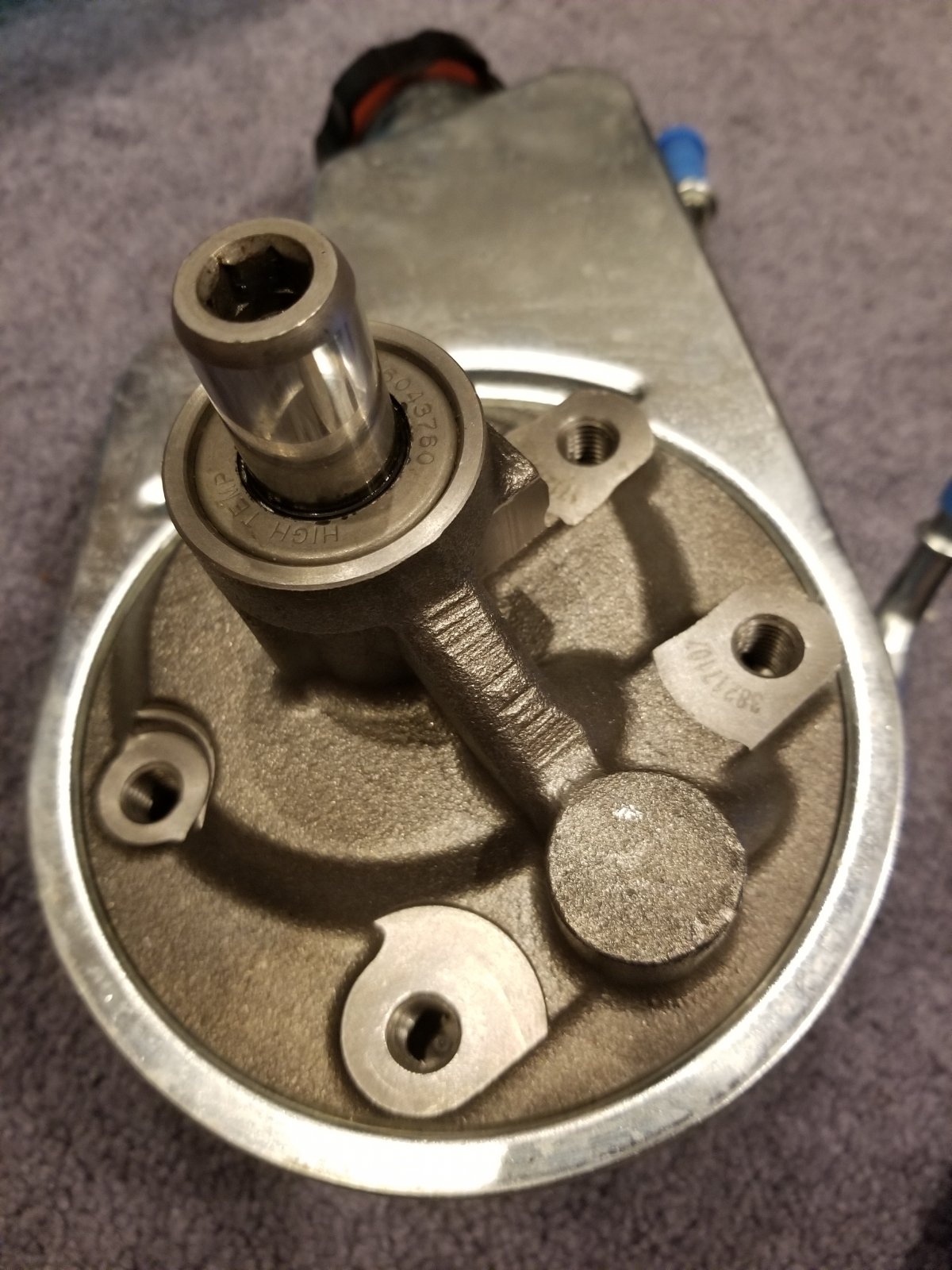

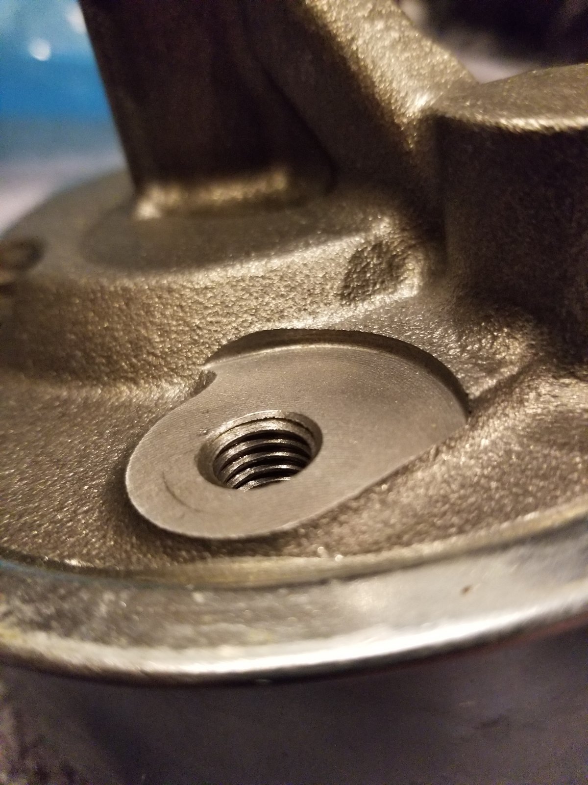

Just got a replacement OE GM pump. I think i may have found the issue. Take a look at the following pics. It shows a recessed machined area where the bracket meets the pump. I think this is the problem I am facing. I will have to investigate a bit further on this but it could end up being the cause of many peoples problems involving pump noise and immediate failure after replacement.
