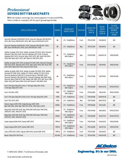

My preference is GM OE brakes. They maintain shortest stopping distance and last a long time. We get 85K plus miles out of OE pads.
Now having said that, we did buy ACDelco Performance towing brakes for our lifted Sierra and will be putting them on very soon.
ACDelco Professional Towing Severe Duty Brake Parts (1)_Page_1.jpgACDelco Professional Towing Severe Duty Brake Parts (1)_Page_2.jpg
