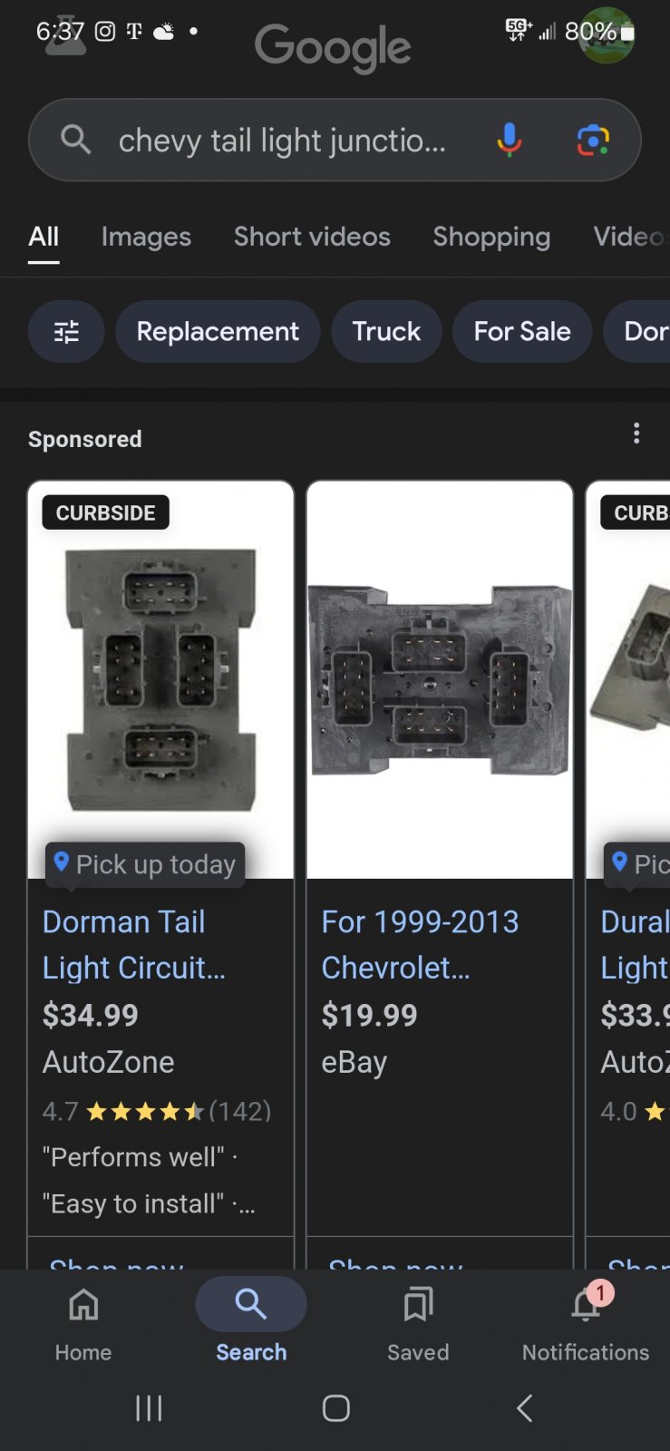

I ended up running my own wires from the brake light switch to the fuse that feeds them. One from the fuse thats supposed to go to the switch and then one from the switch to the fuse that goes to the brake lights. But your model I believe has a board on the frame near the back thats like a conjunction panel that everything plugs into, might wanna check there. Mine did not have that. Use a probe to check for power from the switch on the brake pedal to make sure power is leaving from it. And if so then check that junction panel.
Should look like this photo I attached
