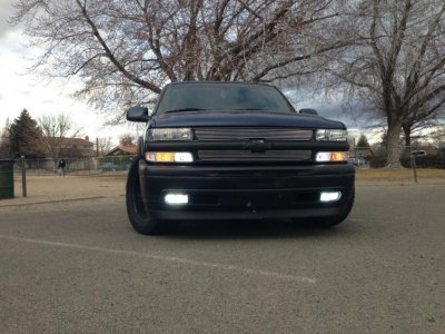

Hey so what exactly needs to be done so I can put the HD front end on mine if u can please explain. Or point me in the right direction.ImageUploadedByTapatalk1362703884.605823.jpg

to do the HD conversion you will need 4 pieces..an HD hood, grille, and the upper bumper cap and the chevy bowtie for the grille..now for the grille to fit right you will need to cut the bumper mounts and lower then i believe an inch and a half and weld the mounts back on..replace the bumper cap and put the bumper back on, now the bumper will sit at the right height, after that simply directly replace the grille and bolt on the hood..hardest part id say would be removing the stock bumper cap and relocating the bumper mounts
