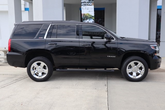

So, I just bought a used 2016 Z71 and I am not a fan of the 20" wheels/tires that are on it and I'm coming to y'all for advice. How do I know if it's been leveled? It seems to have OEM suspension, but I guess after 105k miles it would be hard to tell. I've measured the wheel well heights and they are:
Front Driver:36.25
Front Passenger: 36.5
Rear Driver: 38.25
Rear Passenger: 38.25
It's currently running 275/55R20 and they don't look quite proportionate. I'd like to get a larger tire that looks a little better. I'd really like to find someone to trade with for the original Z71 18" rims - how would you look for someone? If not, what do you think my best move would be tire wise?

It definitely hasn’t been leveled. The rear is higher than the front. My Yukon looks like this. I hate it

yeah, definitely not leveled

Thanks for all of the advice guys. I ended up going with a 2” level which brought it to 39” all the way around and some 275/60/20 highway tires. Love the feel of the extra height and the comfort of the extra sidewall. I’ll post some pictures when I get a chance.
