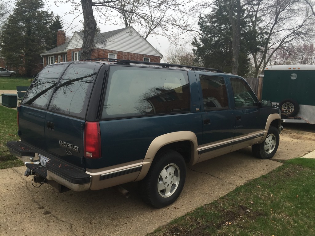

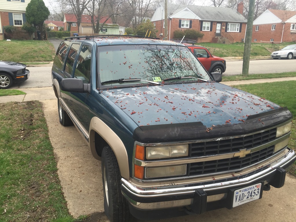

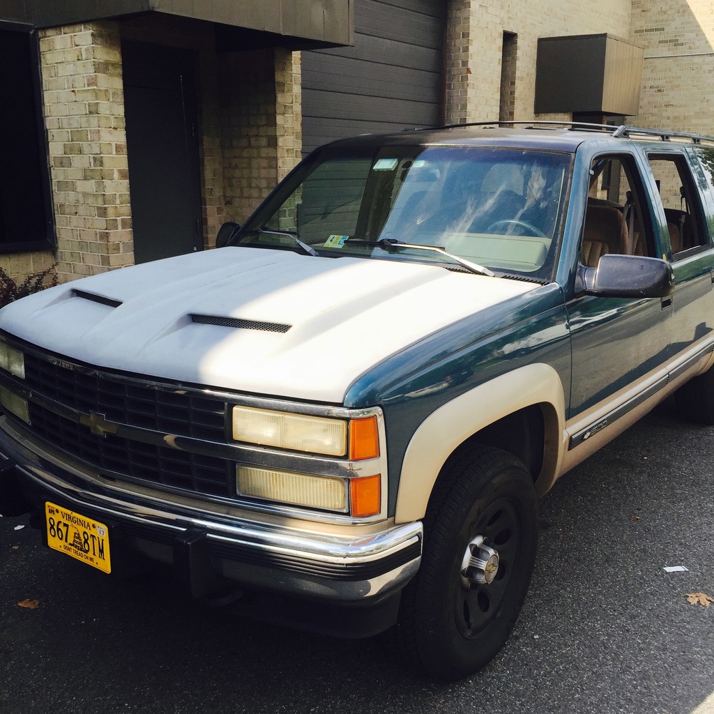

Well after the Yukon was wrecked I had to decide what to do with it and it worked out that after insurance and buying it back from them and then selling it to my boss I lost about $50 so all in all it worked out alright for me lol! So I had a pile of cash and wanted to spend it naturally so I booked a 7 day Caribbean cruise for the Wife and I in October and then picked up a new project/play toy today (well really Friday but I picked it up today)! It's a 93' with only 108k on the clock two owner no accident clean burban. It was owned since 2000 by an older guy that only put 25k on it in 15 years. He didn't drive it the last 3 years due to health and ended up passing away so his wife was selling off some of his many vehicles. Naturally from sitting it needs a few things but nothing major that I can tell so far. The lady put a charger on the battery the night before I was coming and after checking to be sure it had fluids I just wanted to see if it would turn over and to my surprise a quick flick of the key and it started right up! It ran like crap of course but started. So I paid her and we did the paperwork. She was such a sweet old lady I couldn't even bring myself to try and haggle the wopping price of $1400 so that's what I paid for it.
At her house

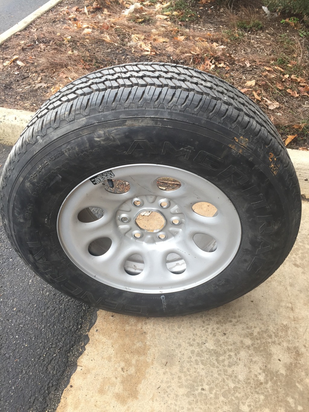

The paint on the hood and roof is crap but the rest of the paint is great. Sadly the tires were like new but completely dry rotted from sitting for so long so it needed tires. Naturally I searched craigslist and then remembered the guy I got my 14 bolt from had some wheels I was considering buying from him for the Yukon so I called him and he showed up about 2 hours later not with the wheels I had wanted but with a set none the less! Not my first choice of wheels but they are all brand new including lug nuts and center caps. He said $200 for all four and I said sold!

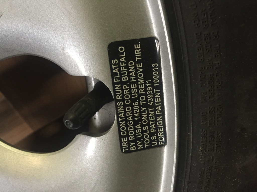

While unloading them I couldn't figure out why they were so damn heavy and then found this little sticker:)
Turns out they have run flat inserts installed and came from a fully armored van that was parted out!

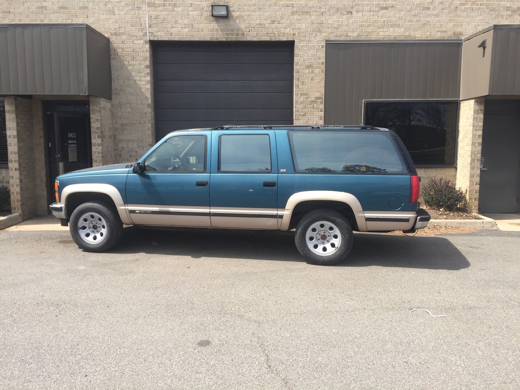

Went today to pick it up and brought it back to my shop to start messing around. So far I've done cap, rotor, plugs, wires oil change, pcv, and a sea foam. It runs good at idle but under load it's bogging and stumbling most of the time. I'm pretty certain I have a few vacuum leaks so I picked up all the lines and fittings on my way home tonight and I'll swap everything tomorrow and see how that turns out. But for now here it is back at my shop with the new tires on.
Still have to put the center caps on and give it a bath yet. Sorry for the ridiculously long post!

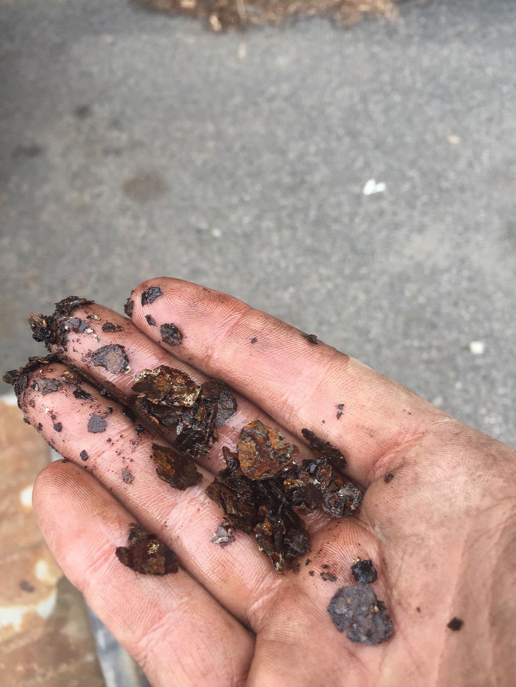

Rained yesterday so I didn't touch it but it was nice today so I spent a bit of time messing with it. I replaced the vacuum lines and fittings and then decided I should finally change the fuel filter since I bought it but didn't change it and now I wish I would have done it sooner cause as soon as I pulled it rusty gas just poured out and I knew immediately the tank was crap:( sure enough I dropped the tank and even tho the pump and filter were new as of last June the tank was rusted out inside and clogging up the pump and filter. So rather than even messing with trying to clean this tank I just went ahead and ordered a new one that should be here Monday or Tuesday. In the mean time I decided to rip apart the tbi and rebuild/new gasket it just for good measure:). I'm %99.9 percent positive that it will be ready to go as soon as I get the new tank in next week!
Hand fulls of this in the tank!

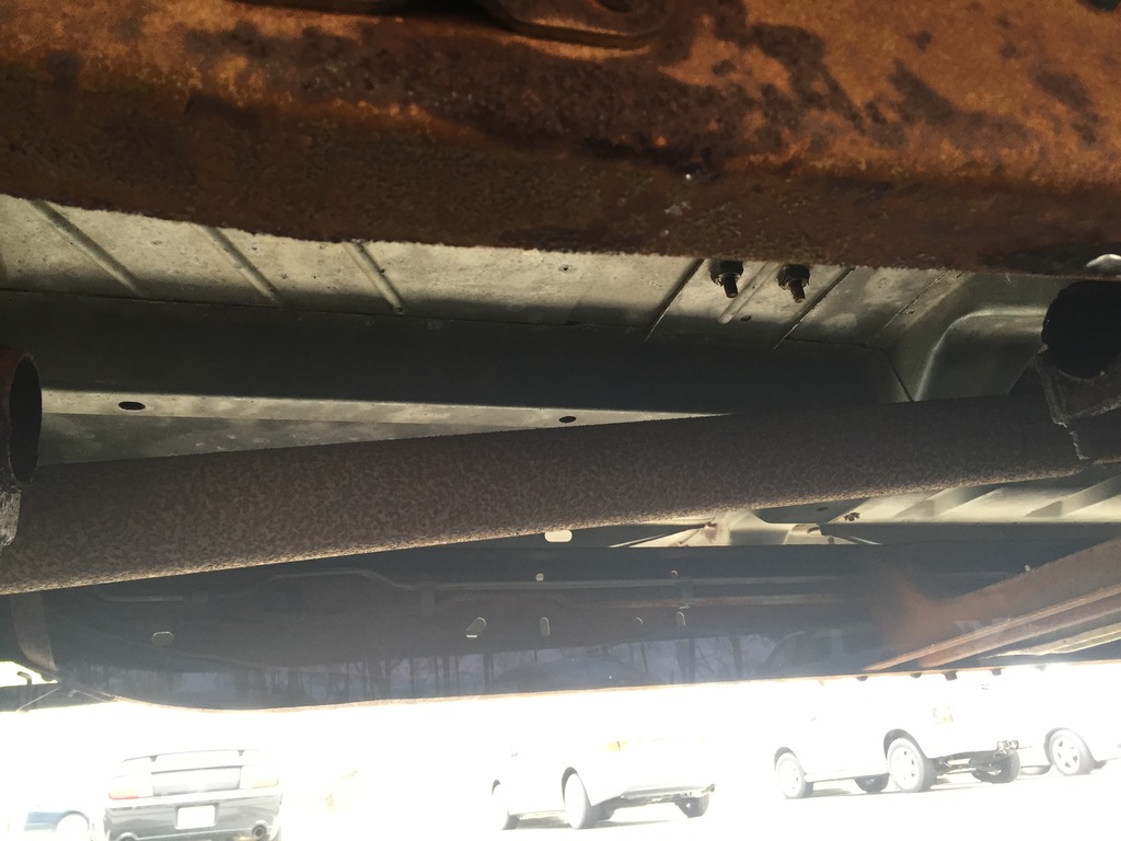

Thanks guys! Got the gas tank from ups nice and early this am and had the truck up and running about 45 minutes later. It runs prefect now that it is getting steady fuel! After driving around the parking lot and a short trip to the gas station I felt it was ready for a solid road test so I drive it about 50 miles without a hiccup... Well there was one minor hiccup lol can you spot what's missing?
Yup about 4 miles from the shop it got louder and then I looked in the rearview to see the muffler bouncing down the road behind me lol! I knew it was going to need exhaust just didn't figure it would be this soon. So I jumped online and looked for some exhaust and ended up with a Dynomax full stainless cat back system that should be here in a day or two. Later on I'll probably add headers and a new y pipe with high flow cat so this will easily adapt to that and at $130.56 shipped to my door for the full kit I couldn't really do any better! Gotta love online discount codes!

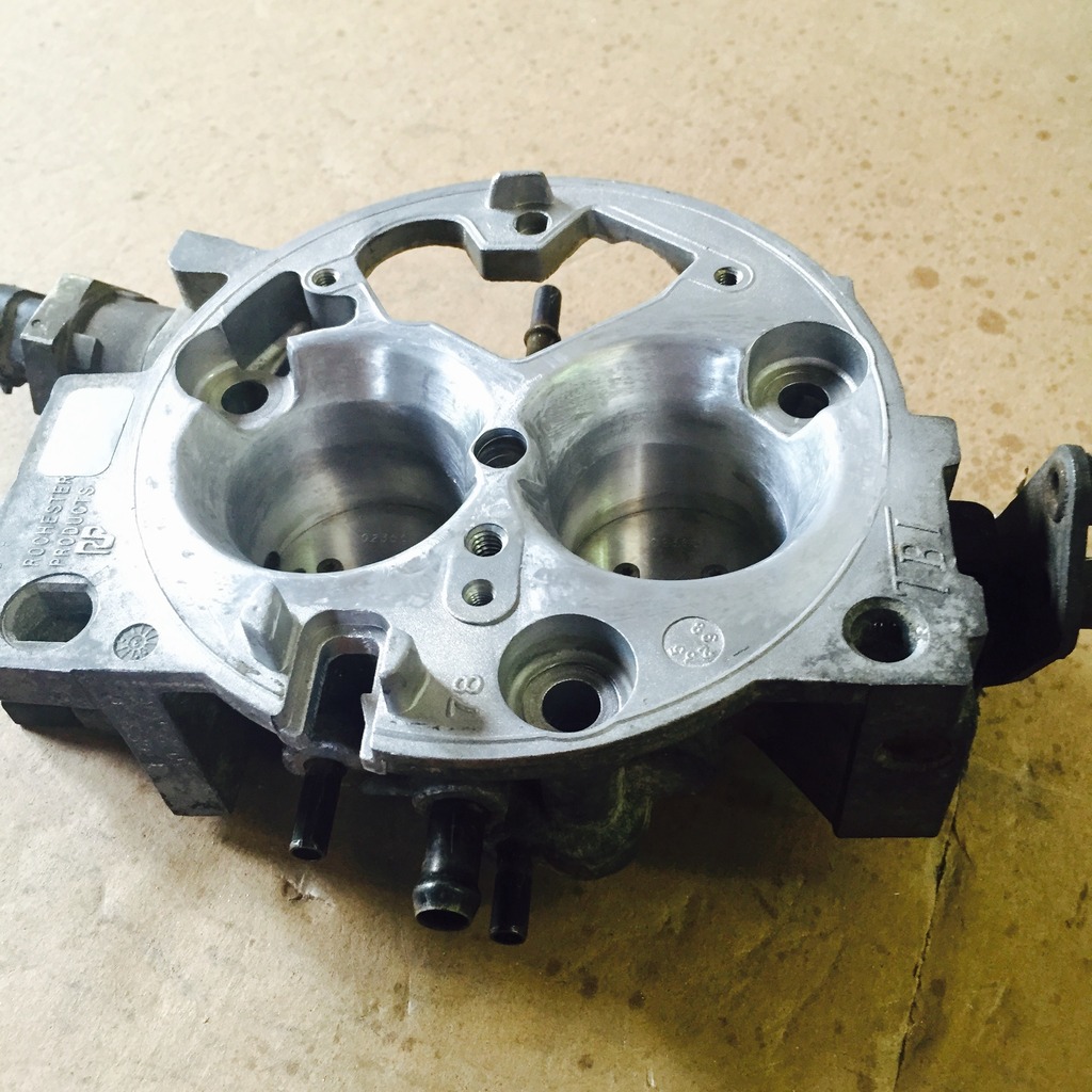

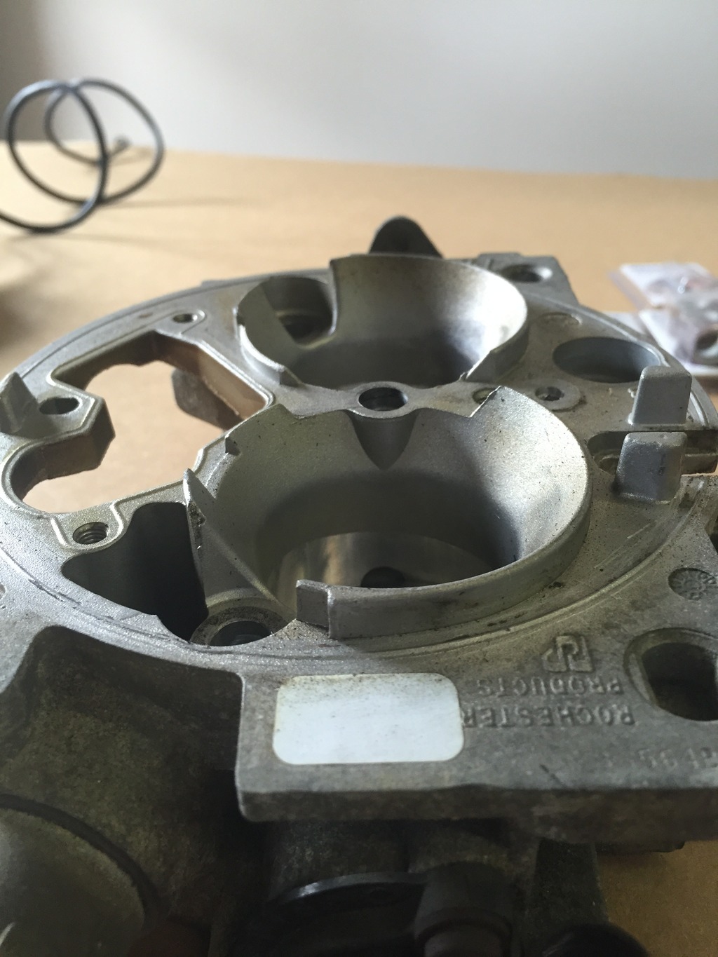

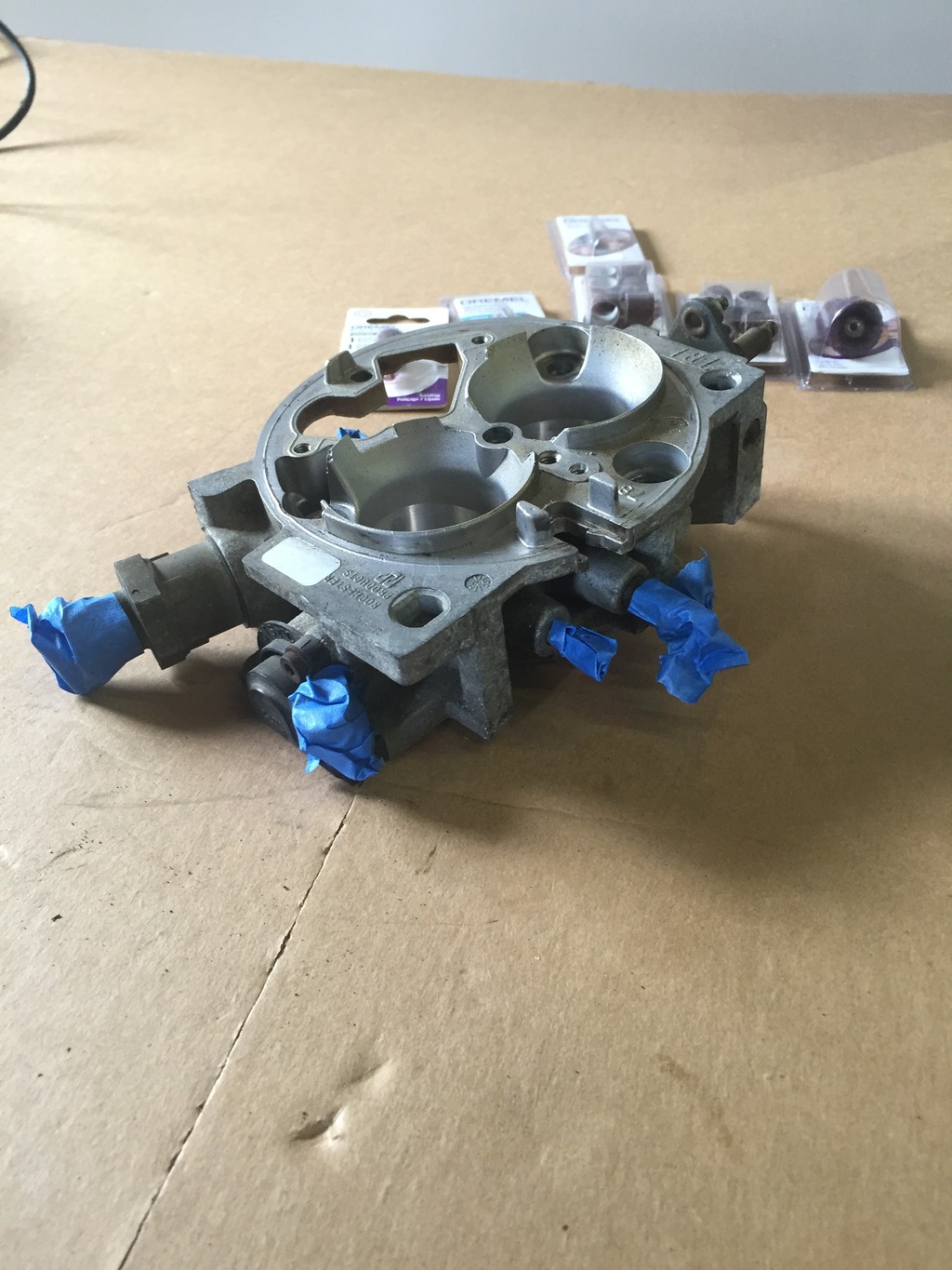

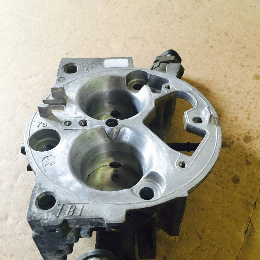

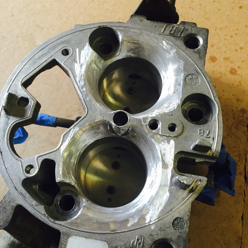

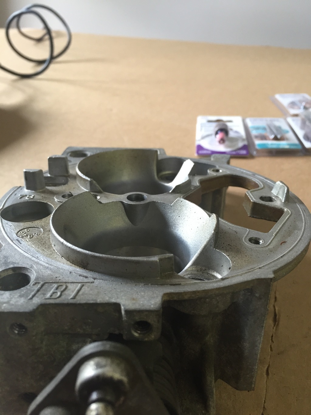

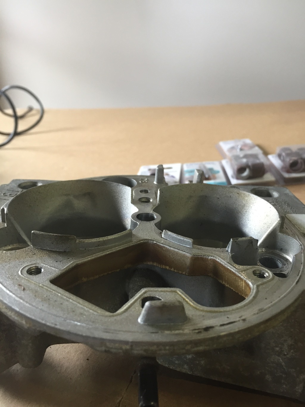

I've been doing a lot of reading regarding the TBI and upgrades for it so I figured it was time to start with a couple of them. I started with removing the ridges around the bores and opening them up a bit. I will also order a injector pod riser and TBI spacer in a day or two but for now heres some pics!
Before: For anyone not familiar with these you can pretty clearly see how restricting the ridges are to air getting into the intake.

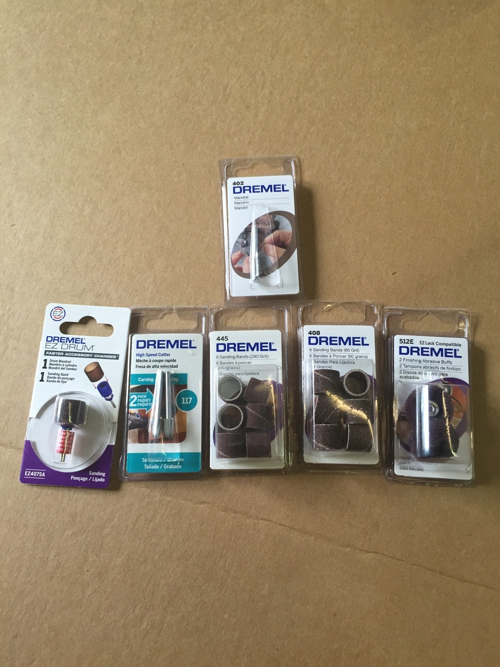

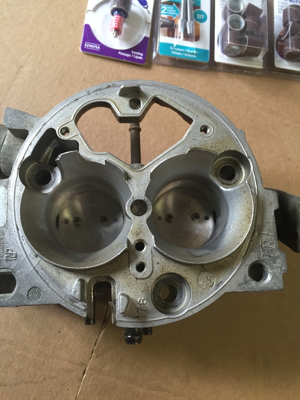

Prepping for grinding!
These are the tools I chose to use obviously attached to a Dremel

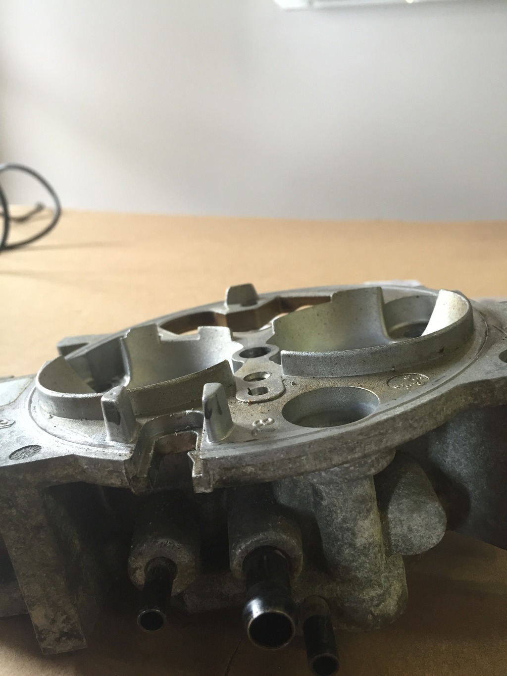

Ridges roughly removed. The cutting bit made quick easy work of these.
After a bit of work with a sanding roll.

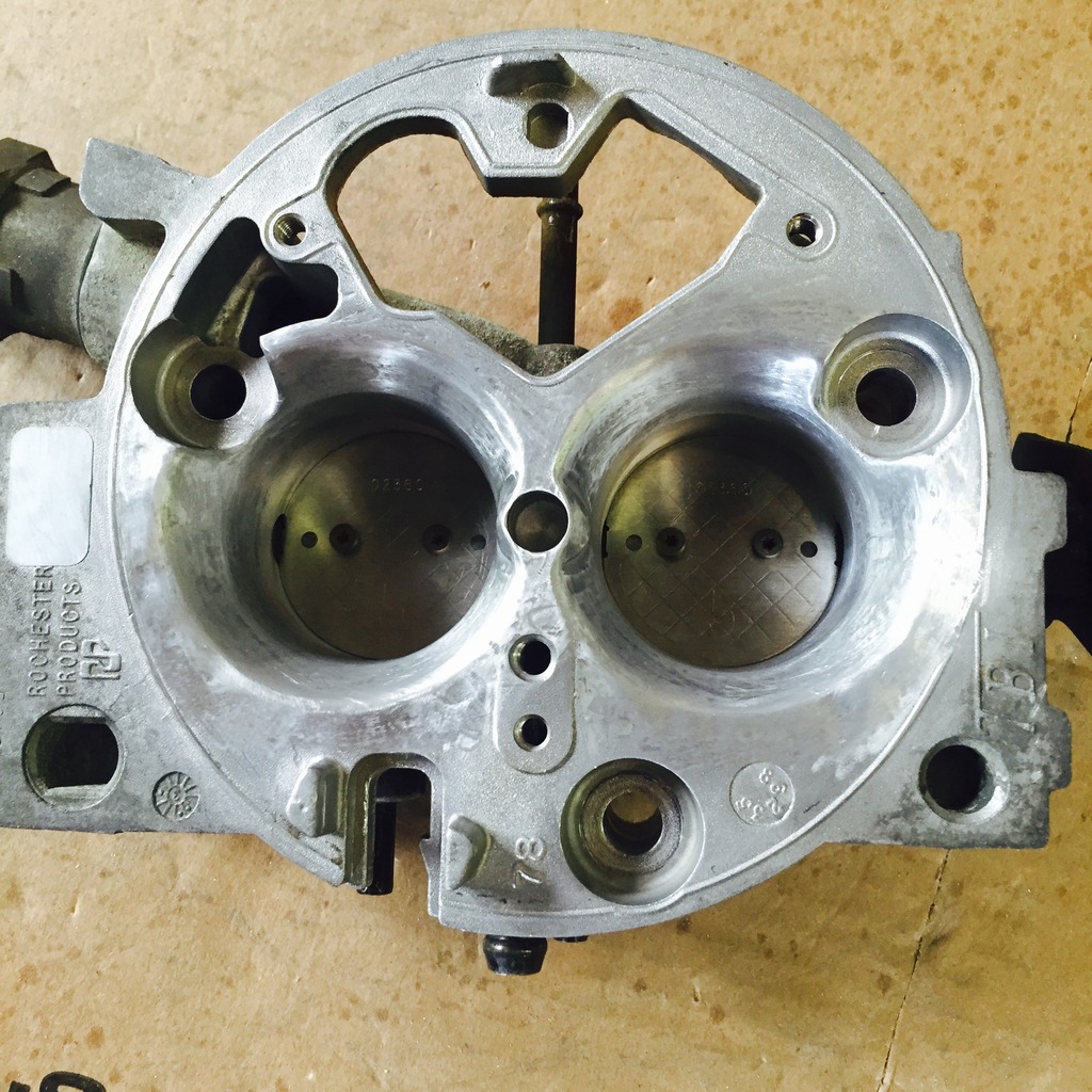

And then finally the finished product. I messed up a bit on one of the raised spots that surround the entire TBI but I don't think that it will cause me any issues since there is a gasket there anyway

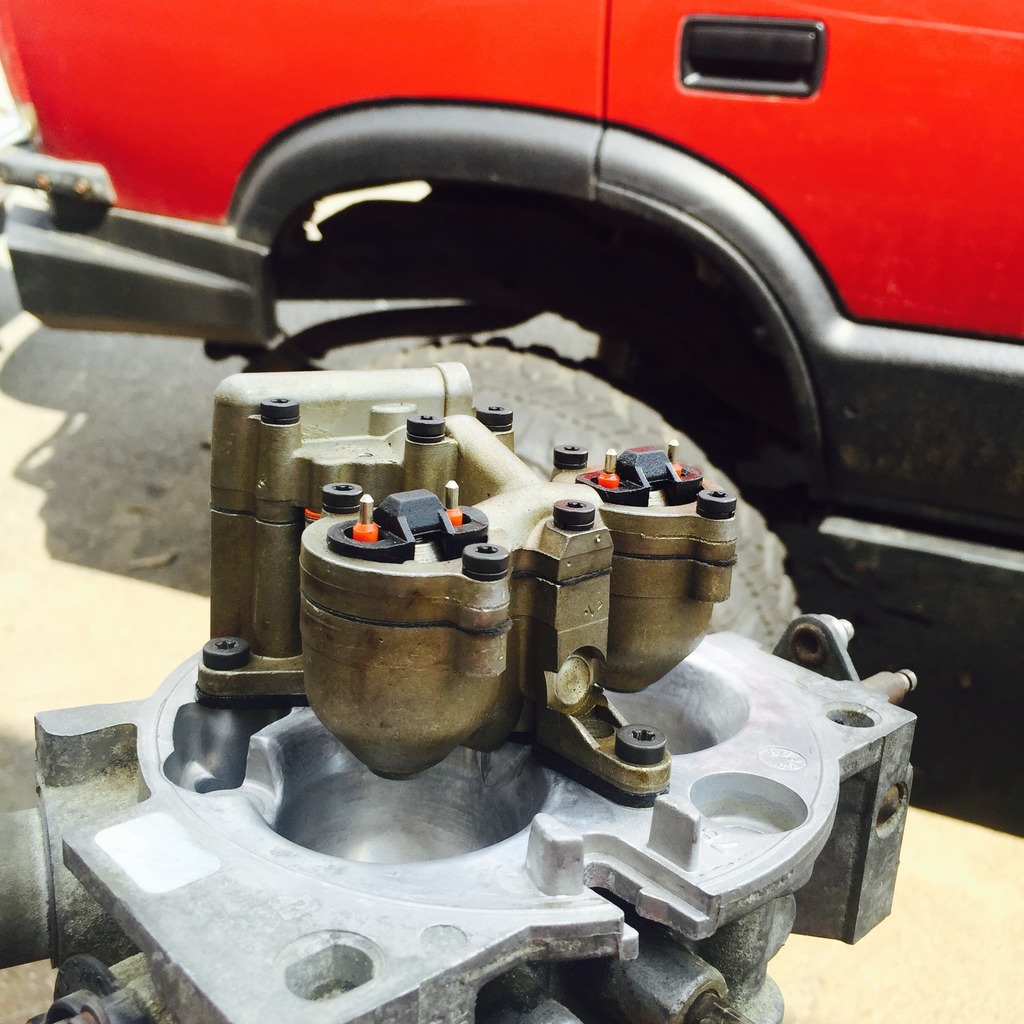

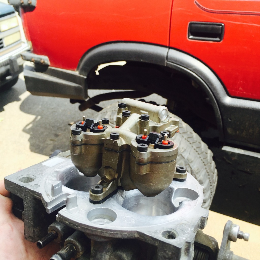

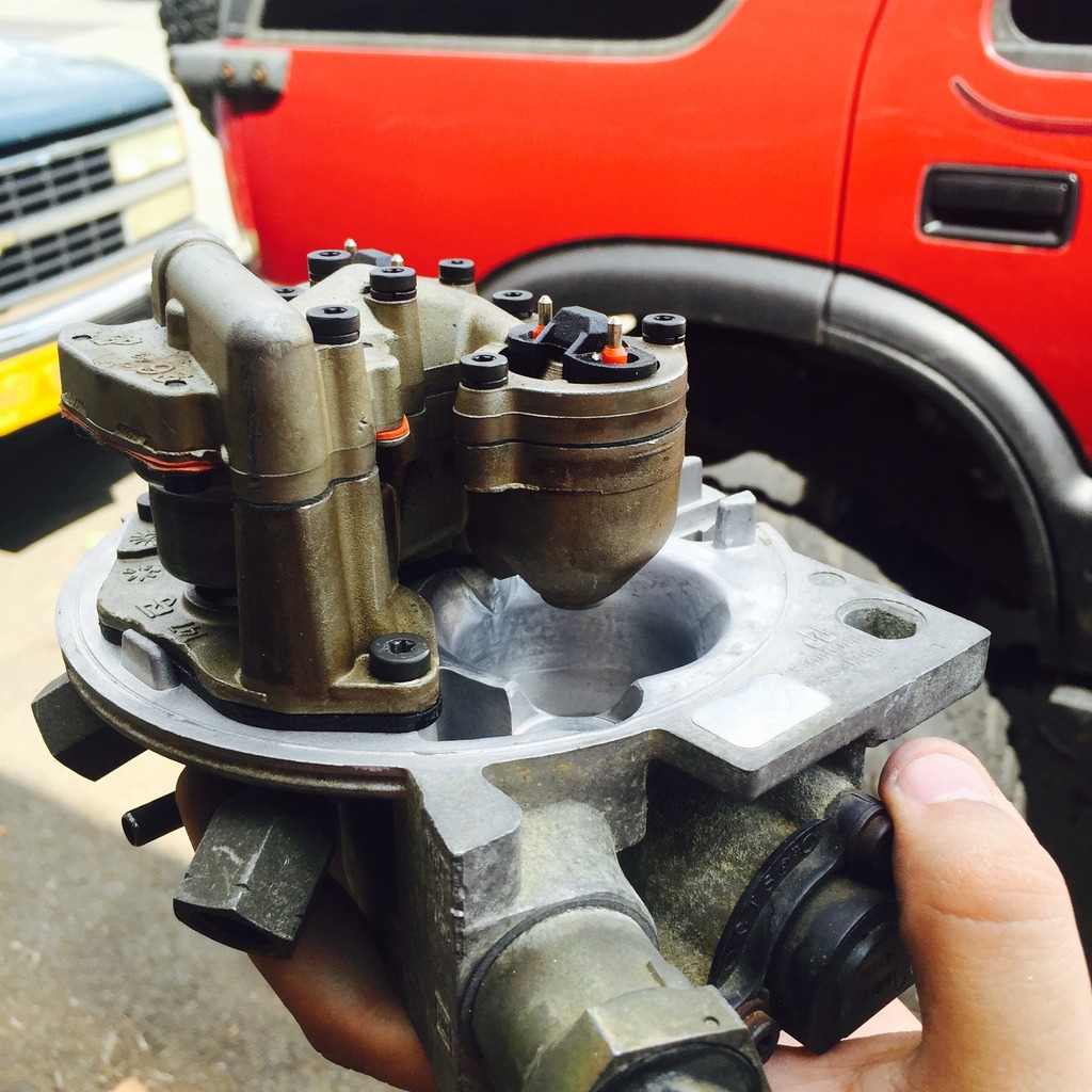

I wish I had remembered to get a pic with the injector pods on before but here is after.

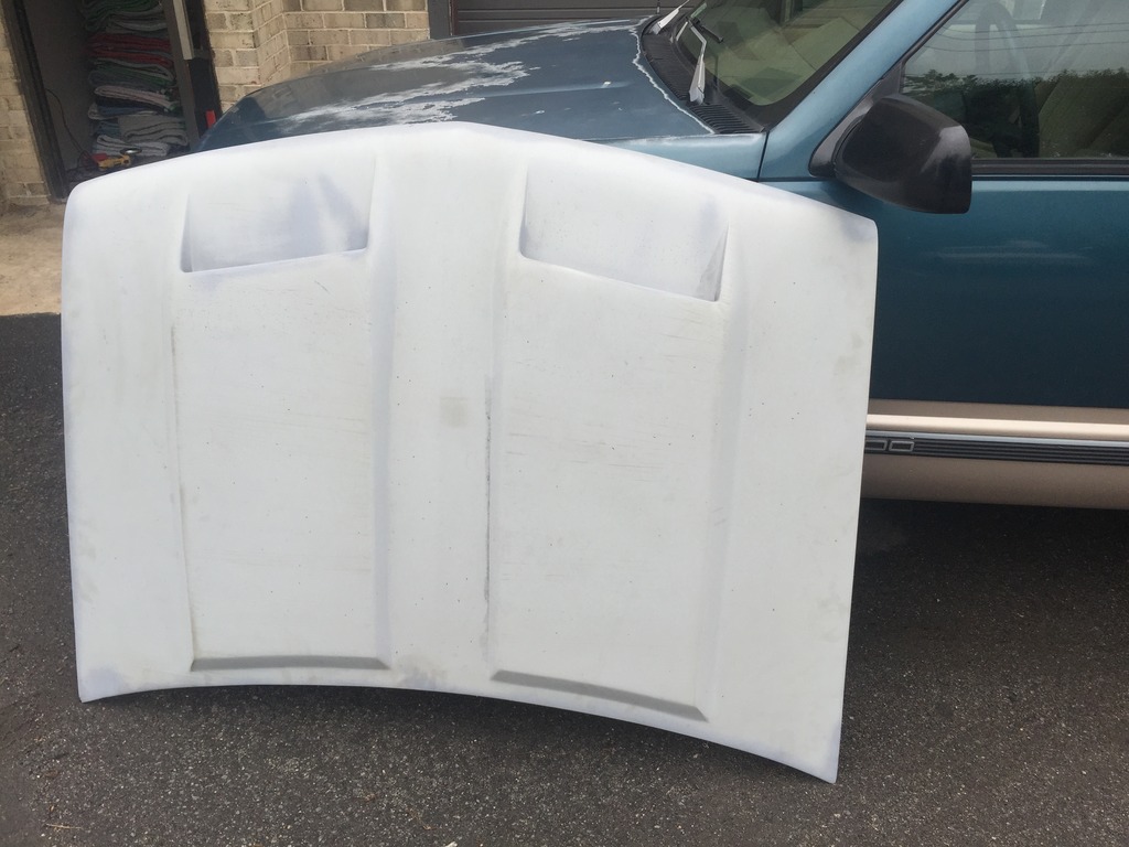

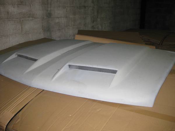

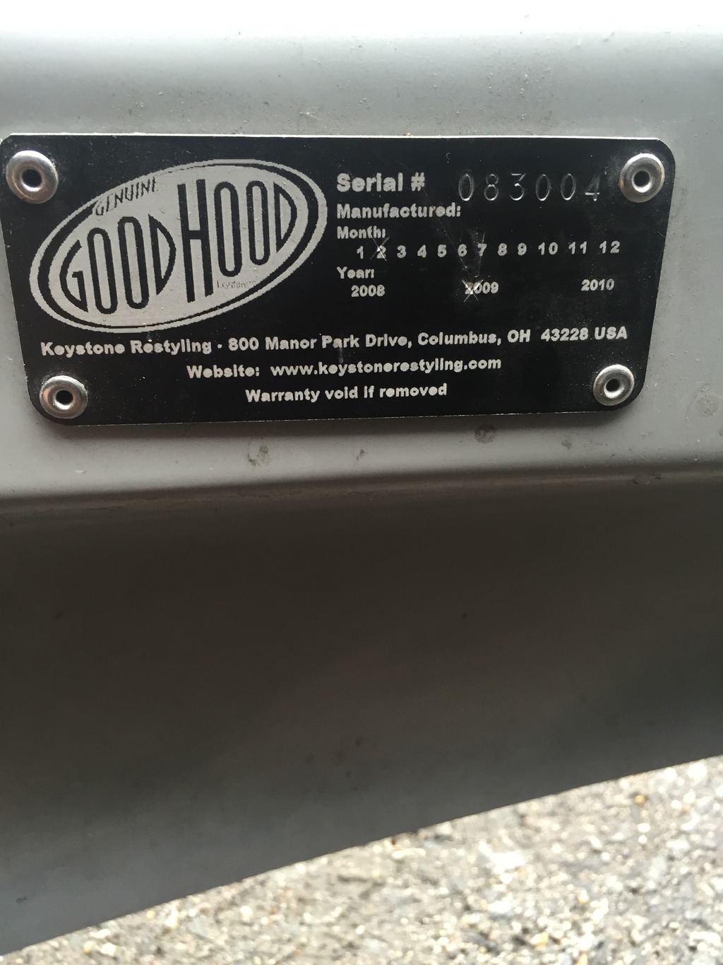

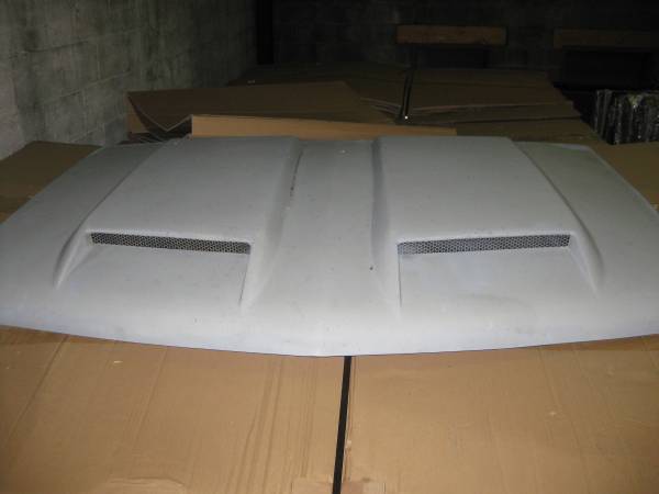

Up next I will be installing by new hood and building a box to make the ram air "functional" along with a new intake hat.

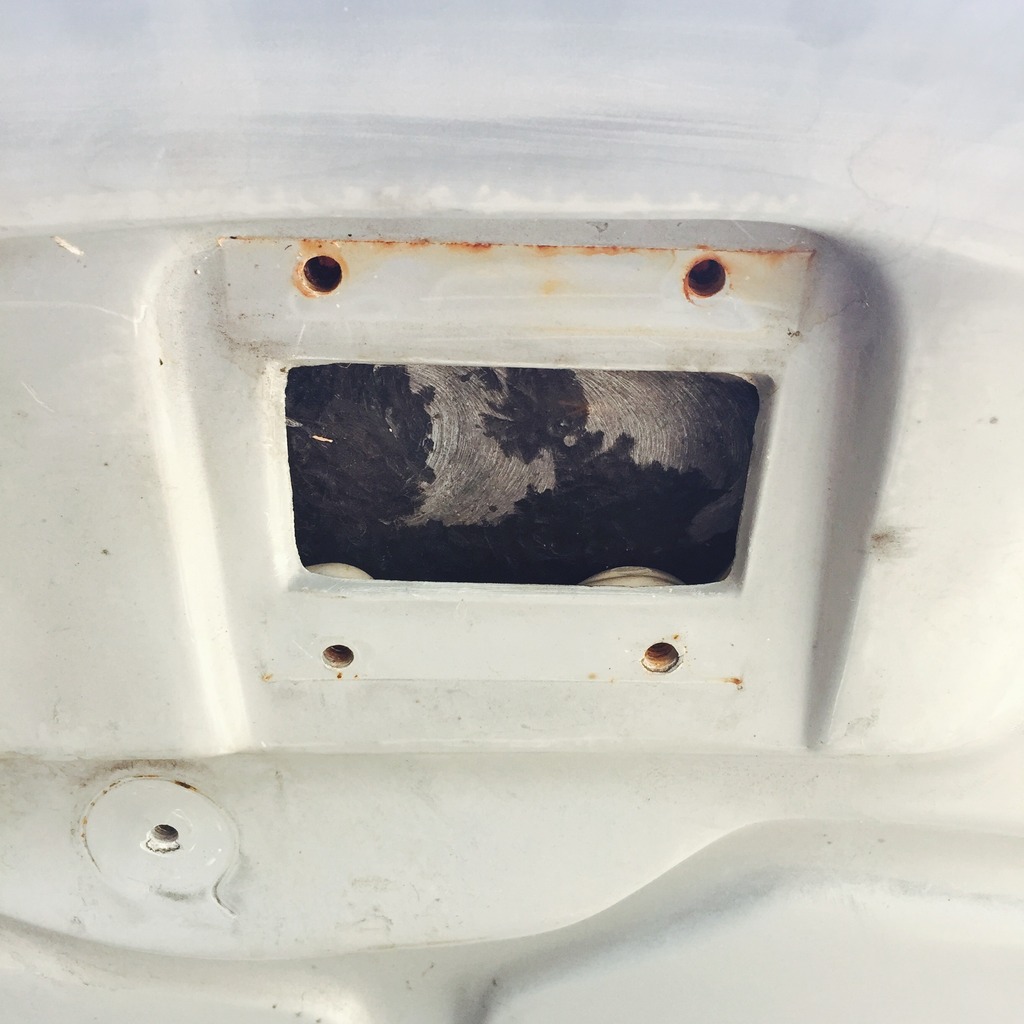

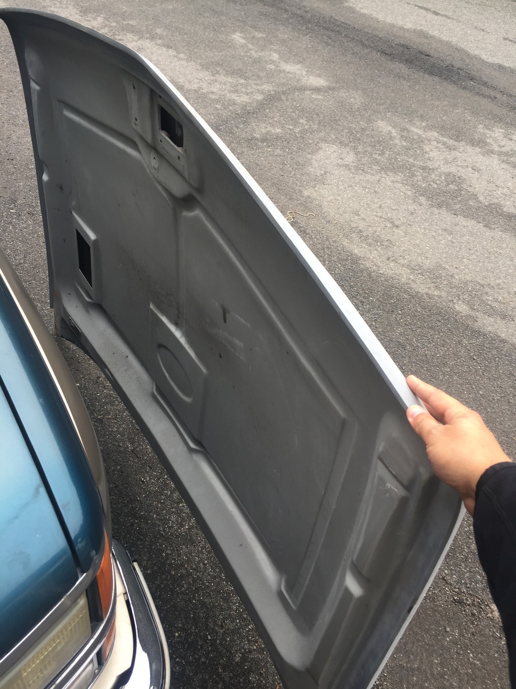

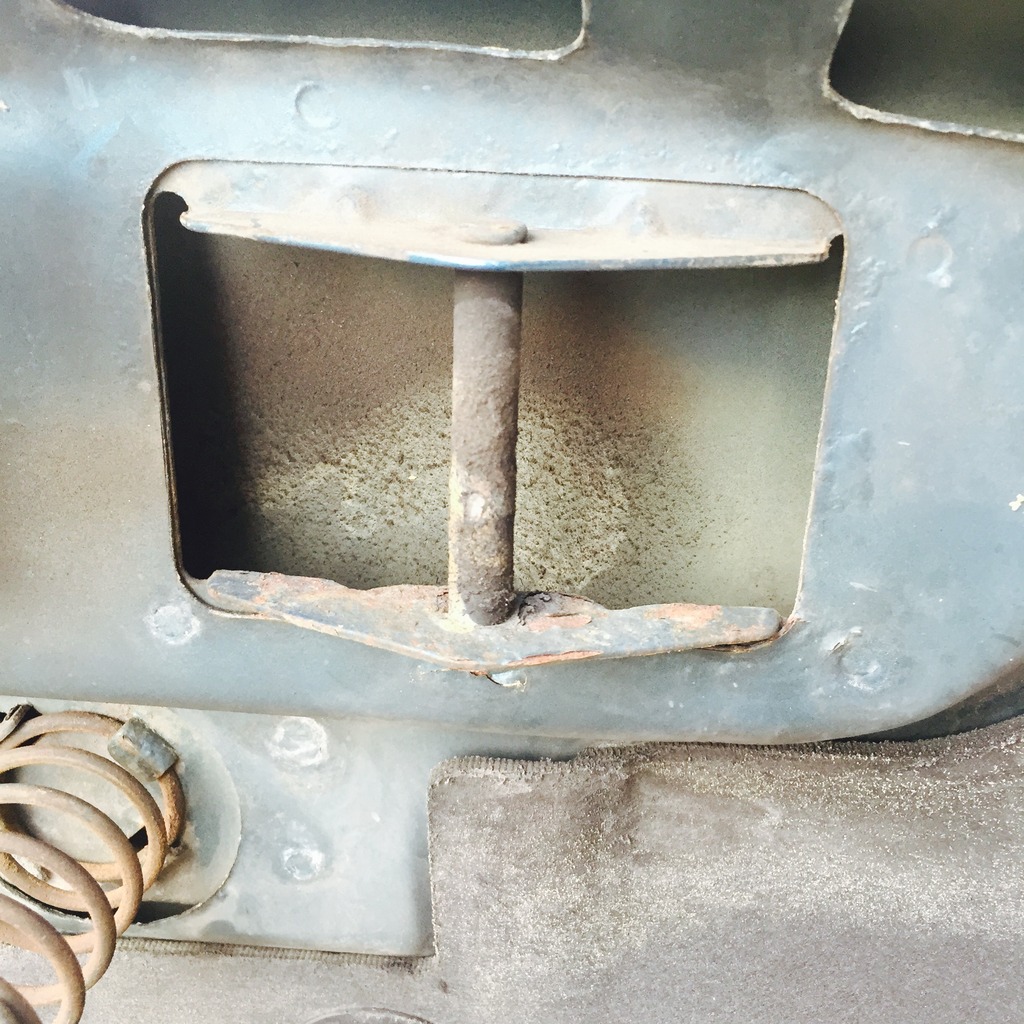

I test fit the hood today to see where things landed and was going to leave it on but found that I need to buy a bolt on latch for the hood side as the factory hood is welded on and the fiberglass is not:(
And the part I need
That's all for today!!

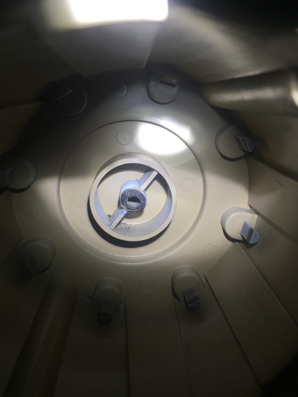

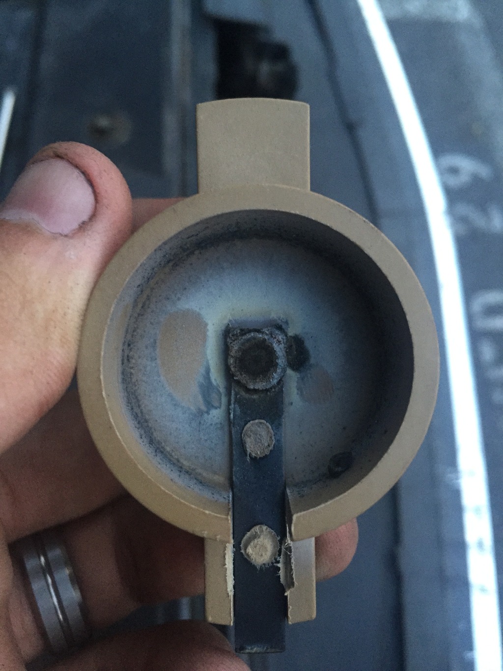

First thing I did was try fuel in the tb and no change so it's a spark issue. Checked all connections everything is good so I pulled the cap and the button on the cap is gone fried right off and the rotor looks like crap!! I kept going down the list and found that the pickup coil was shot so I replaced the entire dizzy and all is well now.
The spot on the left is just from my finger
And the inside of the cap
