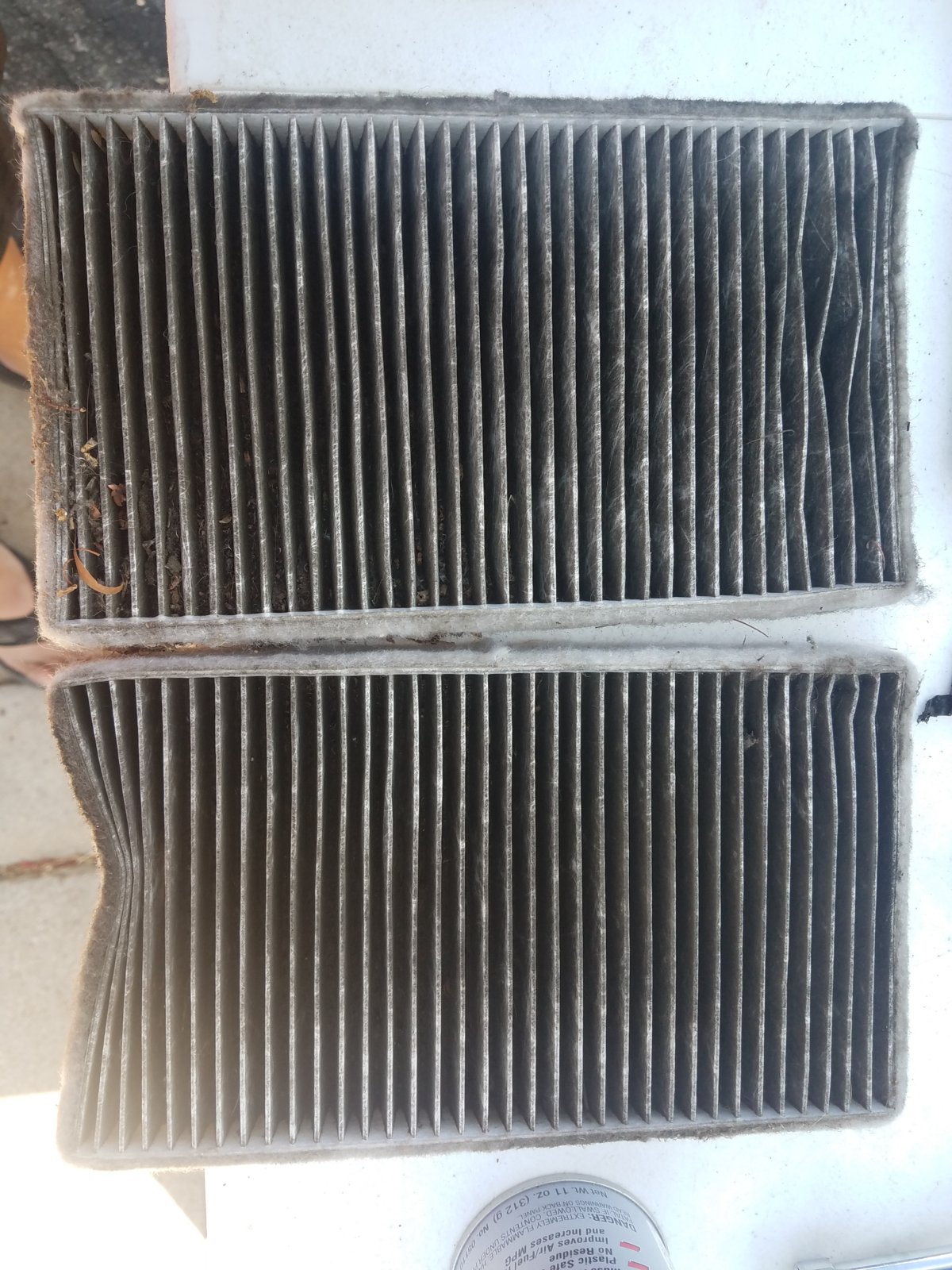

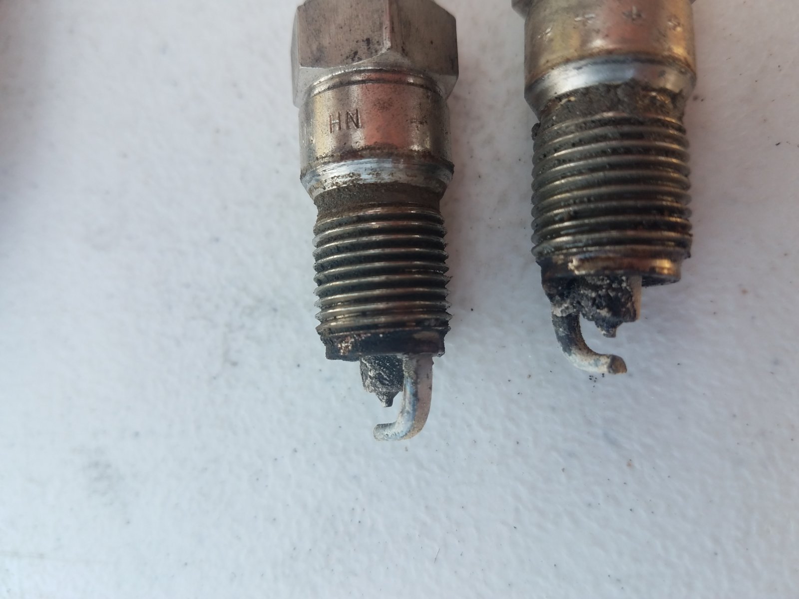

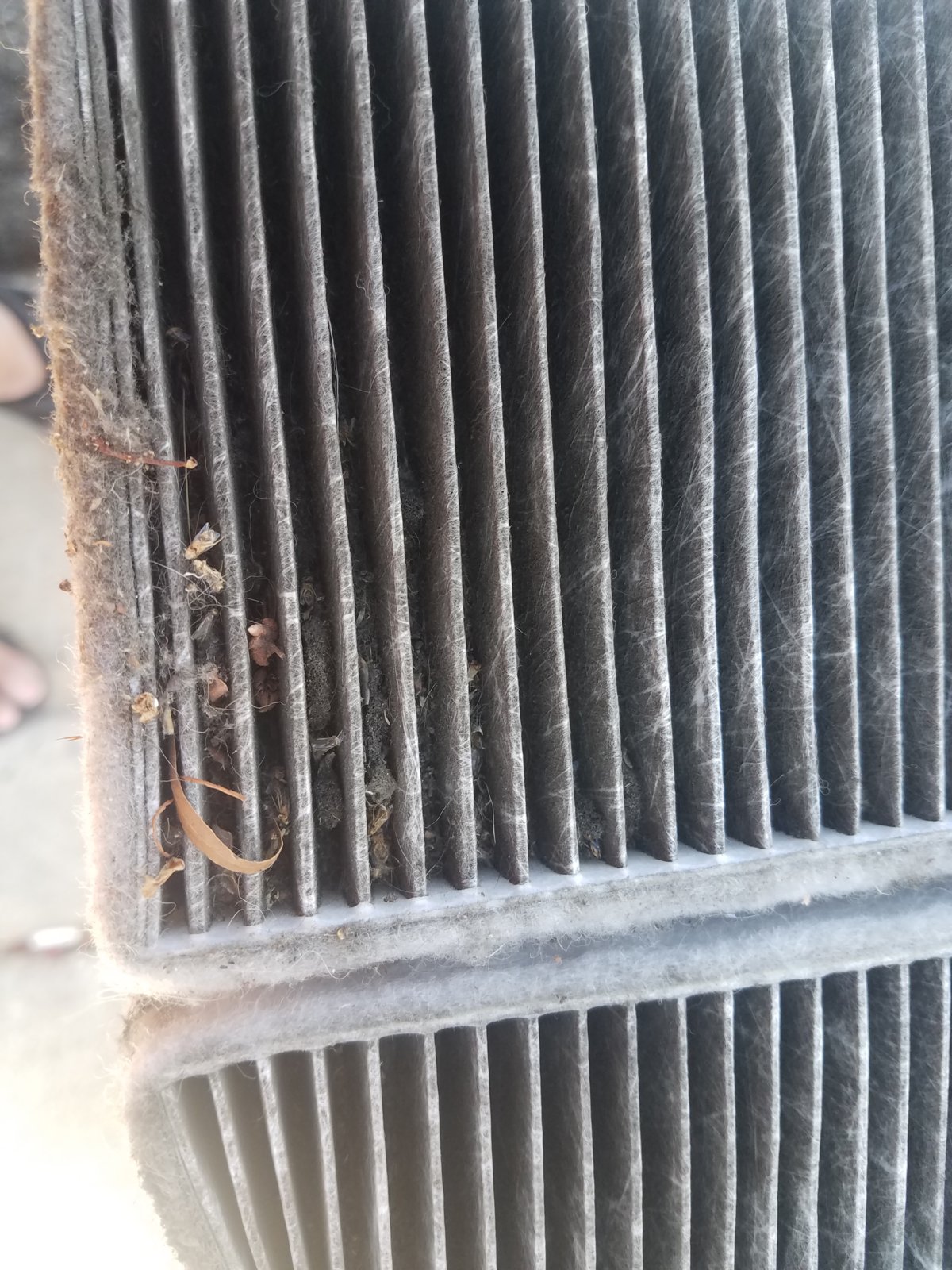

Success! Misfiring is gone. 2 of my rear passenger plugs looked real bad. Anyways, replaced 8 plugs, new spark plug wires, new air filter and even my 2 cabin air filter (which were original to the Yukon, yuck). Gave the MAF a nice cleaning as well as the Throttle Body.
She now runs super smooth all the way up to freeway speeds.
