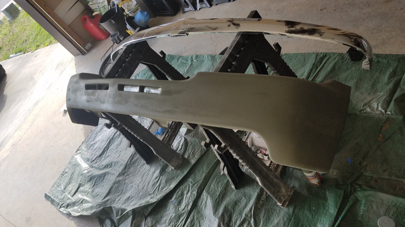

Second coat down. First one worked out perfectly so here's where I screw this up lol

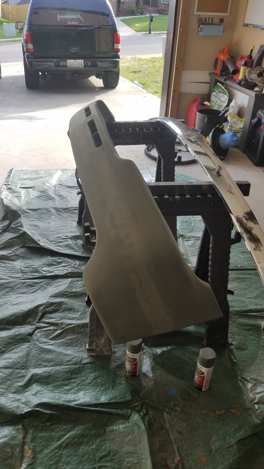

Of all things that I probably shouldn't use... Bondo. Tried the "gold class" stuff this time and it's really easy to work with.
But the first batch went on and stuck really well with the metal and plastic with how i prepped each surface.

Well now I gotta ask how you prepped?!

80 grit sand paper on both surfaces. went through the chrome on the metal and roughed the plastic up really good

I will say though, I'm not a body guy. This has the likelihood to be something I regret lol

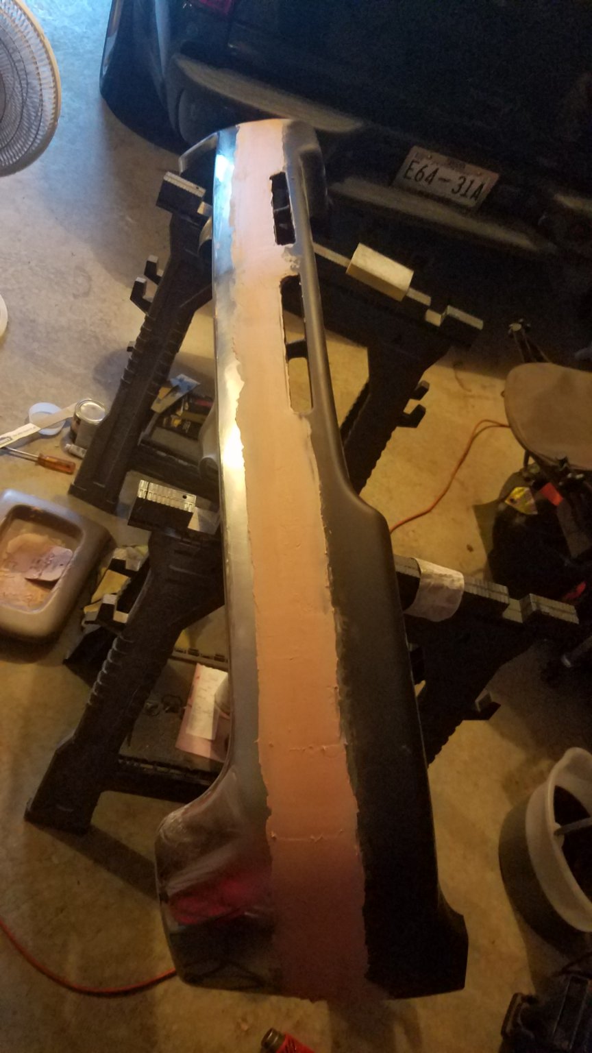

I thought you were making a mold for fiberglass.
You plan on sanding smooth and painting over that what you have now ?
that's the plan.

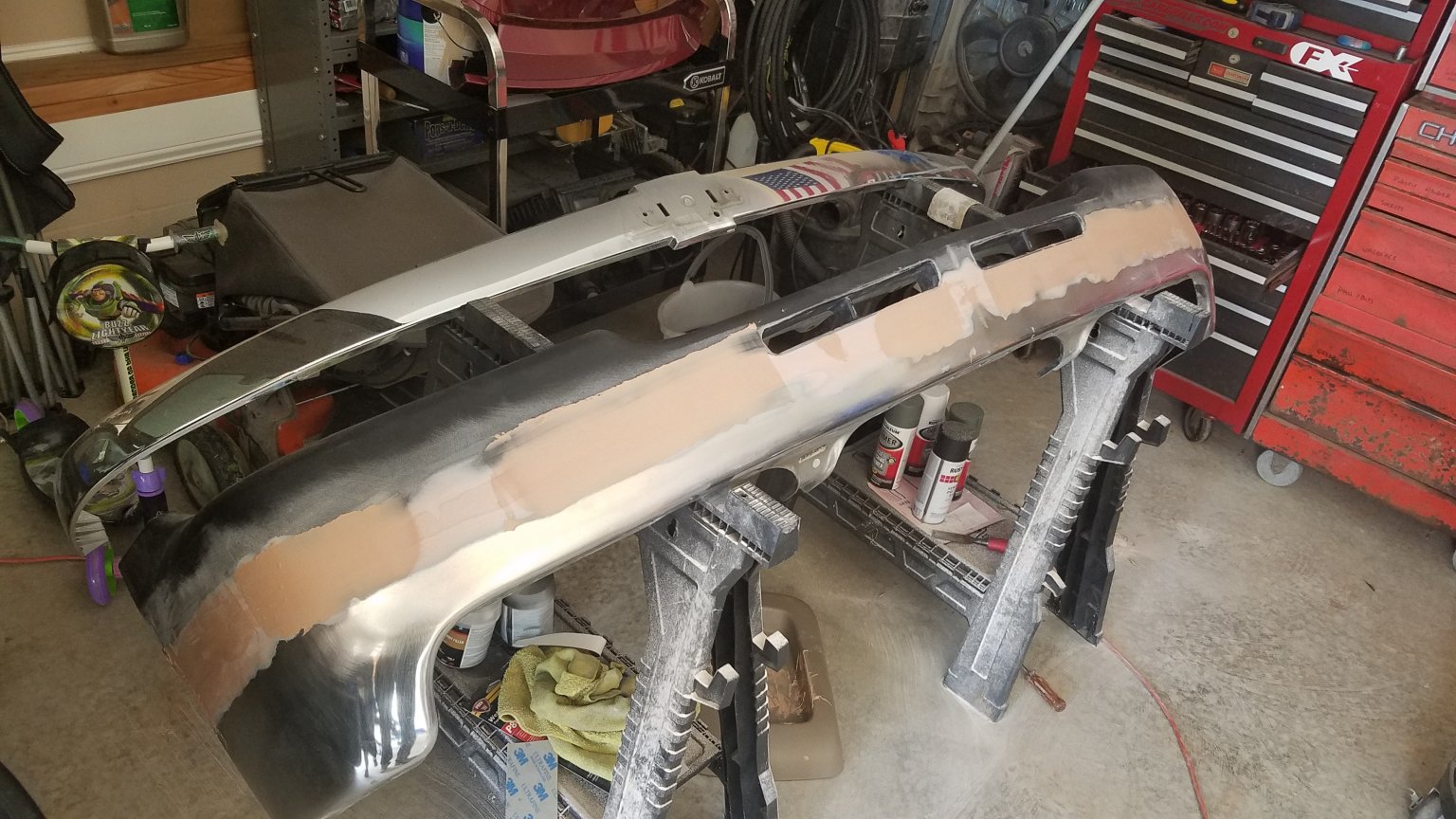

Final coat of bondo to fill the low spots and then I'll sand it smooth. Then it should be ready for primer.
Also fixed some cracks in the crossbar.

Damn, I really don't see that bondo holding up. I think it will crack and split on the seam. Too much movement between the pad and bumper. :shrug:
But still excited to see the outcome. :popcorn:
Got me thinking I wanna do the same , but like I said with fiberglass.:hmm:

I don't see how there's any movement on the front edge honestly. Tried to force it with my hands and didn't get anywhere with it, but we will see.

Have to fix some cracks but they're in places that have a lot of stress applied to it when flexing. I honestly think I'm just going to need to get a new cross bar. Or cut the center out of this but that opens another can of worms.
