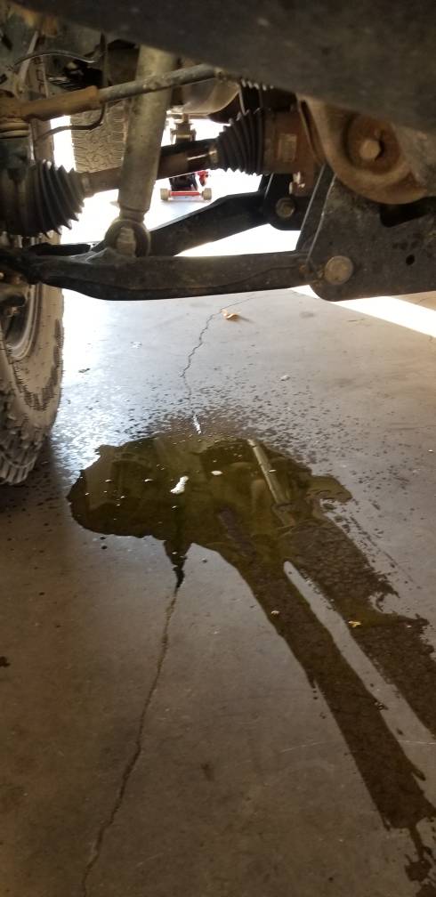

I am heading to Arizona for a month this weekend so I took the rig in to rotate and balance tires. I was also replacing the spare with a new tire since they only had 4 tires in stock when I switched to the 35's.
The shock started leaking after they jacked it up to rotate the tires. It is a Rancho RS7000 strut and it decided to blow a seal. I guess it is better for it to blow now instead of on a trail or in the middle of nowhere. I guess it is time for an up grade...
I think I will be replacing it with a set of Fox shocks so I can correct my ride height since the fox shocks are adjustable too. But, finding someone here to do an alignment before Sunday most likely will be impossible and I have no clue who I can trust for a good alignment in the Phoenix area...

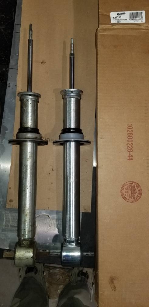

I ended up sticking another Rancho 7000 in there for the time being. After pulling the old shock out it measured 1.78 inches longer than the new shock is.....
The most likely reason for this is when Folbeck 4 wd installed the shock they used an impact wrench to tighten the shock nut and damaged the inside of the shock. It was just a matter of time before the shock came apart internally allowing it to over extend and blow the seal when the truck was lifted up.
So I finished swapping out the shock and made sure it was done right this time... I wonder now if and when the other side will self destruct in the future...
