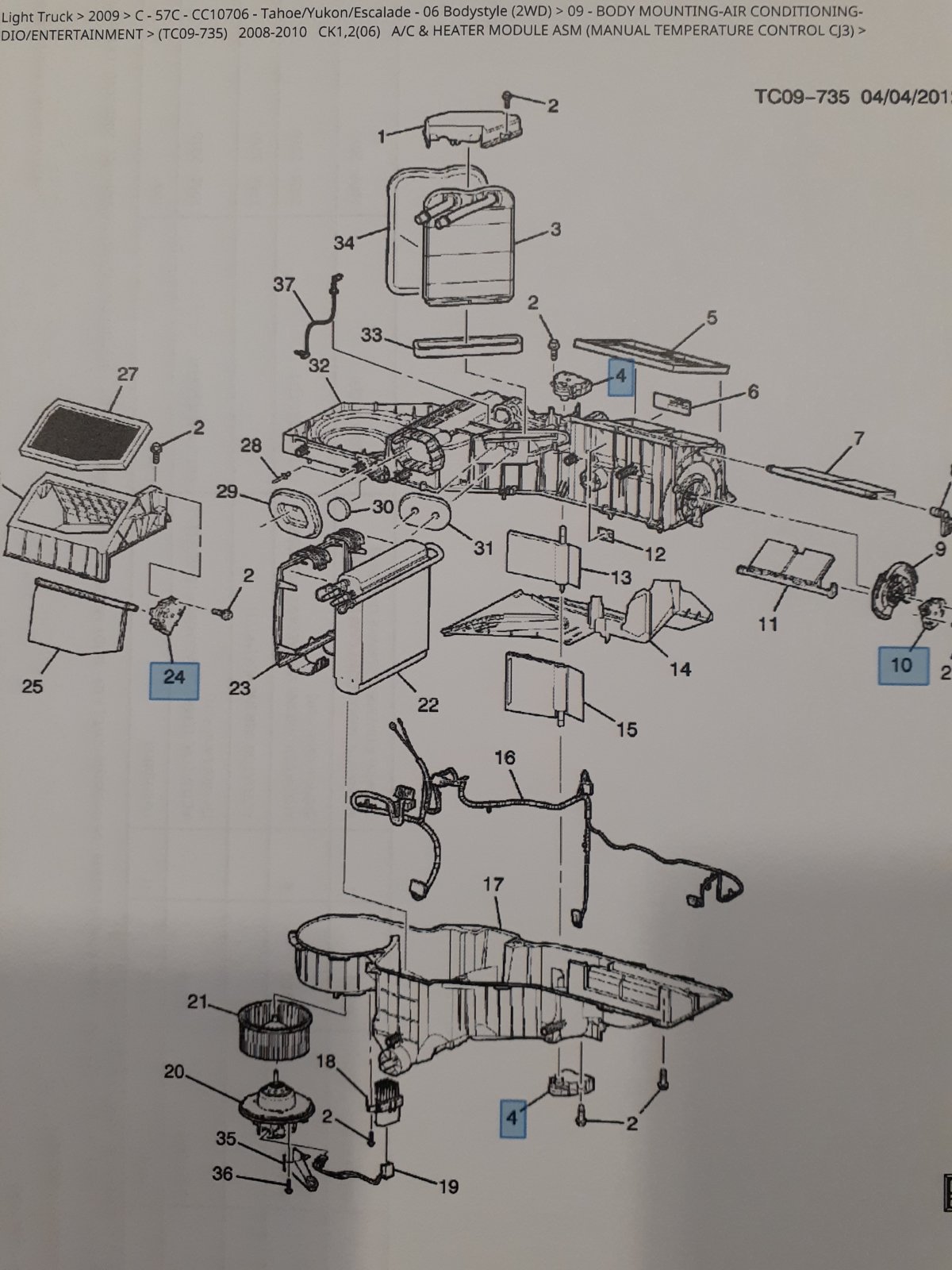

I’ve searched this over and over. On my 2009 Tahoe PPV
My passenger side controls will not change from cold to hot. I’ve replaced the blend door on the passenger side by the feet but that seems to control the driver side which has always worked well.
I understand there is a second one behind the radio? Can anyone pinpoint that down a little before I pull the dash apart today?

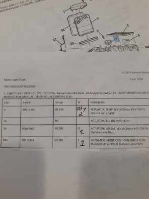

Here you go

I am dealing with this issue as well and has been frustrating. I replaced the blend door on the passenger side under the kick panel because my passenger side was occasionally blowing hot while on AC. I replaced it and now passenger is cold and driver is warm all the time when on AC. Also replaced the mode door actuator (probably didn’t have to) and no change. It seems there maybe another blend door actuator somewhere under the dash but I havent been able to find instructions and cannot visualize it. Any help would be GREATLY appreciated. I have tried calibrating with GM tec 2 computer and doesnt help
2007 chevy tahoe LTZ with full length console in place. Ready to get this resolved! Thanks in advance.
islandguy85
Sep 26, 2019
11
Update. Realized that I replaced the lower with the wrong part. Fit perfect, looked identical but prong config was different. Also have the airbag pulled (really easy other than being very nervous about handling an airbag) as instructed in the video above in the thread and pulled the two others. All three have same part number and I have 3 aftermarket ones on the way for $19 a piece. Shouldn’t be too difficult to throw them in on Saturday and fingers crossed it resolves the issue.

It's been said on these forums that those aftermarket ones don't last at all. The aftermarket uses 2 part numbers for all 4 while GM has 3 part numbers for the 4.
52,949
Blend doors are such a hassle to install that they are one of the things I will only suggest using OEM for. Especially the recirc one, it’s nearly impossible to get to.
52,949
Just got them in the mail and installed and put the dash back together. All good. Hopefully they will last a while. If not, I can always replace them again and I think I can do them all in under an hour now.
Hopefully you won't need to do the recirc one, to do it by the book you need to pull the entire dash cage out, about 8 hours labor. To do it the way I did (cheating) it's still about 4 hours. Good luck on the other 3 though.

Hello wondering the same. 2001 Tahoe my VIN:1J169758 I guess all of mine are bad, as I'm only getting cold air on high heat and recirculate for front vents, floor vents etc. Anyone have the OEM part #'s for my truck? Thanks all in advance, it's getting very cold here.
915_Tahoe
Your GM Parts Specialist
Jul 1, 2018
1,439
2,164
HELL PASO, TX
GM#52474810 $138.69 TEMP
GM#52473356 $160.34 MODE
GM#89018678 $95.52 AIR
