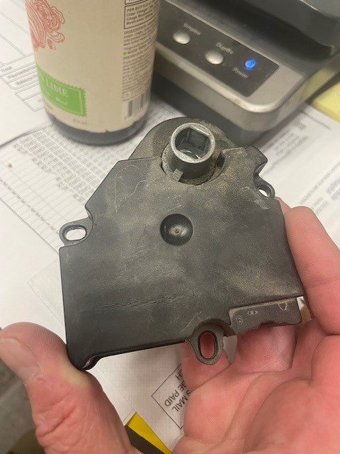

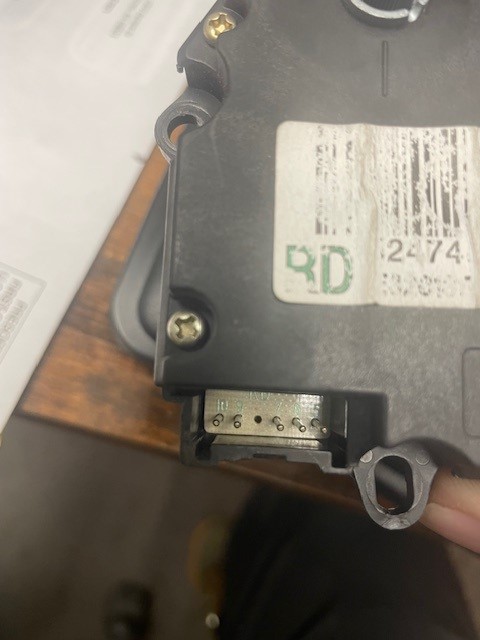

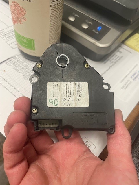

Hey, I pulled the Blend Door Actuator on my 2000 Tahoe LS. Its the one under the Passenger dash to the left of the Cabin Air Filters location. Im having hell finding the correct replacement. Literally, the auto parts store says "it's a toss up between this one and this one". (which doesn't help at all...) Apparently, there are several Blend Door Actuators somewhere in my truck too. Ugh! Does anyone have a link or something to the correct replacement part? Ive attached three phots that might help...

If this is a NBS Tahoe with a 4.8/5.3 , that is your drivers side blend door actuator. I believe the only differences is if it has manual hvac or auto hvac. The only other blend door actuator is for the passenger side, which is buried up in the dash. You do have actuators for recirculate and mode.

It has manual HVAC. I took the part to the store yesterday. Took twenty minutes to get the right one ordered. It's the hottest part of summer up here but....a cold winter is coming and that is why I need this to work sooner than later! What does "NBS" mean? Im new to the Tahoe world---been driving Jeeps and motos most of my life. I love my Tahoe and I am so appreciative of this forum!

Top actuator (TEMP) gm#89018365
Bottom actuator (TEMP) gm#89018365
RH actuator (AIR INLET) gm#89018365
LH actuator (MODE) gm#89018374
And then there are the actuators for the rear air, which I just ordered as mine quit working and blows hot air in the rear and overhead vents.
