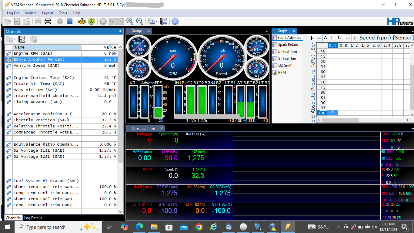

If you have a bidirectional scanner and use the mfr's codes by VIN (not generic OBD) is there a fuel composition or alcohol content value, or a reset function?
So here's what I found with HP Tuners, using their scanner app. Alcohol content was not a default channel for the app's home screen, but I was able to add it and then scan the ECU to see if there was any data available there. Sure enough, there is. Now I don't know if it's a calculated value based on O2 sensor data, or an actual hardware sensor value, but at least the ECU is capturing alcohol content data as a percentage. And the value seems plausible. Note, the ignition was on but the engine wasn't running for the screenshot below.
I can't imagine that there is a physical sensor on it, so I would bet it's a calculated percentage. They dropped the physical sensor from the GMT800s around 2005 or so.
Thanks, Steve. I think you’re right about not having a physical sensor, but I guess the question is still open as to whether or not it’s actually a stealth flex fuel truck.
