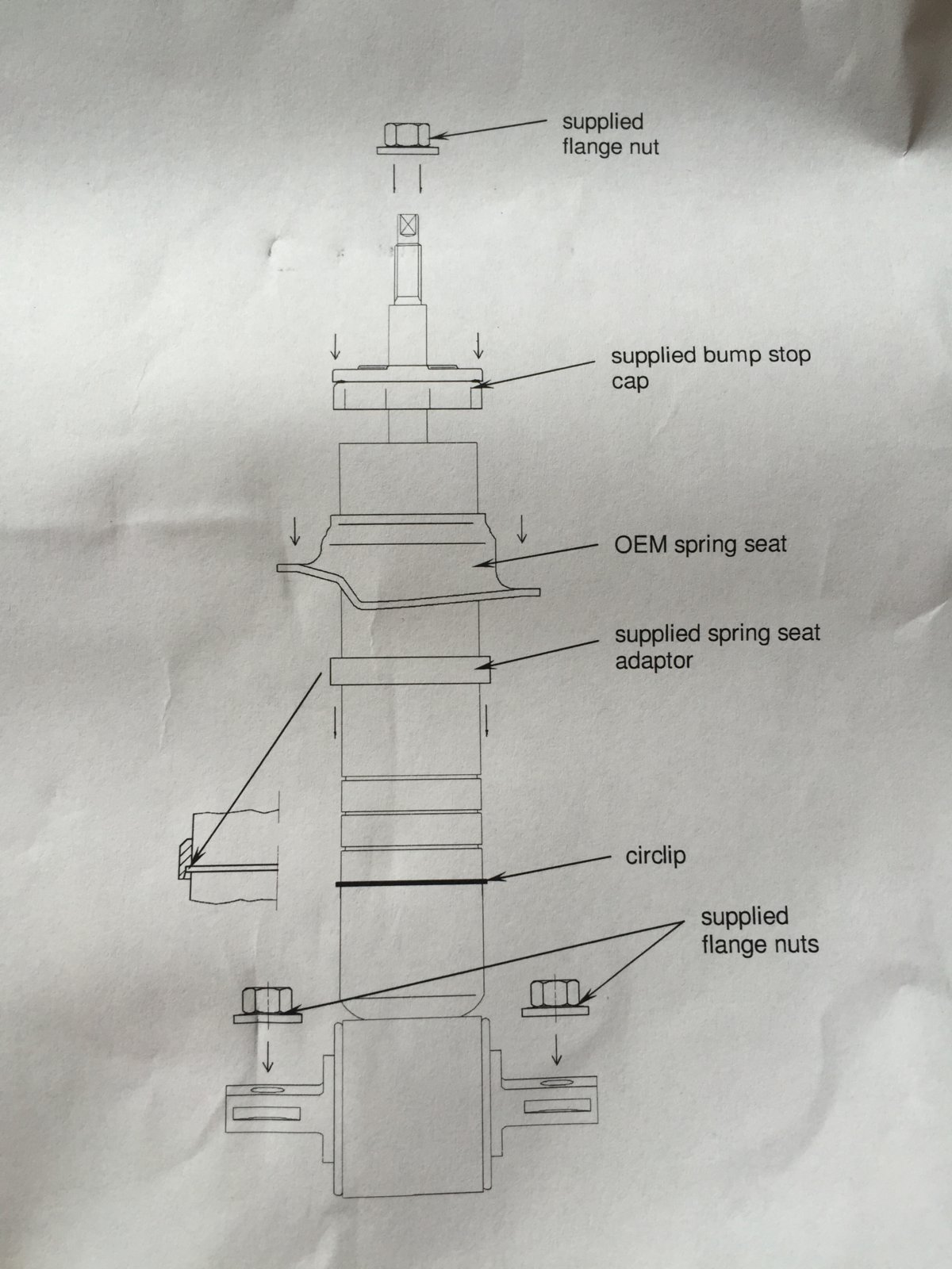

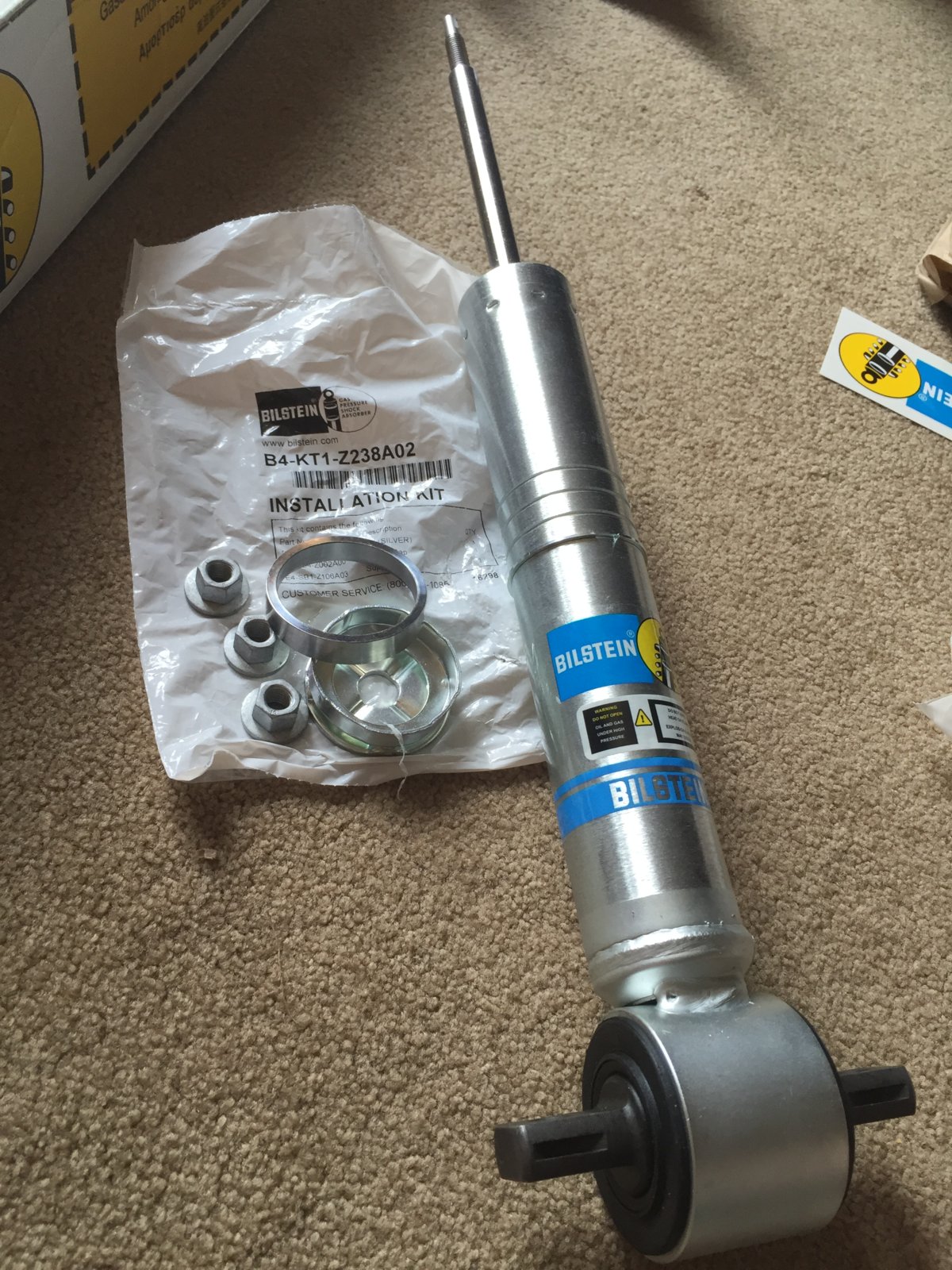

I've got some 5100 shocks but with no hardware. Bilstein gave me part number B4-KT1-Z238A02 for the hardware but Summit can't find it and I haven't found it on the net. Has anyone else tried to get a hold of this part number? Thanks.

I just got mine today. Snap ring came on the shock, the other things were in the bag. Call whoever you got it from they probably sent you someone's return

That did it. All of the individual parts were available from summit. I ordered All of them except the nuts. Some m10 x 1.5 flange nuts are pretty easy to find.

Damn man... That might have done it! I just found the "support ring" on summit and already found the snap ring. Thanks for the help!
