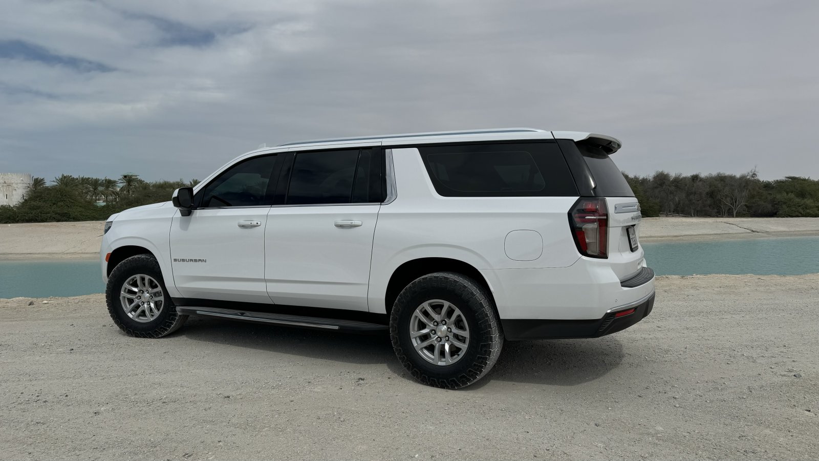

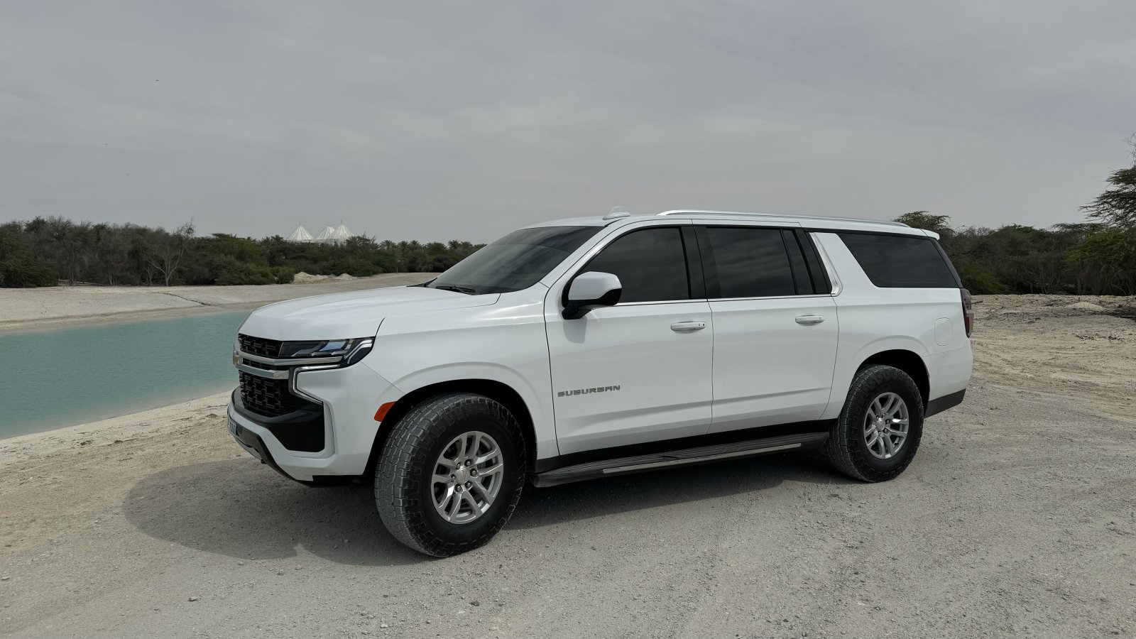

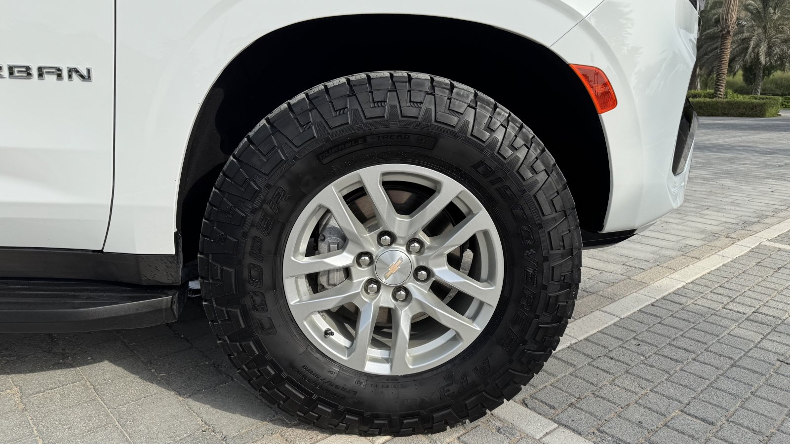

Can I put 5100’s on without any other changes? Looking to set them at 1.25” front and 1” in the back. I already have 35’s with everything stock apart from the pullback kit and no rubbing.
Anyone know what size the stock shocks are compared to these?
I’ve seen a small amount of positive feedback about these, anything negative or issues?
Thank you

I just measured with calipers and all 4 stock shocks are 51mm/2” which is the same as the 5100’s as per their website

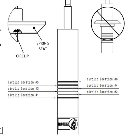

5100's are not adjustable, but they are good shocks, If you do not have air ride then they are plug-n-play

I've run bilstein 5100's on previous trucks. They're firmer shocks, but they offer better control and road feel. IMHO. I like their build in leveling kit that you can adjust when installing, but I've never gotten the advertised amount of lift per what the directions say. Some amount of settling will occur and for example if you set at 2" you may only get 1.5".
