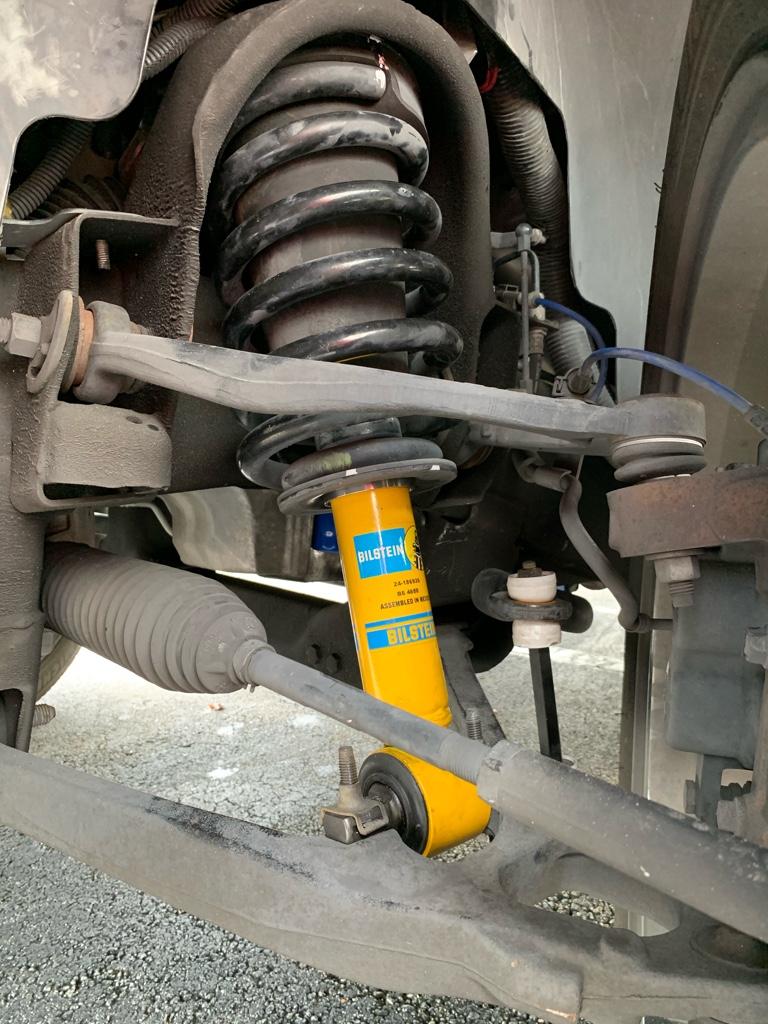

I installed Bilstein 4600 shocks and struts a week ago and now the front end seems to be higher than it was with the stock suspension. I did not take measurements before the installation but I did measure afterwards. The front is measuring 37.5in and the rear is 37in.

Here is a picture of the front driver side

If I’m not mistaken these shocks are adjustable with collars under the lower spring perch? We’re any of those installed? The more I look at the picture is sure looks like the lower perch is pretty high and the control arms aren’t parallel to the ground like they are at stock height.

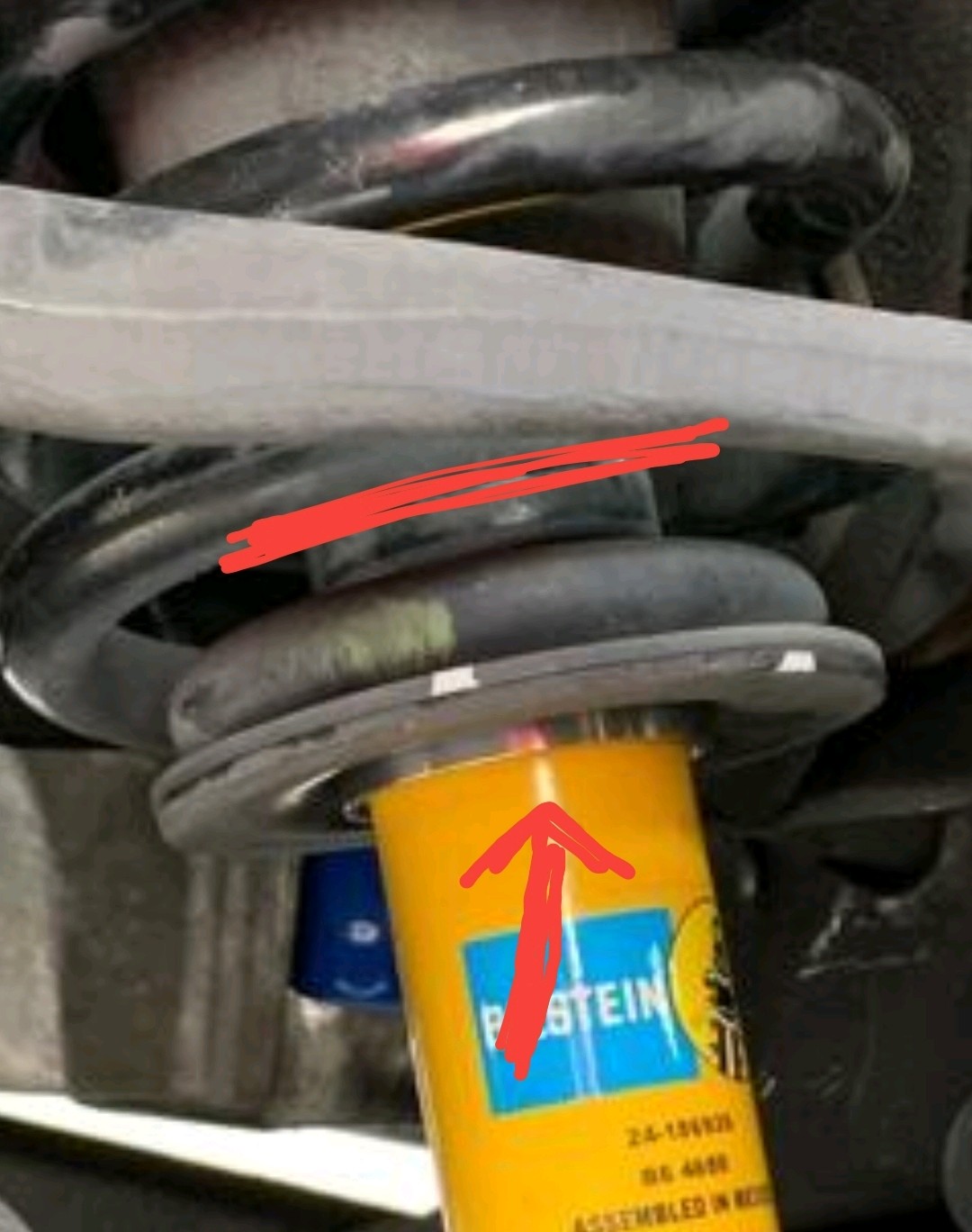

It sure looks to me like there are spacer rings installed on the struts.
If you look at the picture you posted you can see what looks like a chrome ring sticking out the bottom of the spring cup (red arrow).
The spring cup sits down over that and it ends up there where I drew the red line.

I was thinking the same thing at frist but Bilstein's web site says these aren't adjustable like the 5100 so unless it came with an "accessory kit" for the 5100 by accident I'm not sure most shops would just have those laying around. I meant to ask you to measure the length from the bottom of the spring seat to the bottom of the tube and forgot all about it.

THe 5100s have a different shock body with recesses in it for the C clip to land in that allows for it to be adjusted. I have installed both. Not sure how you'd make a 4600 adjustable...

Is that how the lower portion of the strut is installed from the factory? Looks upside down to me. I believe that bar goes underneath the control arm. If so that would make a difference.
Edit, did some googling and I guess thats how these are factory. Ive seen other vehicles with a similar lower mount that is underneath, and some install underneath for a slight drop with different hardware.
They are installed above the control arm from the factory. If they are installed underneath the control arm it will lower the front end
yeah i see that now. Edited my post.
