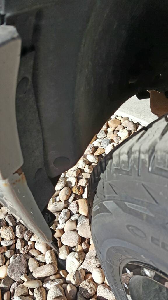

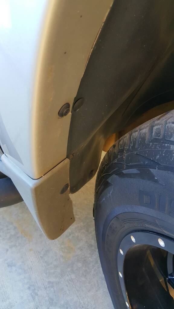

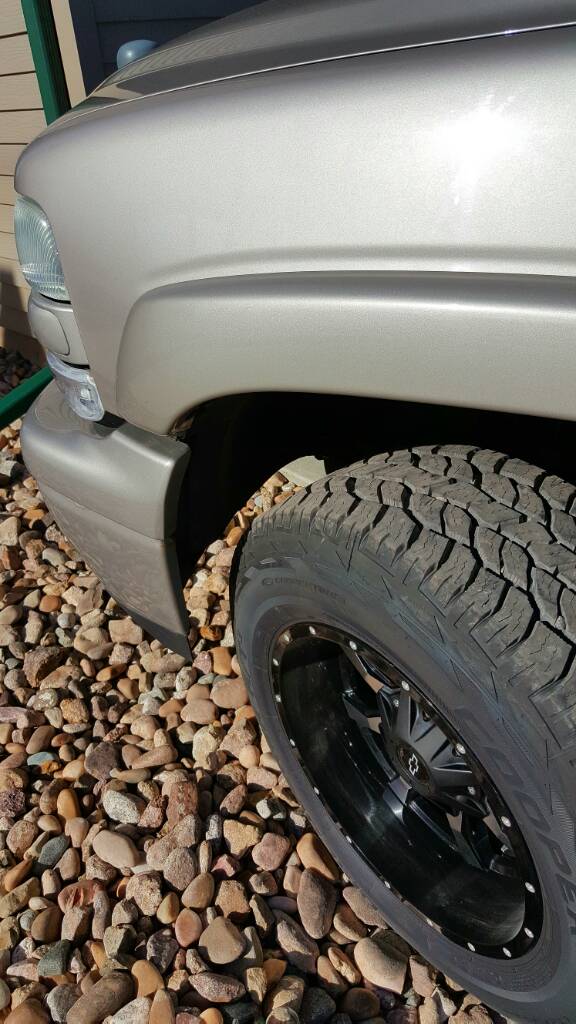

Good luck fitting a 35 with that low of offset. I have keys and 1" spacer. 18x10 -24 and 275/65-18 tires so a 32x11 Tire and mine rubs full lock backing out of parking spots.
Oh and I have trimmed a lot of plastic off just to "barely" clear these.
Sent from my SM-N920V using Tapatalk
