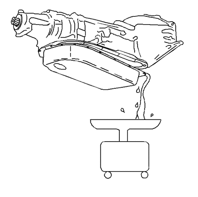

  2. Place a drain pan under the transmission oil pan.
  3. Remove the oil pan drain plug, if equipped.
  4. If necessary, remove the bolts and position aside the range selector cable bracket for clearance while lowering the pan. It is not necessary to remove the cable from the lever or bracket.
  5. Remove the catalytic converter. Refer to Catalytic Converter Replacement (4.8L,5.3L) | Catalytic Converter Replacement (6.0L and 8.1L Engines).
  6. Remove the oil pan bolts from the front and sides of the pan only.
  7. Loosen the rear oil pan bolts approximately 4 turns.
  8. Lightly tap the oil pan with a rubber mallet in order to loosen the pan to allow the fluid to drain.

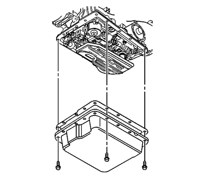

    Remove the remaining oil pan bolts.
    Click to Enlarge
    Remove the oil pan and the gasket.

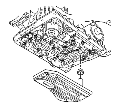

    Click to Enlarge
    Grasp firmly while pulling down with a twisting motion in order to remove the filter.

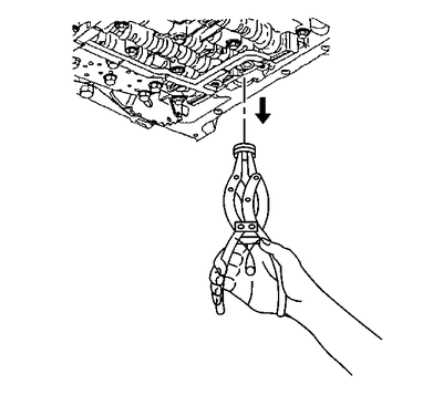

    Click to Enlarge
    Remove and discard the filter seal. The filter seal may be stuck in the pump; if necessary, carefully use pliers or another suitable tool to remove the seal.

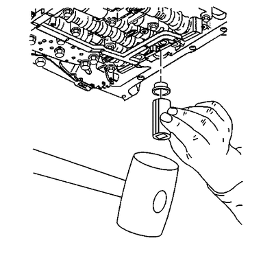

    Click to Enlarge
    Coat the NEW filter seal with automatic transmission fluid.
  2. Install the NEW filter seal into the transmission case. Tap the seal into place using a suitable size socket.
  3. Install the NEW filter.

    Install the oil pan and NEW gasket.
    Click to Enlarge
