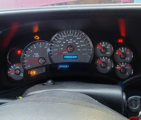

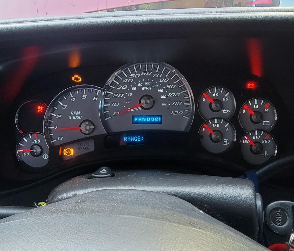

IMHO it's absolutely worth it to add the tranny temp gauge, and a perfect time to have it done. I do some light towing and it's great to have the baseline temps and the temps during towing.
I had white LEDs put in mine and don't see any difference between them and the OE incandescent bulbs. My old eyes can't handle the colors. Colors other than the white are difficult to focus on and look fuzzy/blurry. YMMV
Here's mine with the white LEDs right after lighting repair and tranny temp gauge add:

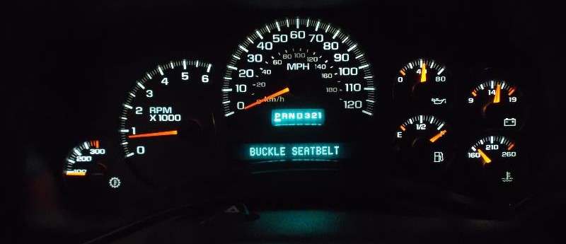

I used https://issautomotive.com/. Had cluster rebuilt, added trans temp, face lift, and chrome trim. Think it was like $450.My gauges.jpg
