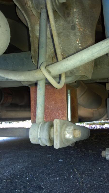

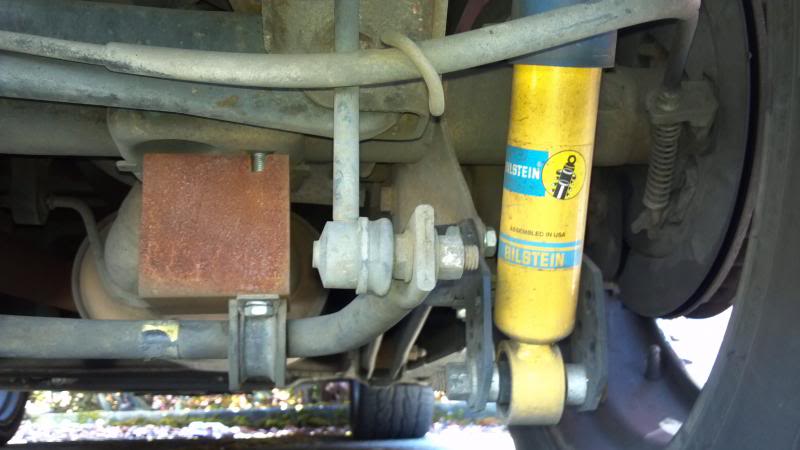

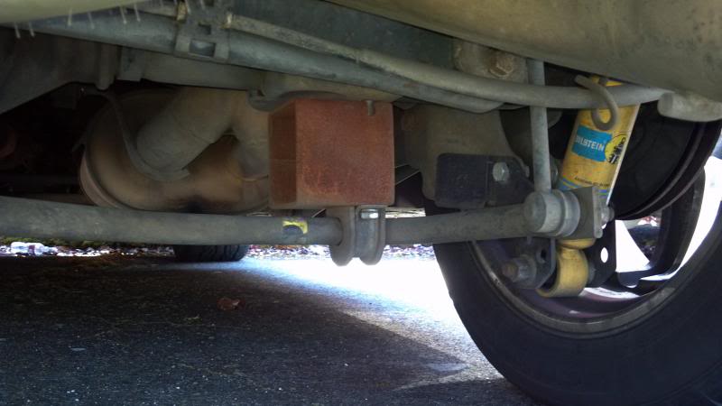

OK here's a couple pics I snapped on my lunch break today. Please remember I built these on the road with limited tools at my parents house in Montana lol... You'll notice that the sway bar doesn't come anywhere close to making contact with anything. The bar hangs about 1" below the pumpkin on the rearend but it's still a good 6"-7" from the ground. Hardly enough to worry about scraping on anything.
The square tubing is 5"x5", 1/8" wall thickness. I bought the tubing from a local fab shop for 10.00 and they even cut them to length for me. The bolts/washers were about another 6.00.

oh never mind now i know why it clears. So the swaybar is below the axle fully exposed right?

Looks just a little sketchy haha dude just buy the hardware kit. It's not that expensive..
Yes, right now the sway bar hangs about 1" below the center diff on the rearend. The 5x5 was the only material the fab shop had that would work but a 3x3 piece would work just fine for a 5" drop. But like I mentioned before as it is now it's still about 6-7" off the ground at the lowest point. This truck never sees dirt roads and I don't remember ever needing more than 3" of ground clearance for anything on a paved road around here. The LCA brackets on my Camaro's rearend are probably no more than 3.5" from lowest point to pavement. ;)
LOL,,, don't be hating on my backyard engineering lol... In all honesty this was supposed to be a temporary fix so that I didn't have to hear the thing banging on a 550 mile return road trip coming home. But,,, it has been this way for almost a year now and it's doing just fine. And I got plenty of clearance to go as low as I'd like to in the future..... With that being said, these spacers are staying. ;)
