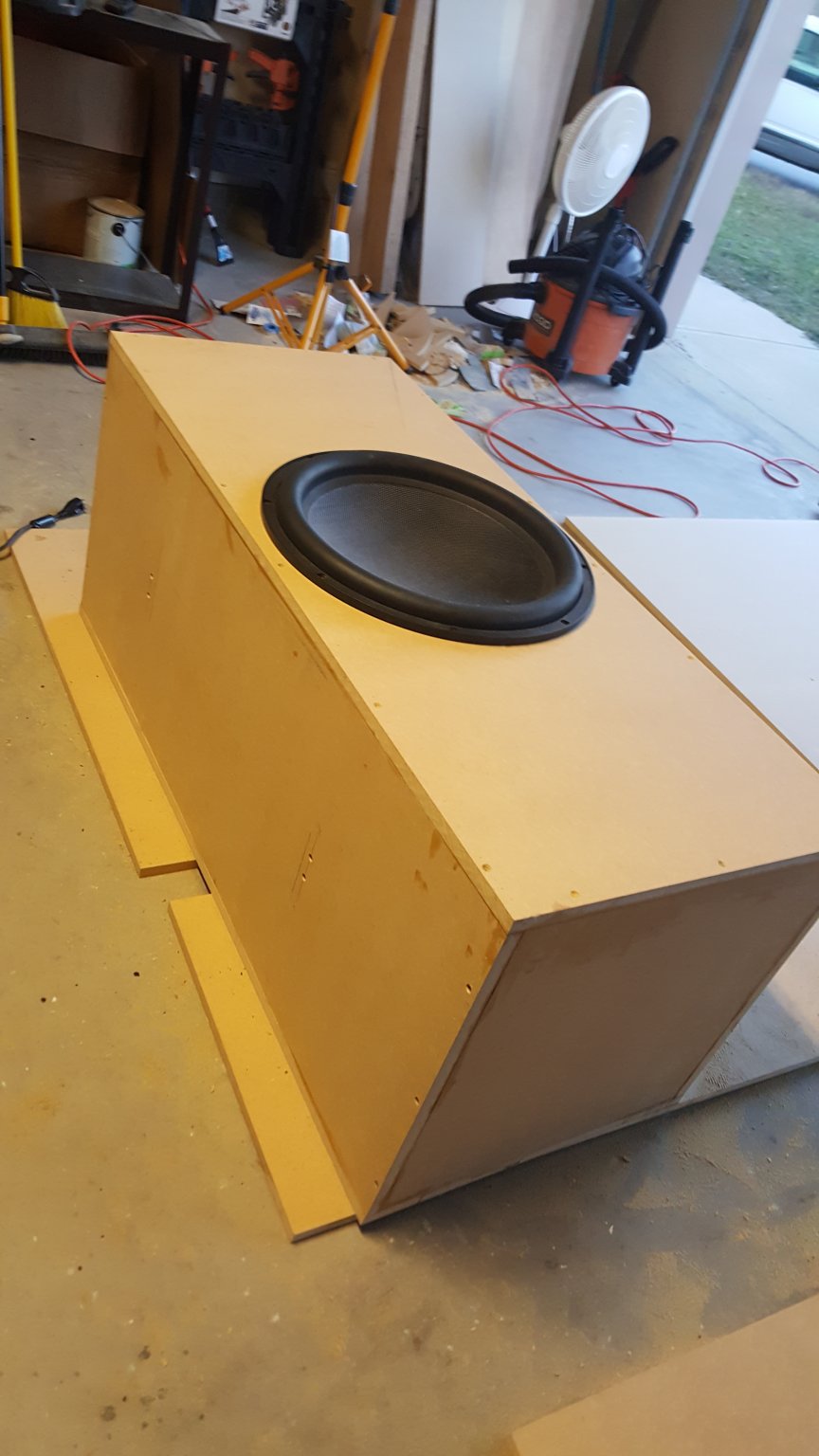

Sealed or Ported? Can't see a port from that pic so I assume sealed?
It's a sealed box, after researching the parameters on the sub I found out they do better in sealed enclosures. This one is 9.7 cubic feet with an f3 of 26 Hz.
That is a HUGE box for sealed, crazy. It should sound nice and tight / crisp when it's all done. GL

Good god man, rattle your brain through your ears lol. What's the dimensions ?
Gonna be bumpin hard:rocking:
That's the plan haha, I'm actually down grading from 2 18s but this should still do the trick. It's 48x20x21

I need to build a box for my 12. It's nice with all this room, I've only had pickups before the Tahoe.
I'm debating the same concept (kinda). Going from 2 15's down to maybe a single 12". I love the cargo space and I want to keep at least 1/2 the 3rd row in, so maybe a nice ported 12" back there.
