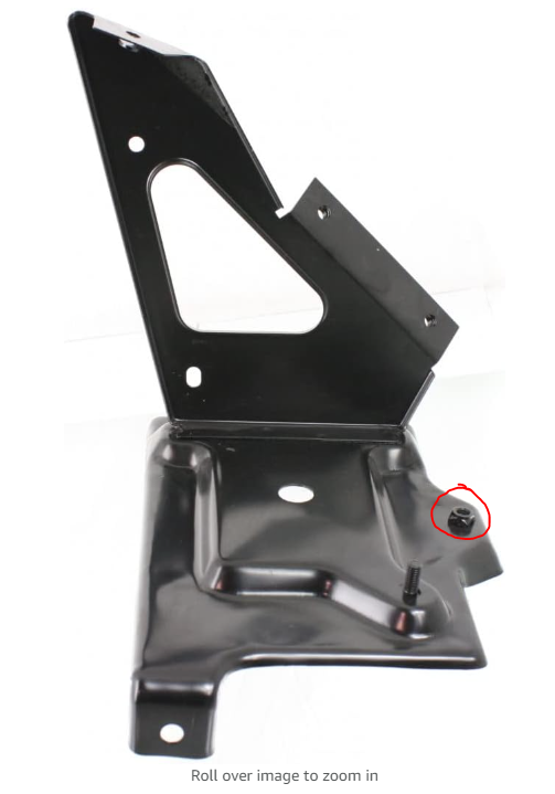

It snapped off even with the tray. Nothing to grab onto because there's a nut on the under side of the tray. I'm guessing the right way to do it would be to try and drill the bolt out but hoping there's an easier way? Right now the battery is held down with a bunch of zip ties

There's a nut welded to the underside of the tray. That's where the bolt sheared off. Can't replace that with home depot unless I drill out the entire thing and then have something to fill that hole (some big fender washers??).

So, the bolt broke off but the battery still came out? That was not made clear earlier. No battery in the way. Drill the damn thing out, use the correct size tap and run a new bolt in there. You appear to be over thinking it. Unless I missed something.
I was just wondering if there was an easier way. I've never drilled a bolt out like that and don't have a tap.
