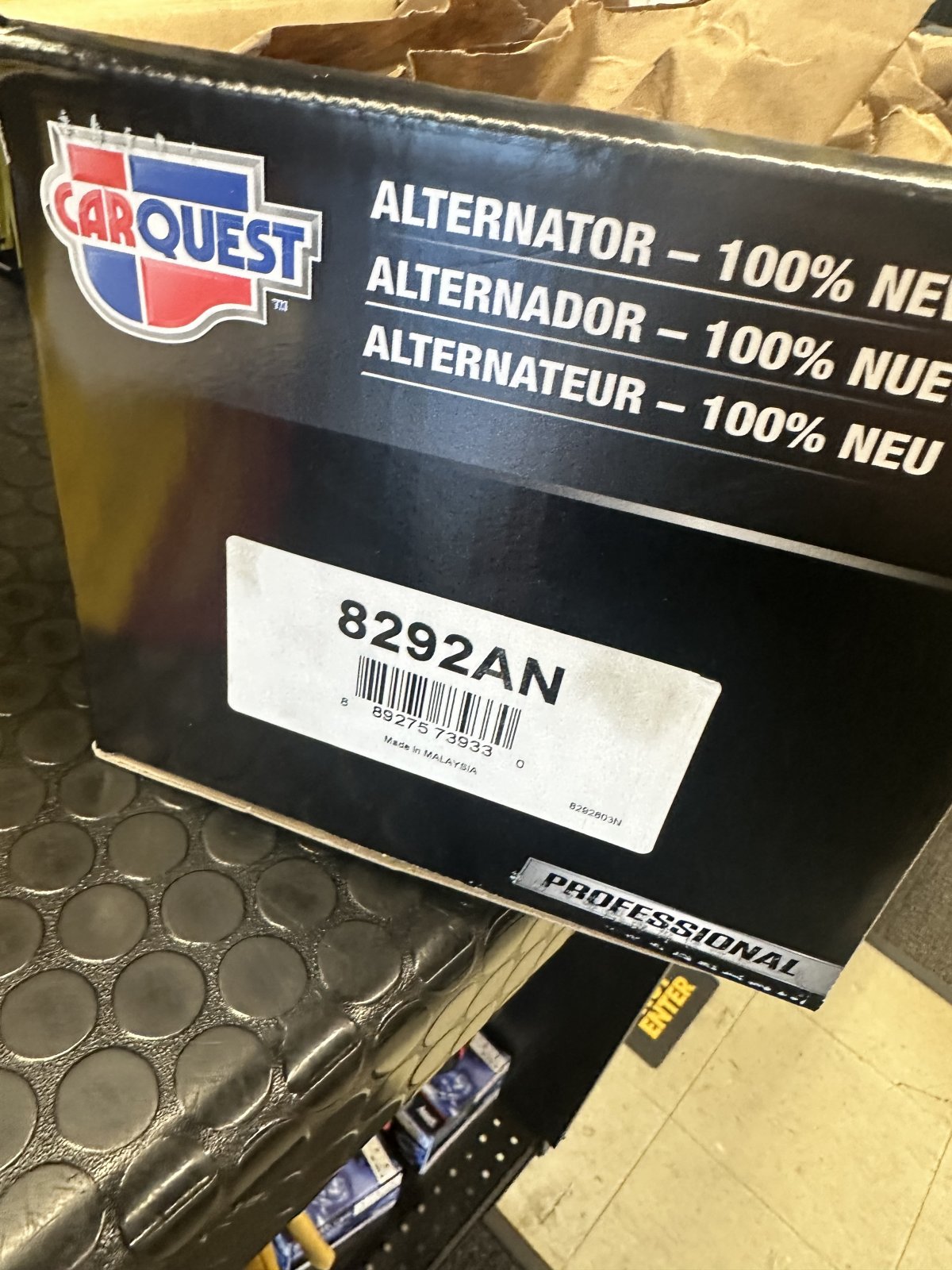

I bought a brand new alternator from advanced auto parts
Carquest 8292AN Is the part number for it and it actually had the same exact brand in there from 2006.
I have not cleaned all the grounds but I should look into that
I feel like this should resolve my battery drain issue but I’m not that confident. After leaving parked and I test the voltage on the battery it reads 12.4 volts and I think it could possibly be holding up high because the battery is new. I believe 12.4 is at 75 percent charge but I’m not sure what these should read after 24 hours or more.
