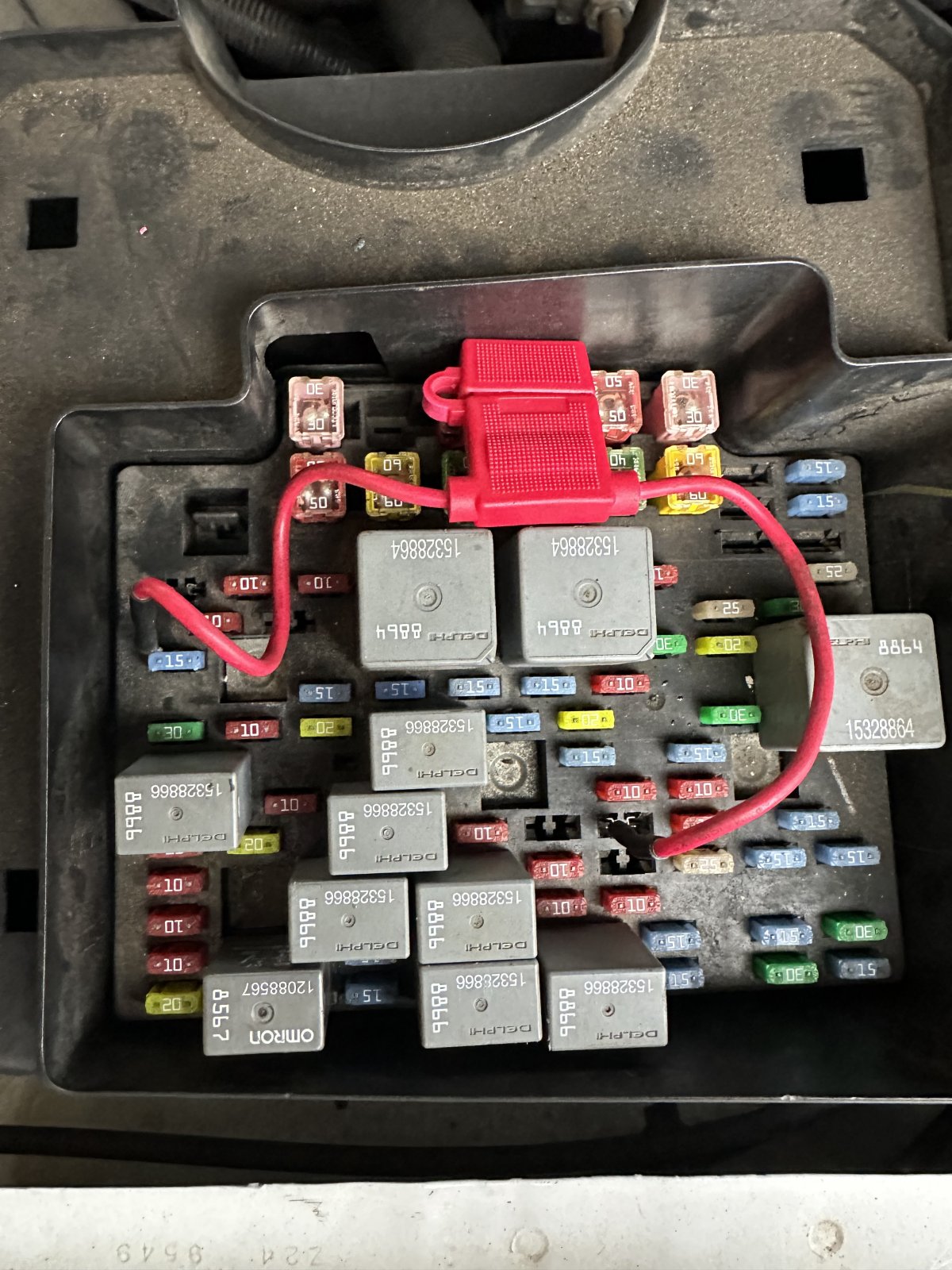

This is the shops wright up of what they did for the parasitic draw a couple weeks ago
“battery dead after sitting overnight.
vehicle would not start in am, fully charged battery and performed draw test. found 170 milliamp draw, should be under 50ma. traced draw to IPC/DIC fuse (instrument panel cluster / driver information center). unplugged instrument cluster and draw dropped to 20ma. removed foglight fuse and IPC/DIC fuses. Ran 10a jumper fuse from fog light fuse voltage leg to IPC/DIC leg. Fog light fuse is ignition voltage, not constant, and will shut down power to the cluster with key removed. fog lights no longer function.”
I took it back in the same week because the battery was still dying. He then ran the jumper fuse to the trailer park brake so I now have my fog light back and he then determined the battery cell may have been damaged. I got a brand new replacement die hard Gold battery and have been having the same problem. Fully charged battery keep dropping down to 12.3 volts in a few hours and then down to 12.0 a few more hours sometimes.
I called him today and he said to remove the trailer light fuse that the jumper was connected to and to connect the jumper directly into that circuit and to monitor it but within a few hours again it dropped down to 12.3 volts from fully charged 12.6 volts. When truck is running it’s showing 15 volts which he said was normal for these trucks
I have no idea what to check for now as he said he didn’t see anything else. In the verge of taking to another shop but just dumping a lot of money into this thing. This has been going on for years
I tried the 24 hour disconnect for the bcm but same thing, battery lost voltage. If I had a bad bcm would I have other symptoms? I believe it’s been getting poor mpg from what it use to get

Pulling power for the instrument cluster from another switched circuit is kinda of band-aid fix, but works. Basically, the cluster will only have power when switch is ON instead of all the time.
So it sounds like you may have more than one source of parasitic battery drain?

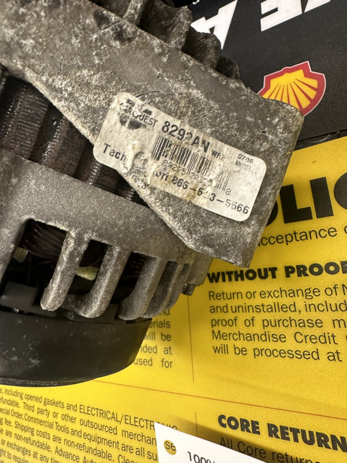

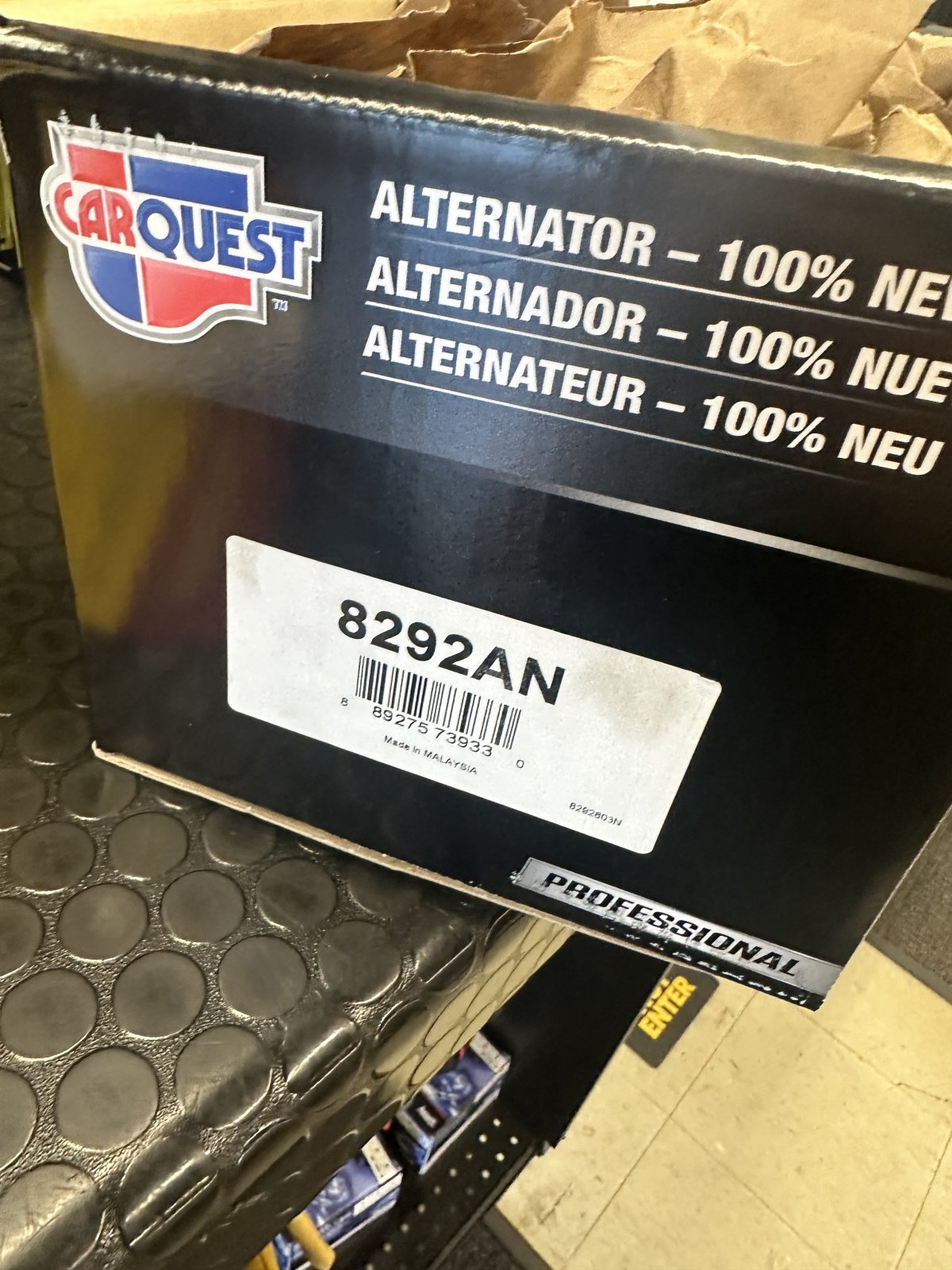

Anyways then took it to the auto parts store to have battery and alternator checked and the diagnostic tool came back with bad diode in the alternator. I had the alternator and battery replaced with new ones 2 weeks ago (July 6) and so far my battery has been reading 12.5 volts after 48 hours of it not being driven when before it would be at 12.1 or less the next day after being driven and then drop more each day till no start
I’m hoping this is the final draw for this nightmare of dead battery and it’s crazy that all these shops over the years wouldn’t think to test the alternator unless this is a coincidence. The alternator that was in there had a sticker 07/06
