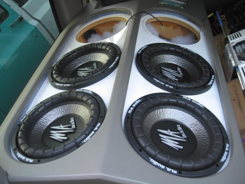

i have a band pass and i have a ported box the ported sounds good but would that sould be even better in a banpass box jus wanna know
