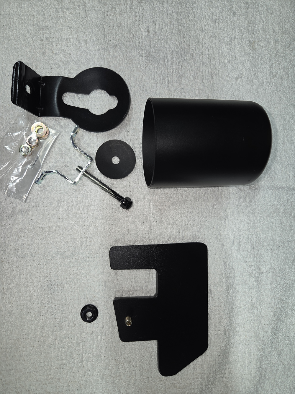

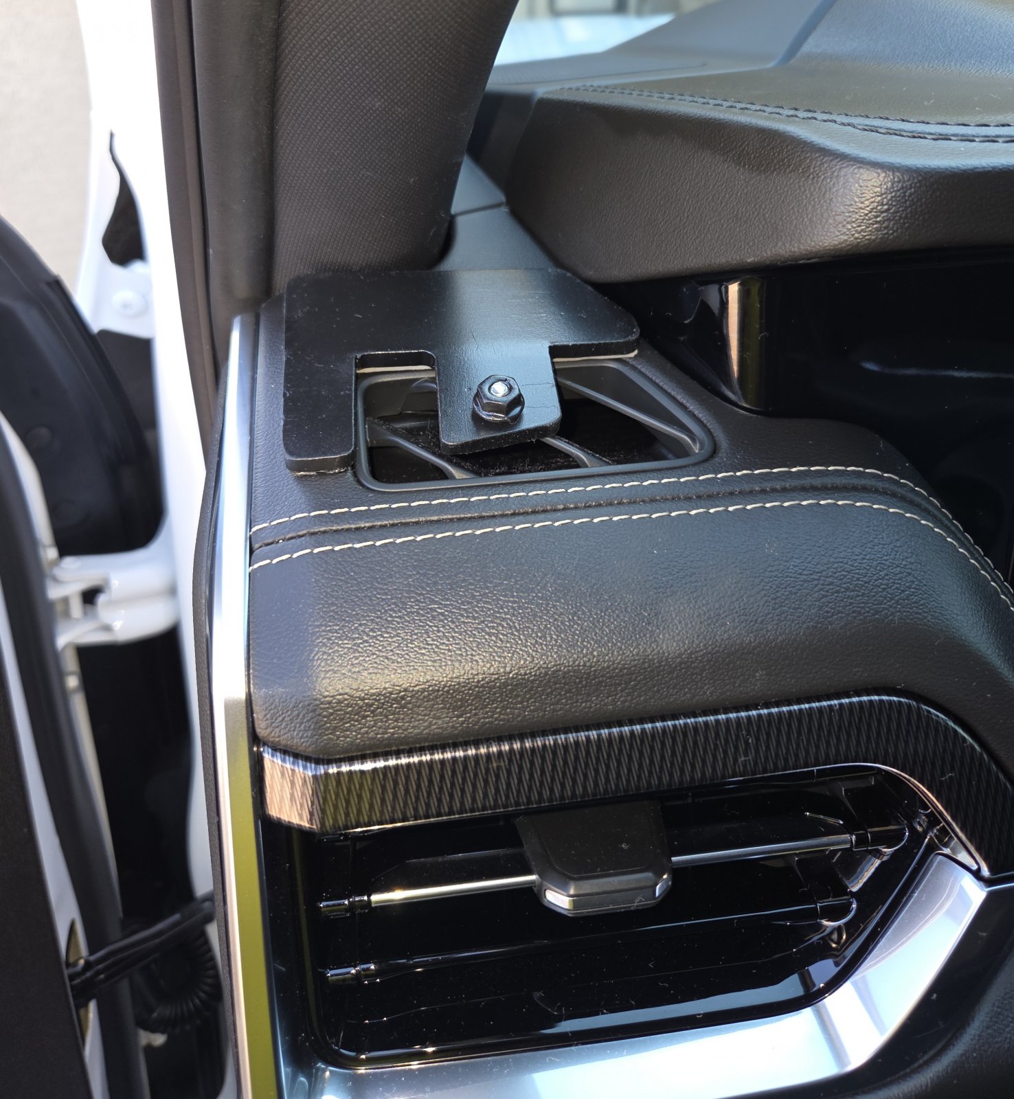

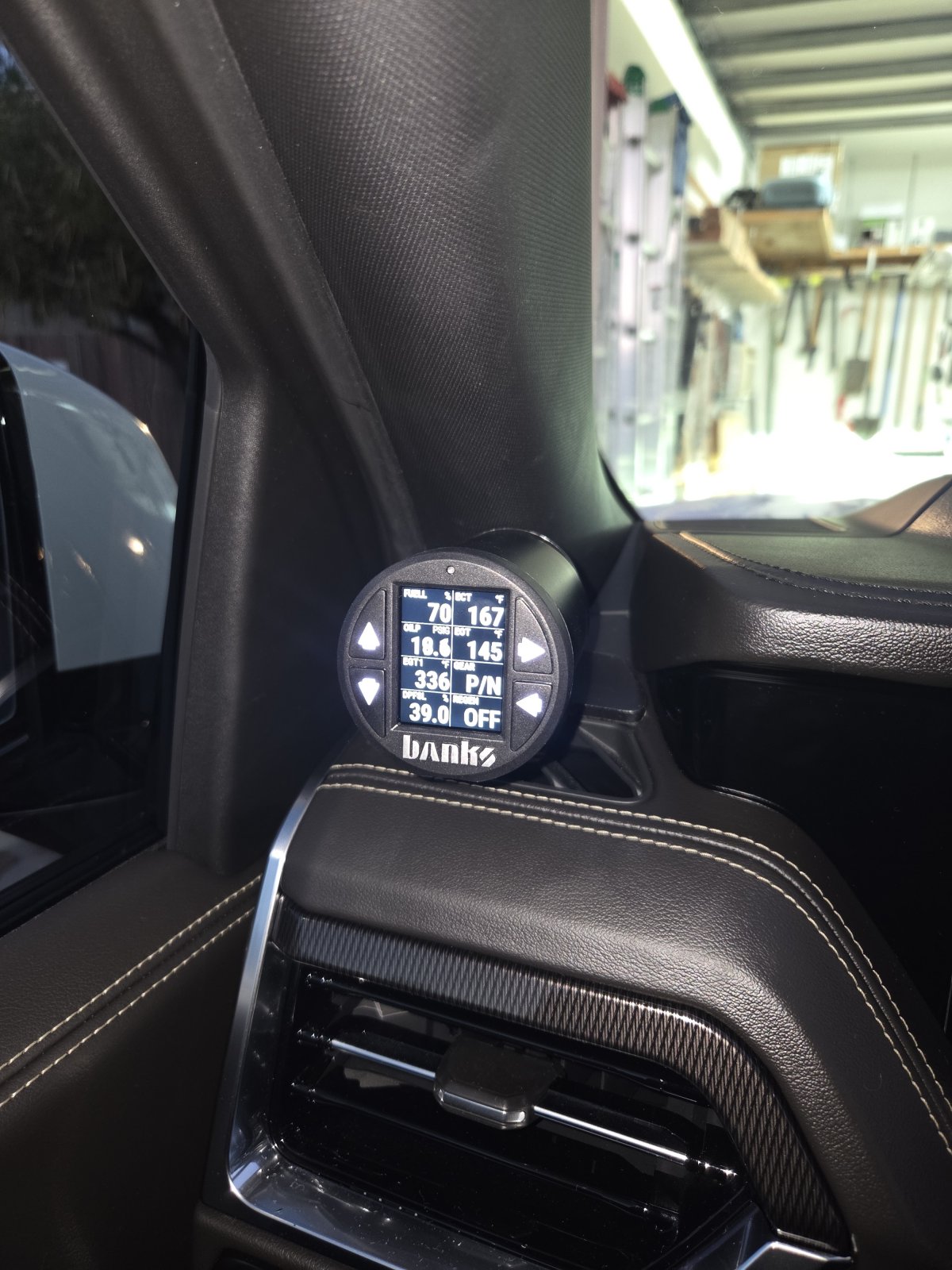

Got my iDash Pro from Banks today and installed in in my 2025 Yukon Duramax. I had a piece of 3/16" thick aluminum laying around so made a bracket with two "fingers" one for the pod mount and the other to help brace the bracket. I drilled and tapped the pod mount one for a 10-24 bolt and threaded it and inserted the bolt from the bottom with Loctite. I used 3M tape that I already had to mount it to the dash which has a perfect little spot for it. I bought the pod off Amazon for $15.99 and had to wrap the iDash with a few turns of black electrical tape to make a snug fit. Can't even see the cable as it is in the lower back of the pod and down underneath the rubber door seal and the extra length behind the end dash panel. Still playing with which parameters I want to see.
Links for the parts here:
