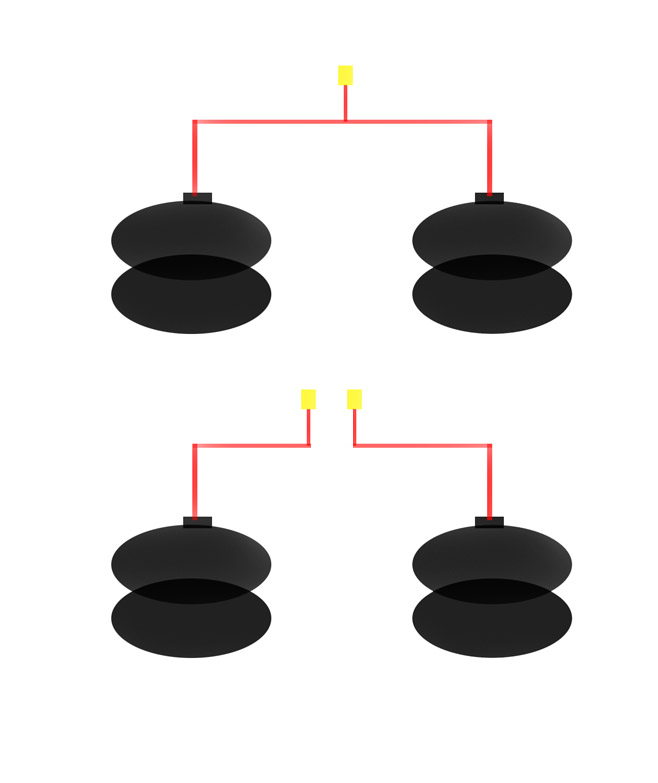

Re. the air movement between bags while cornering. Am I understanding this correctly that I should run each bag independent and each bag will have it's own shrader valve?

I kinda started talking true air and got off point a second.. 4 valves was obviously a reference to an onboard air set up..
.. but yes.. on a set n forget you should run each one their own shrader..
Crossover air is where alot of the sway comes from.
MOBmentality
Has a $25,000 Punch
May 3, 2009
3,720
Each bag takes X amount of force to make it inflate.. with the value of X increasing with the physical volume of air increasing..
When running separate lines you allow the bag to work as a spring dependent on its ability to maintain X
When running one line you destroy the value by letting the trucks weight force air from one bag to the other, instead of letting the bag act as a spring it lets the downside bag release this high pressure situation by forcing the air into the bag with less pressure (the high side of the turn) and over stretching the low pressure bag on the high side. By creating a high pressure situation , Since the trucks weight will out weigh the psi of the low pressure bag all the way till failure..
Basically.. making a hard turn or long rolling turn can force the ONE bag on what should be the low pressure side to hold up to 2 times the volume of air its accustomed to.. and since the value of X goes up with volume Twice as much air can be as much as 4times as much psi.
Causes bad sway .. can ruin bags.. and will make the left side of your tuck lean a lil when it has a full tank
