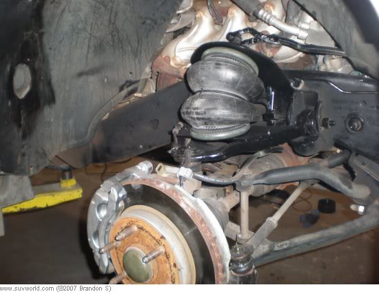

just picked up some chassis tech 2500 bags on ebay for $51. ordered the u build it plate brackets from airbagit.com. my plan is set the bags at a certain psi and forget about it till i bag my front then pick up a tank, compressor, ect. should get parts in next week and ill post pics of the build. any ideas on a front setup for an awd denali?

this is what they did the first time around for me. It just set the truck on the tires.

is that the bracket and upper control arm from airbagit.com?

and i have spindles and keys, will i need to eliminate torsion bar

im not sure on the control arm that was about 2 years ago. Yea you will get ride of the tbars.
what year is your truck? If you dont have those parts yet i will see if he has saved them or what hes done if your interested.

If I wanna keep the half shafts how can I seat that up? Can I just bolt on to upper CA or would I need another one and a bracket on top

It gonna have to be fabbed up...
weld a plate to the upper CA and the bolt the bag to that then you will have to make an upper mount for the bag as well.
pretty much like this pic

Correct me if I'm wrong, I seen in another thread that I can't weld to the factory control arm, is this true, if so what should I do.

You are correct. You cannot weld to the cast metal control arms.
