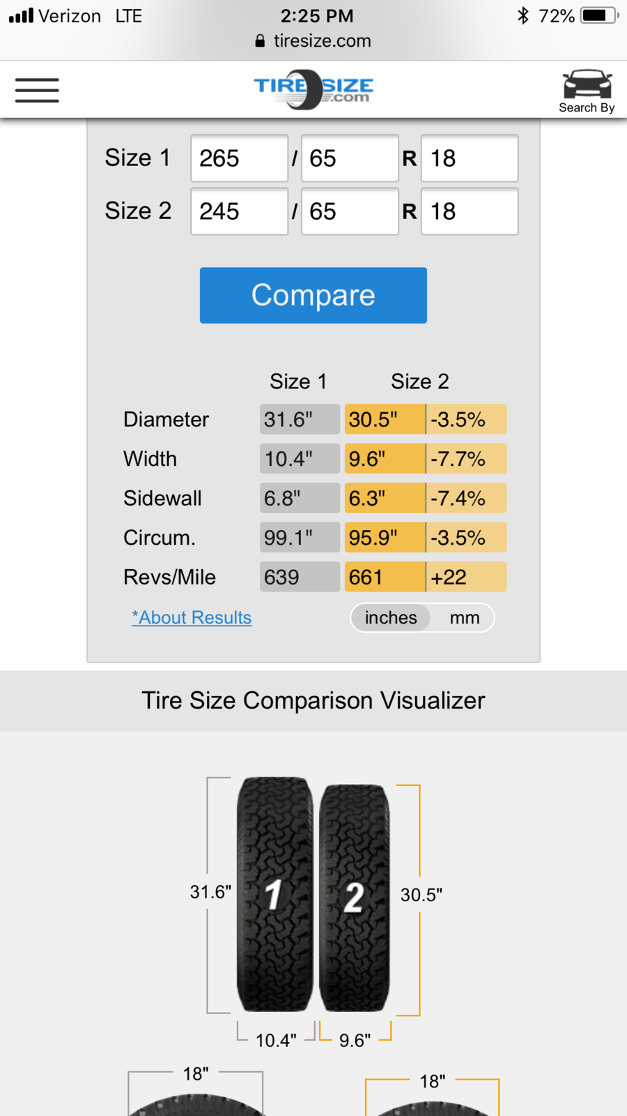

Also, I called Les Swab for tire prices on a tire that's 265/65/18 to match that bad tire, and the salesman said 265/65/18 is too big and recommended 245/60/18.
2. What is the correct tire size or the best tire size for highway driving on a 2011 tahoe/Yukon 5.3 v8 4wd?

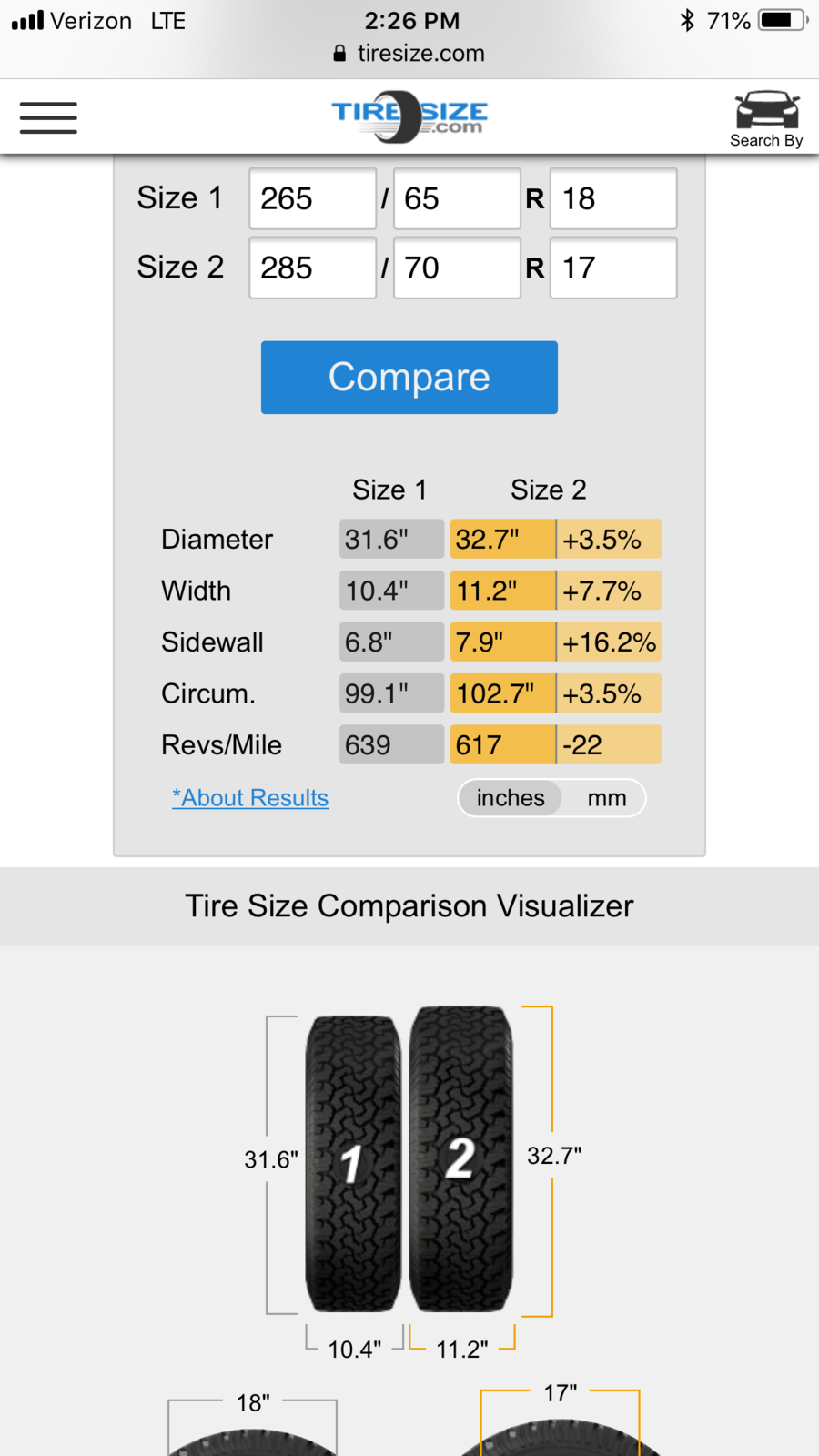

Look inside drivers door and it will tell you stock size your truc came with.
Any tire you want.
Dont listen that dope.
I have 285/70/17 and my 13 runs fine hghway, rain snow or sun.

It seems my tahoe lugs because of the 6spd transmission (low rpm in 4,5,and 6th gear) i have always been thinking that a 1 inch LESS overall tire height would help stop the lugging when in over drive gears because the rpms would be higher, and the tahoe would be more in the powerband range. Any thoughts?

Thanks for the info...so for a GMT900 using an 18 inch rim, 265/65/18 is stock size....i bought this Tahoe used, and didn't know what the stock size would be, just assumed it was stock size....but always thought because of the 6spd lugging a smaller tire would help the lugging...
