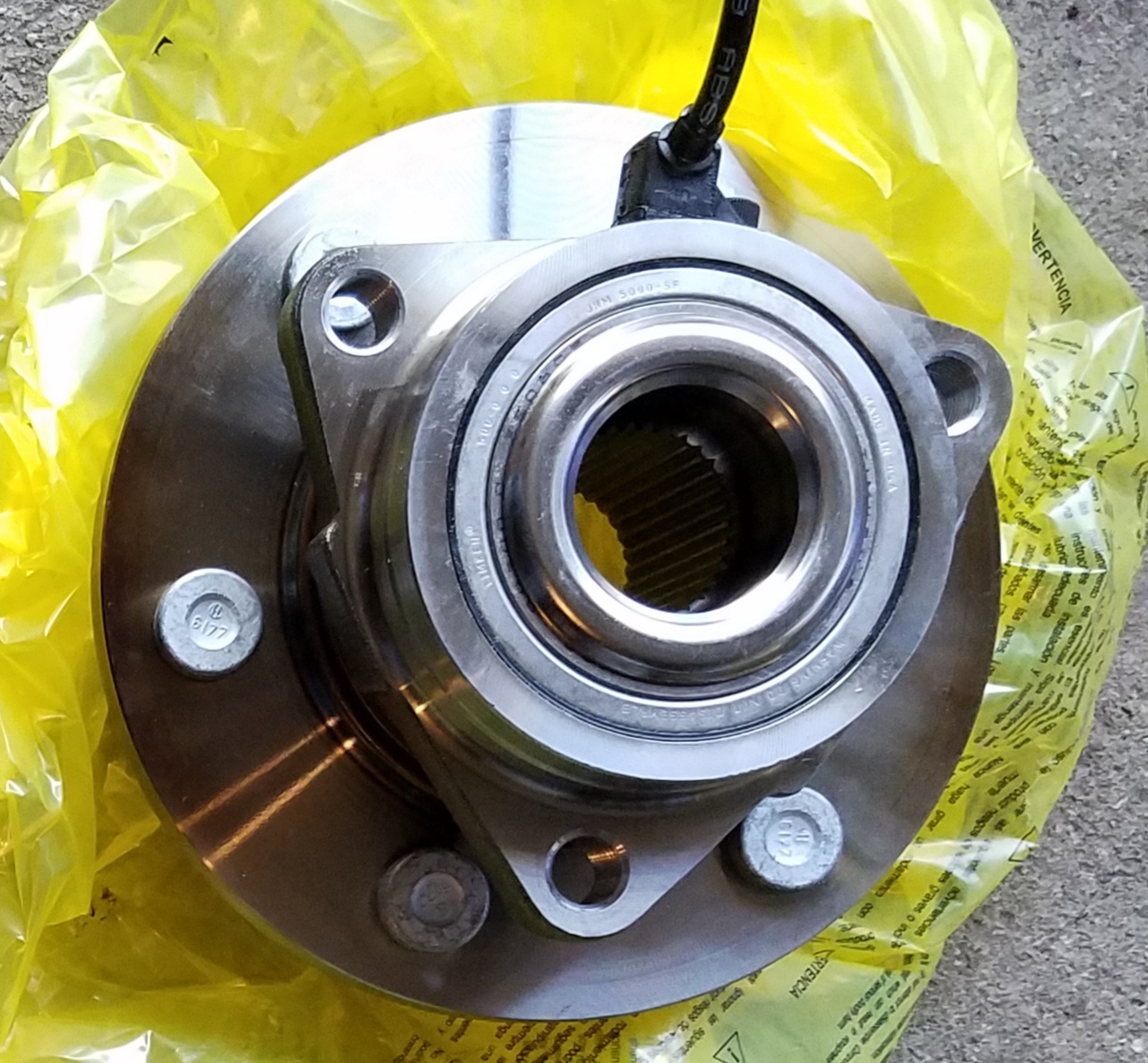

I recently purchased two new Timken SP500301 hub assemblies for my 2009 Tahoe LT. Unboxing both hub assemblies, I noticed some grease around the area where the sensor wire attaches to the hub. Both hub assemblies are doing this and I provided a picture of one of them. Is it normal to expect something like this coming from the box? I wouldn't think so and would expect this area to be clean. Please, let me know if you think this may be a problem.

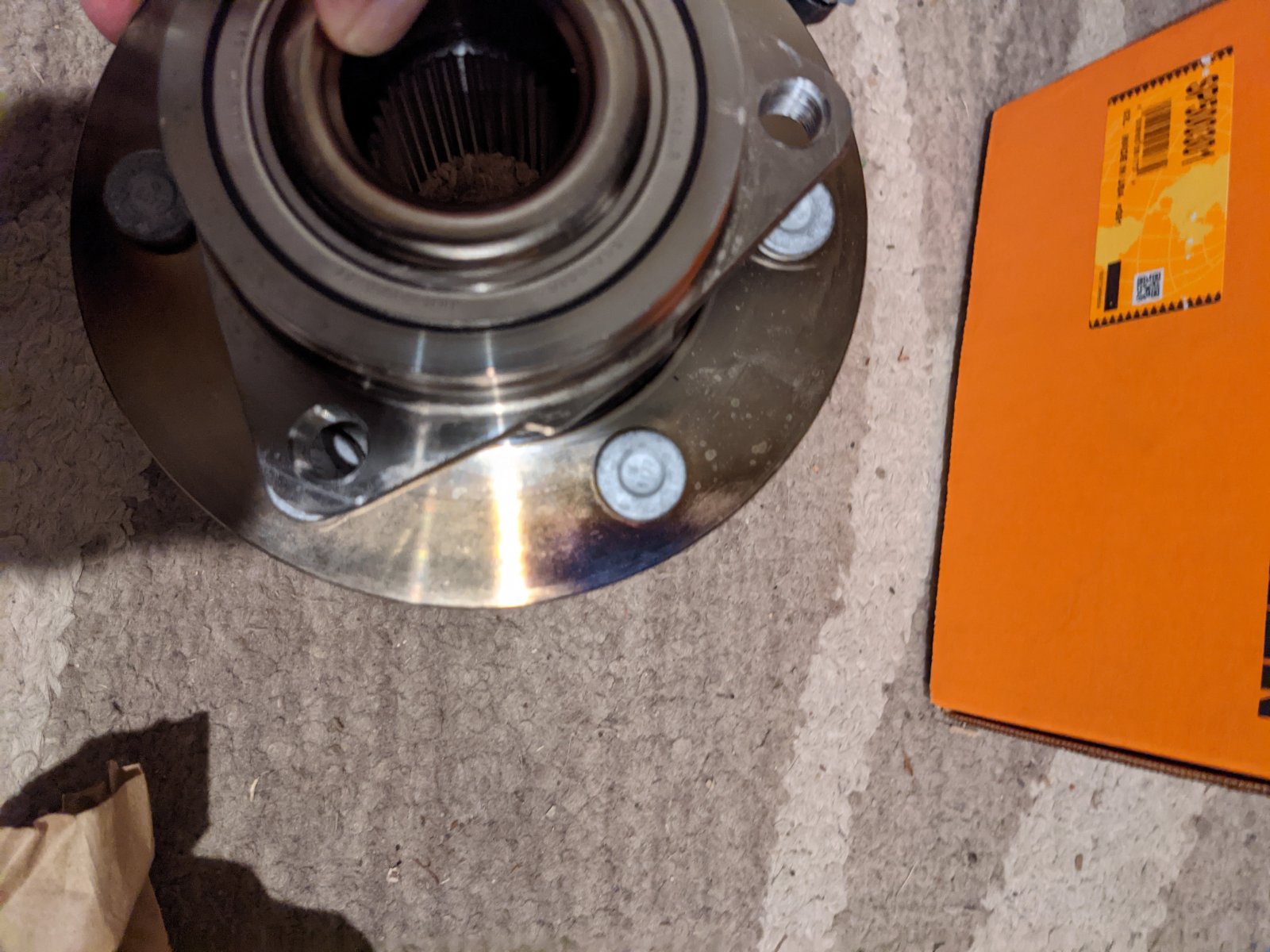

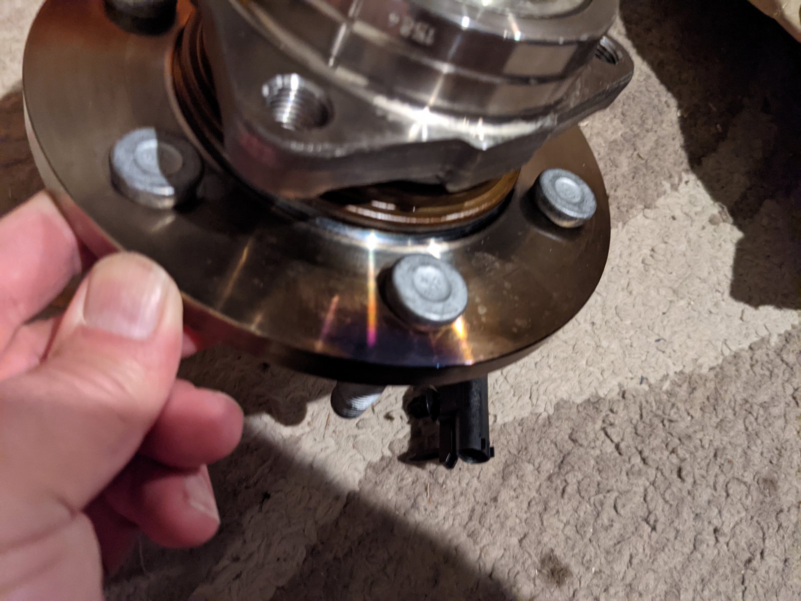

Also, one hub assembly has what looks like burn marks or where the metal overheated near a couple of places where the wheel stud is attached. I attached some pictures. Again, I would not expect this for a new part.

Grease looks cooked and should not be there.
Perfect! That's the answer I was looking for! I thought that grease should not be there, too, but was not sure because I had not replaced a hub and wondered if this is what is like coming out of the box.
