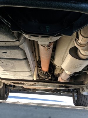

Slid under today and noticed a polished area on the driveshaft. Looks like it has rubbed on the fuel tank heat shield.
Why this would take an hour to occur on the highway after a fuel stop? Maybe the combination of old / original shocks in the rear caused enough suspension travel for the contact to occur.

probably not possible to happen due to worn shocks, sounds more like the heat shield around the gas tank is bent, there should be a good 4 inches of space at any point, maybe if one of the gas tank straps broke and the tank was dropped and pushed the heat shield out it could happen but the gas tank is otherwise attached to the body and the drive line wont move side to side unless the rear axle was completely broken off from the body
post up a picture of where it is rubbing

I couldn't fit a finger between it, bent it up towards the body. This is the clearance now.
Possible something happened in the body shop while getting hail repaired.

Looks bent as if someone drove over something perhaps...or as previously stated the tank has released placing pressure on the heat shield in that specific areas. Either way not good. Have you attempted to place it on jack stands, place the car in drive and watch the shaft spin to gather further information? Initially I was in swartdivers camp since I’d had a similar problem. Good luck with further diagnosis.

Take it out and see if it's bent. If not, take it to a driveline or truck shop that does driveshafts and ask them to balance it. If the tube is bent, use that sticker to order a new one or have the driveline shop put a new tube on it. If there vibration while driving, it's going to damage the rear differential and transmission/transfer case if you keep driving it.
