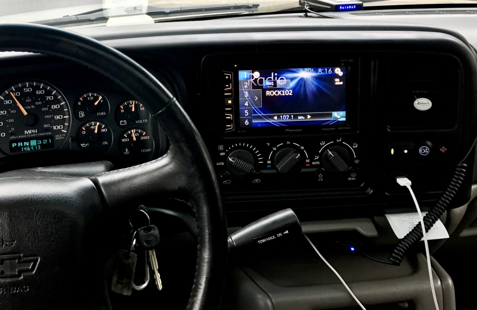

I bought this double din and ordered a wiring harness. I've got everything hooked up but not getting any sound?

Blue/white wire connected to the head unit and harness? That's the amp turn on signal.

There's no blue white wire coming from harness to hook to unit

Do I need some special adapter?
