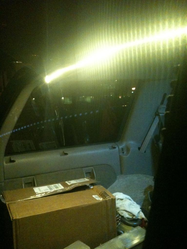

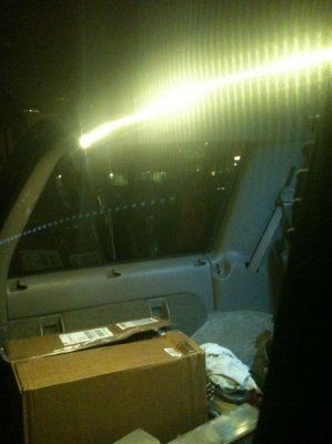

_Dylan_
STAY FROSTY
Jan 10, 2012
1,547
941
Just splice in power from the dome light circuit. I have a 42" strip in mine.
