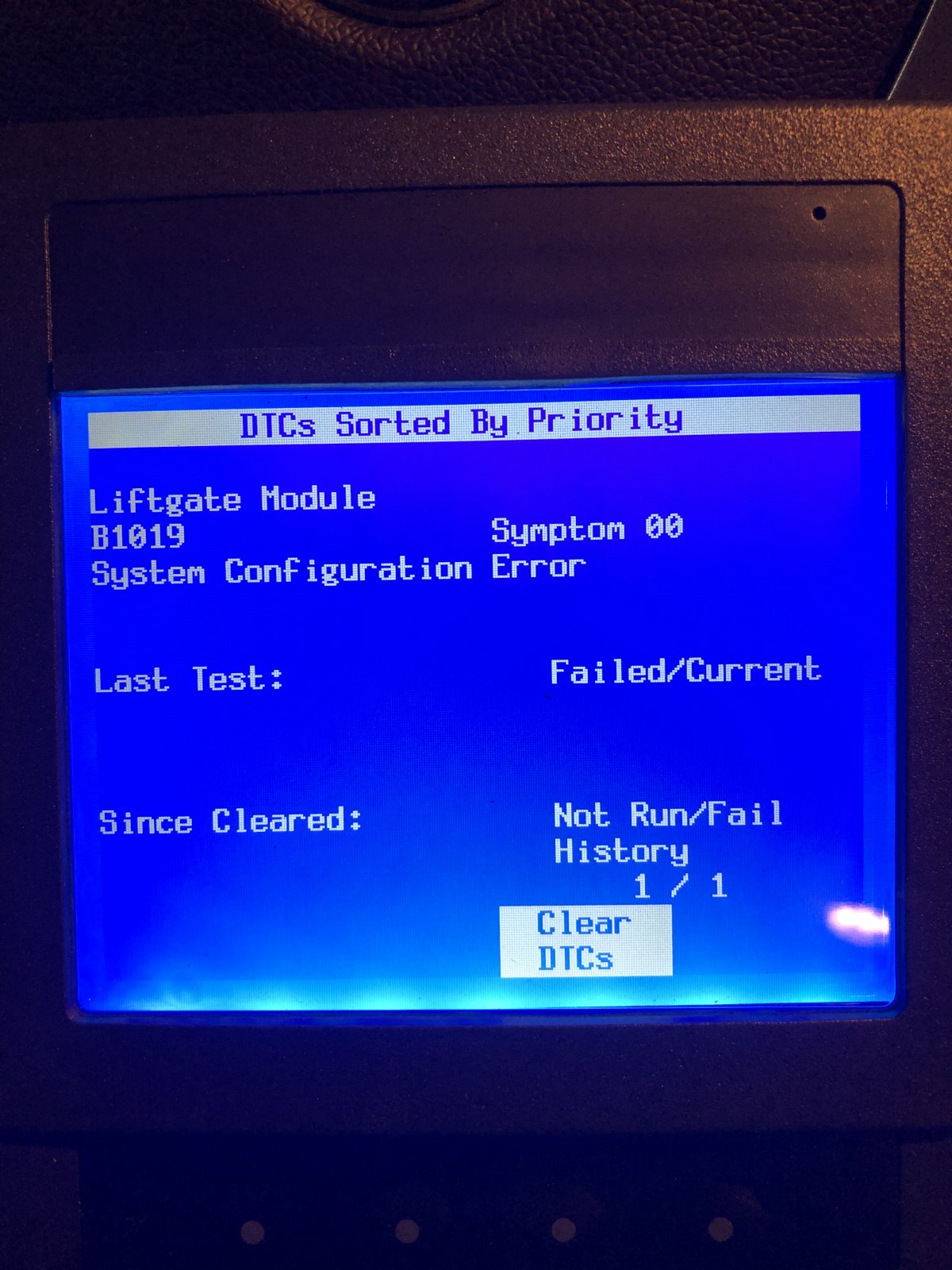

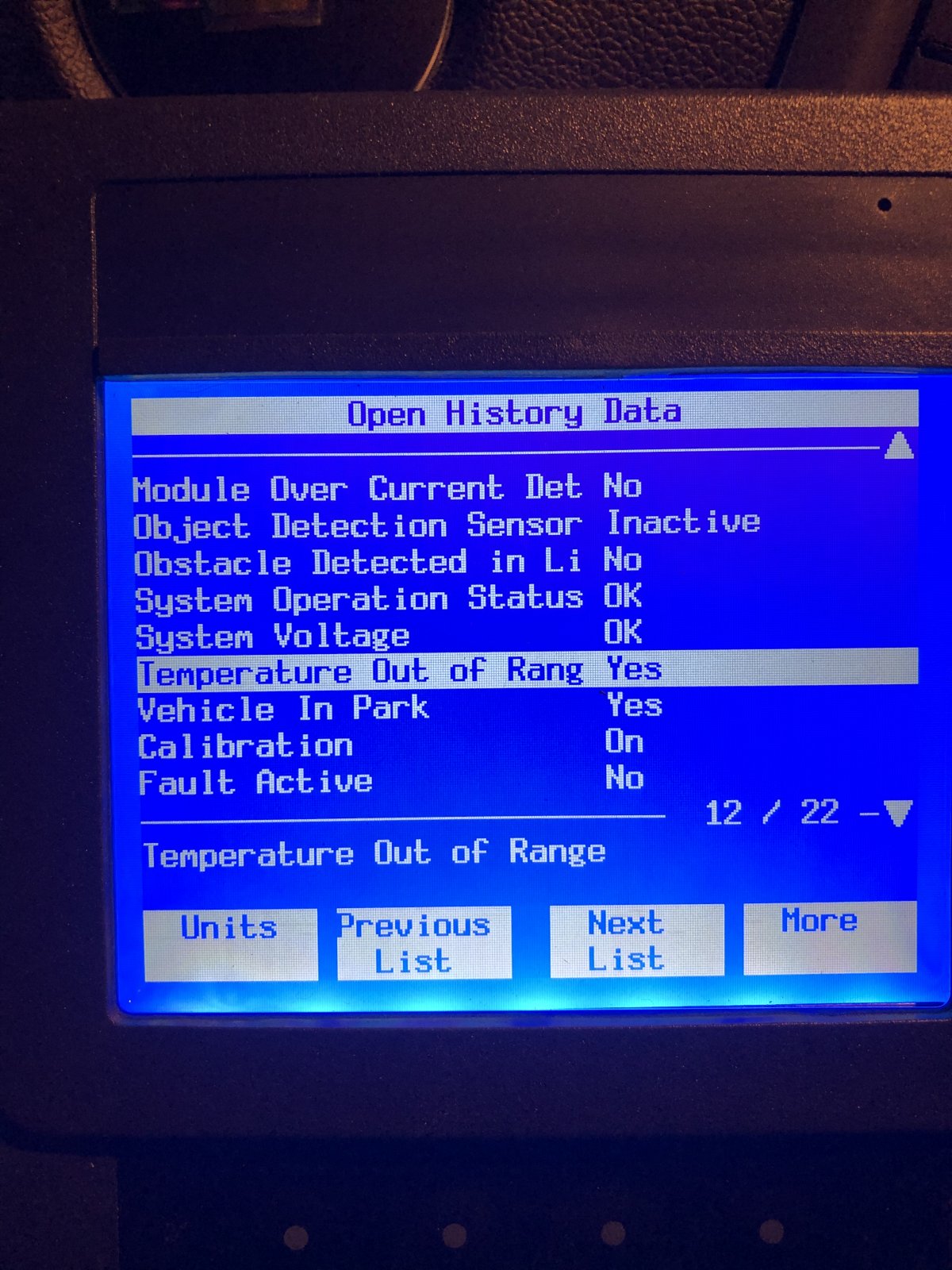

I would like to hope that is the case but so far I have been reading that guys have been had the latch act up and while it will unlatch with the grab handle it wont let the motor run. It doesn’t even try. I used to hear a different sound when it unlatched in power open mode and it would make more noises when it closed and latched.

I will check the rod connection tomorrow. It sounds like that latch has several “latched” positions it should go to and it requires them to be a certain way. Glad I have a tech2
