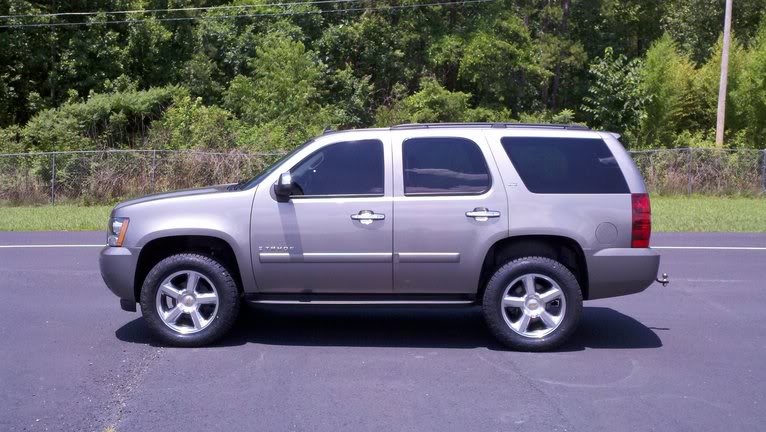

I put one on my 08 LTZ with autoride/auto level and I didn't have any problems. I questioned that very thing when I bought it from CCM, and they assured me that there would be no problems. True to what they said it was fine.
BTW, I ended up taking it off because I didn't like the look, so it is for sale in the for sale section if you are interested.
I have posted this pic a lot...but here it is with the CCM on:

yes. If you disconnect it you will get a warning message saying there is problems with the auto suspension system. I know this because I inadvertently left one disconnected when I took the CCM off!
