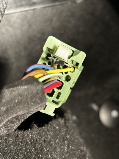

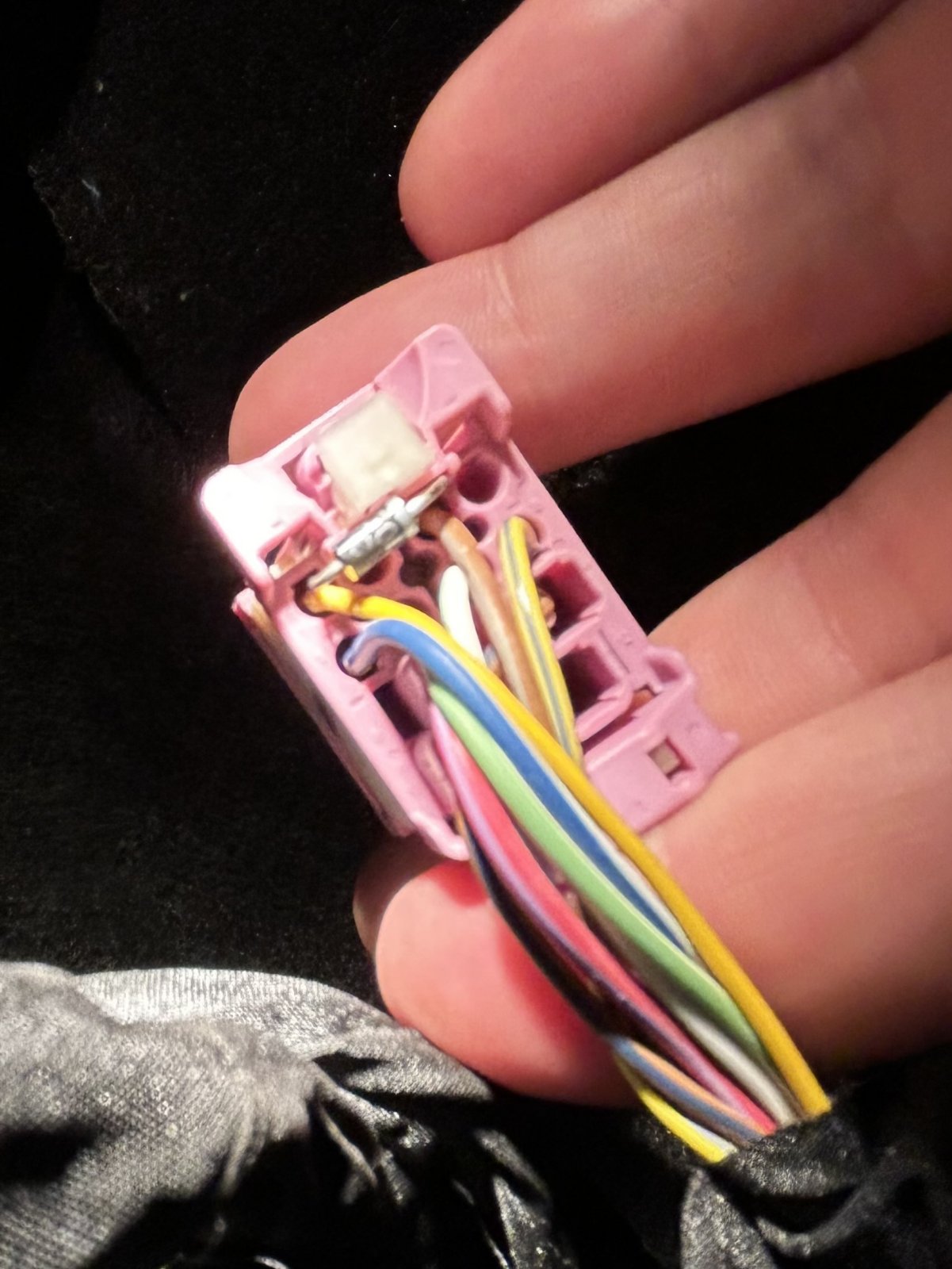

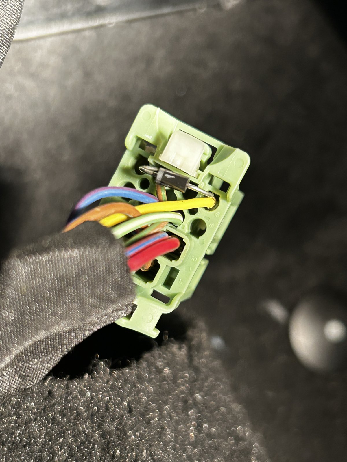

I just finished installing a home auto fog kit for my yukon denali xl 2023. Really easy with two #1N 4004 diodes. From connector X1 wire 1 yellow to connector X1 wire 3 brown and gray for the left side. Then connector X3 wire 4 yellow to X3 wire 2 brown green for the right side.
With this method, during the day the fogs are off but in the evening on low and high beam the fogs are still on.
Sorry for my english
