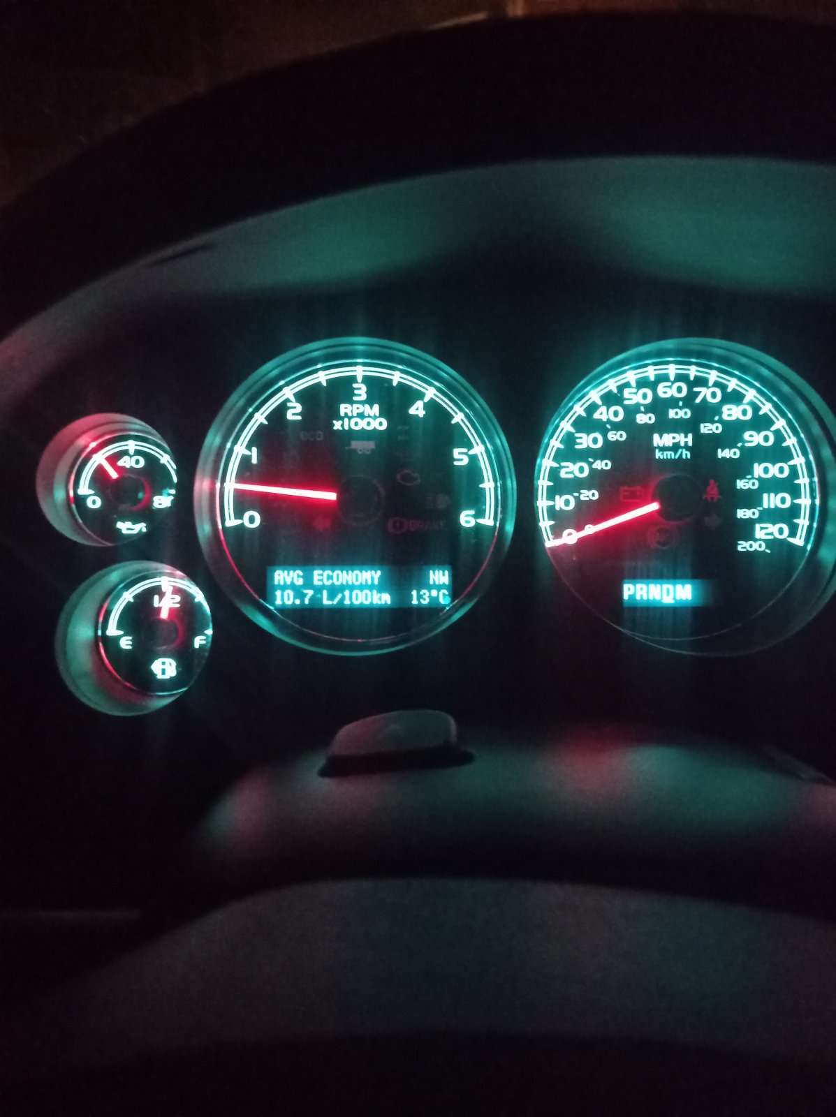

Went to visit the old folks the other day, roughly 200 miles back and forth. Went quite heavy on the pedal on the way there with the AC on full since it was a sunny day. Jumped a bit when I checked the average mpg (converted from L/100km for your convenience) it was at 14 MPG and I was like yikes! I've made a previous note about the AC because it makes a constant whiny noise when turned on. Anyhow I refused to believe i couldn't get it down to near 20mpg on my way home so I literally crawled it at ~50 mile speeds with very smooth pedaling and whatnot, AC turned off because the outside air was cool enough once it got dark. it went down to 20 alright. Actually ended up at almost 22mpg which is a really good result in my opinion.
Could of course have something to do with more uphill one way there and more downhill on the way back.
Anyways few notes since this is one of the first actual rides in my Tahoe not counting grocery runs.
Is ~500 rpm idling normal? Doesn't seem to struggle with it, it just looks low compared to what i'm used to.
Is that oil pressure gauge meant to be this active? it seems to idle right between the 0 and 40 but when I hit the gas it rises to 35 ish?
The automatic gearbox upgears downhill without touching the pedal, is this normal?
My cruise control is posessed by a demon, we have tons of speed cameras here so it's a no-no to use as is.
And does the AC truly add this much MPG? Why is it so whiny when in use though quiet when turned off (can't be a bearing since it still runs on that same belt right?)

Manual calculations?

Oil pressure gauge behavior is normal. A/C whine is not. The A/C clutch bearing turns when the clutch is disengaged and compressor shaft isn’t turning. But when the clutch engages, the shaft turns and a different set of bearings turns with it, along with the scroll inside the compressor.
My guess is you have a compressor on its way out.

RPMs is normal for emissions compliance. Oil pressure fluctuations is normal as it's based on load/speed.
Transmission uses best gears for going up a hill or down a hill with cruise control on with varying precision depending on the model year.
Running cruise control makes the engine more fuel efficient.
Yes. Pretend for a moment that you are a car company trying to eke out every fraction an MpG you possibly can,
and don't forget that you DO NOT WANT that vehicle to last too long.
Yes. More oil pressure is needed when the engine is working/playing, compared to idle.
The automatic gearbox upshifts downhill without touching the pedal, is this normal?
Yes, if the downhill is moving the vehicle instead of the engine, it allows for upshifts to happen even sooner than on flat ground.
... does the AC truly add this much MpG?
It's certainly possible, most GM vehicles run hotter with AC OFF than with AC ON.
So it's not just AC parasitic drag, if the motor oil and ATF are a bit colder, they're a bit thicker,
which lowers MpG a bit.
