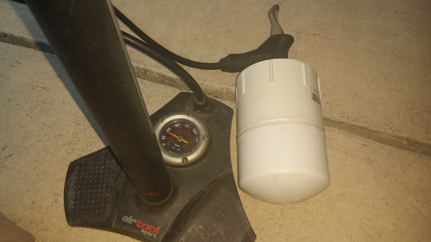

This is not my original idea, just my implementation of something I picked up browsing corvette stuff online. My TPMS sensors will not fit my wheel tire combination, so this is my attempt at disabling the alerts from TPMS. I put three of the sensors inside a pvc container:

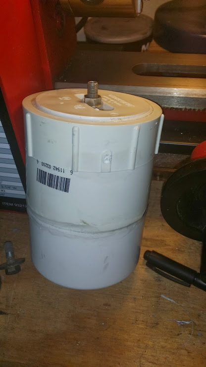

Then I installed the fourth in the screw-on lid:
Then I screwed the top on. I had hoped to use the lid to easily gain access to the sensors if I needed. Unfortunately, I had to seal the lid with the pvc cement so that it would hold air:
Then I filled up the pvc container and programmed the sensors within it like you would the normally:
All four of the sensors were picked up when I programmed them. I then threw the pvc container in the back of the Tahoe where it was out of the way but the signals from the sensors could still be picked up. Unfortunately, after a couple drives I still get this error on the dash every time I start the truck:

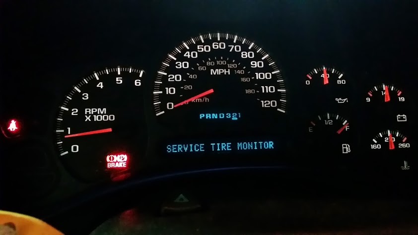

I can't figure out why I'm getting this error even though the programming seemed to work. Does anyone know of a way to find out what's going on or a way to permanently disable TPMS?

I have the same message because i ditched the pointless sensors when i changed wheels. It very easy to hit a button on the steering wheel and the message disappears.

You have a point, but believe it or not, this isn't an issue. I pressurize the container at 30psi, then start the programming process on my Tahoe, then let air out of the container slowly. The TPMS computer picks up all four sensors because all four see the change in pressure as I slowly bleed it off. I had to test this a couple times to be sure, but in programming mode the horn signals four times - one for each of the sensors.

I appreciate your concern, but 30psi is not nearly enough to be a bomb. Besides, it's wedged between cargo far in the back of the Tahoe, so it's far enough away from the soft and squishy parts of the driver and passengers. :)

Your "Air Bomb", for lack of a better term, might be a good start. I would suggest trying this, drill 4 holes in the side of your tube with a sensor in each hole. That way you can 'program' each sensor, individually, the way your supposed to. And, they won't bounce around inside. And, I agree, I don't think 30 psi is all that dangerous. PVC is pretty tough stuff.

At 30psi you would be well below the max pressure of PVC. Most water systems are between 60-90psi.

They do not time out. They just quit working. I'm guessing the battery in them goes dead. Rotating your tires requires them to be reprogramed (at least on my 04 and I'm guessing all NBS, or at least the 03-06).
You may think it's working but all you are doing is programming the one you are putting air into to each location. Once the computer realizes it's the same sensor at all four locations it throws up an error code.

Your comment on the pressure change with the rise and fall of the temp might be something you need to consider sense the tube is much smaller than a tire. You may constantly get pressure errors because there just isn't the volume there compared to the tire...
