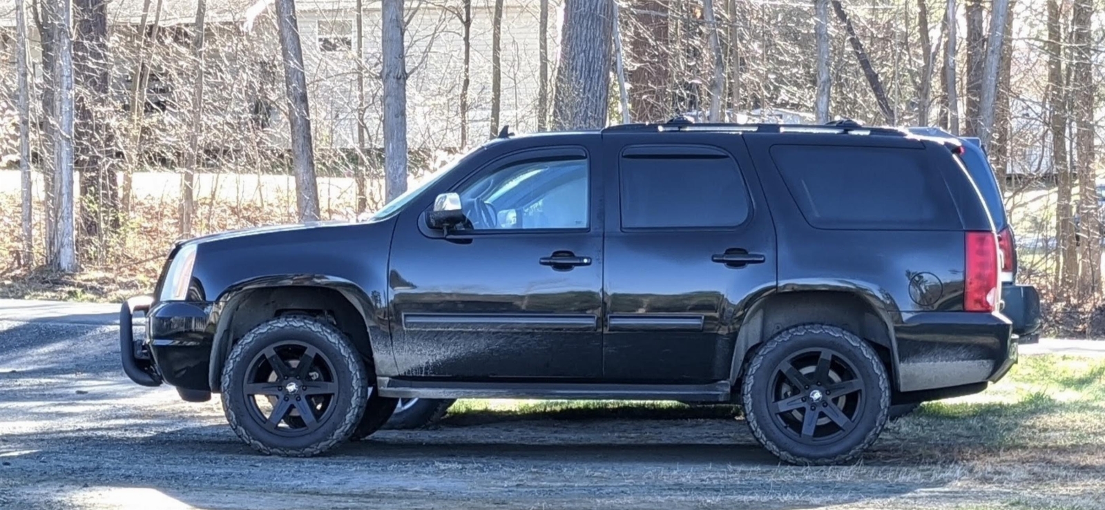

Here's what looks like with just the 1" level block in the front (under the shock mount) on P275/60R20 tires & aftermarket wheels. The tires fit fine w/no rubbing before the level kit was installed, so I assume the small offset of the wheels helped negate rubbing. After installing the Husky mudflaps I only needed to trim a little bitl of the inside of the flaps to clear the tires during full-lock.

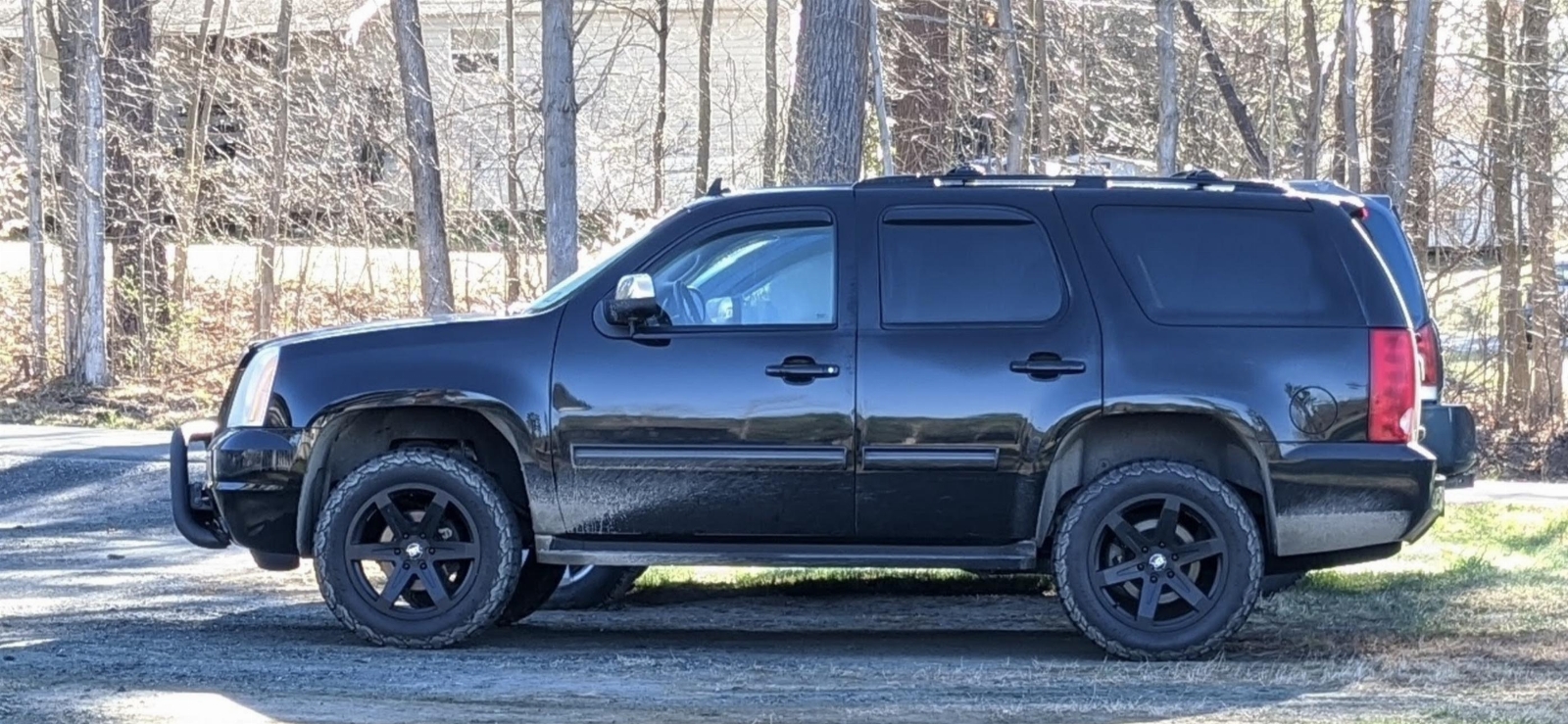

Nice & Thanks!
