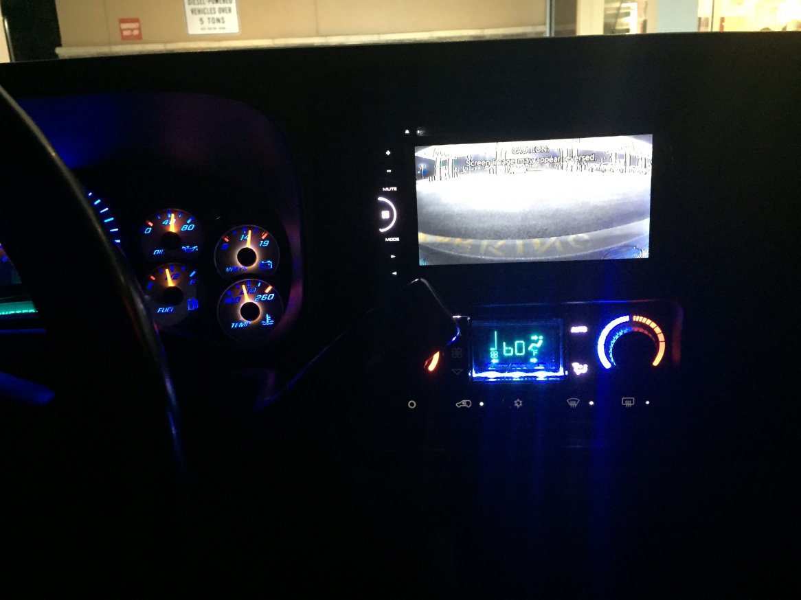

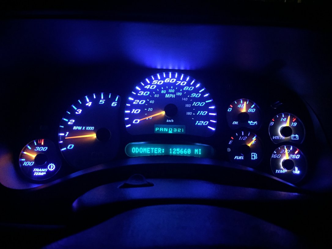

I recently upgraded my cluster & A/C Digital control with the LED strip. As for the A/C unit, its all about how you place them inside the plastic housing, or you will have issues with all the buttons working properly if the strip is directly on the board.

The AC control was easy to do with individual 12V leds. I'd like to see the led strip laid out in the gauge cluster.
52,949
I started this on my '02 Denali by testing it out on some extra HVAC controls off Ebay. I gave up after awhile, too much of a hassle. The lights are mixed in series and parallel and you need to figure which are which, very tiny to solder, the LED's are polar which means you have to know which points on the circuit board are + and -, you need to add specific value of resistors on the LED's, etc. I had the boards hooked up to a power supply so I could test them indoors and it seemed as soon as I got 3 lights working the next one I soldered in would take another one out. Very frustrating. It would be worth it to send them out. The cluster was easy though, they just twisted in.

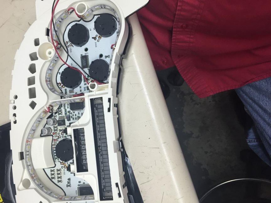

Here is a pic of the LED strip installed in the cluster. Sorry I didn't get a full pic but is give you some what of diagram to follow.
Where did you get that cluster? Looks great.

It was my original cluster but just added a different gauge face & Cool White LED strips placed nicely inside the cluster.
