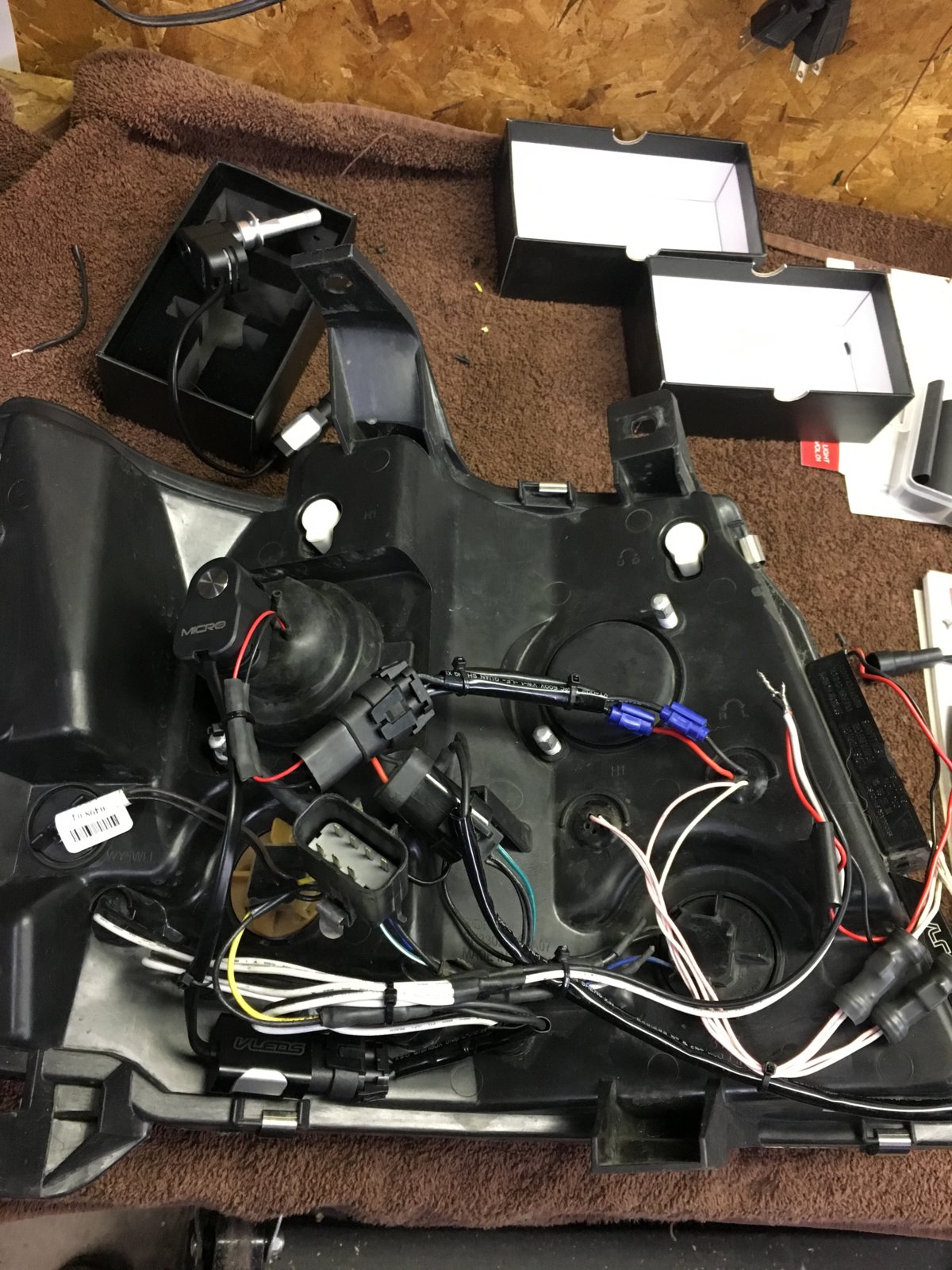

So i ended up buying The retro fit source Spyder upgrade projector kit. see below
https://www.theretrofitsource.com/p...o-retroquik-spyder.html?preselect=51266,47860

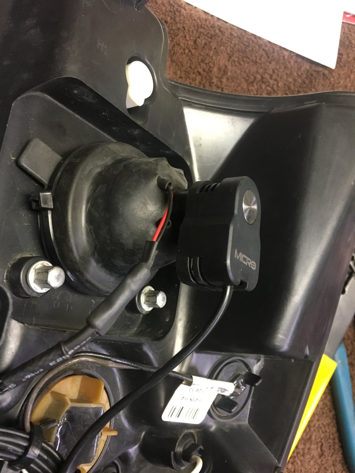

Then i bought VLEDS Micro LED 6k, see below
http://www.vleds.com/shop-products/led-headlights/h1-micro/micro-h1.html

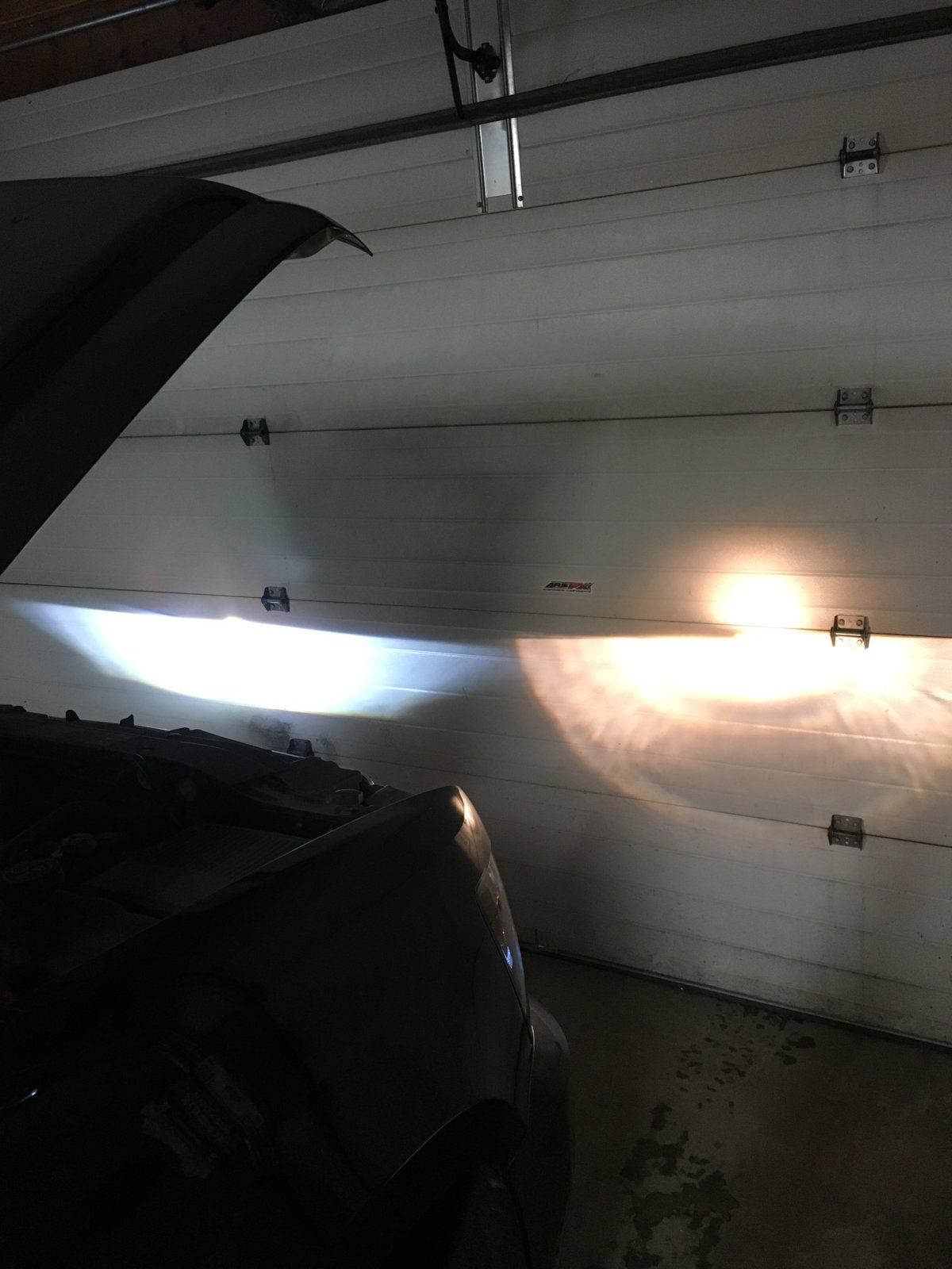

I have completed the retro and install on the truck, have just yet to get proper alignment (exact alignment will be impossible)
Here is the biggest problem, the passenger projector mounting locations in the spyder headlight were not level horizontally. So making a perfectly straight cut off line is impossible.(its annoying as hell, but im hoping ti will be better once i can bring the drivers side up to closely match)
I have modified the headlight mounting as much as possible and it is as good as it will get.
This was the most frustrating thing, as really you can't do anything to change it, its the factory mounting in the spyder headlight. Now the driver side seems very level. Whenever i can get the bumper off and try to adjust the driver side a little better i can post up some pictures, just haven't got around to it yet.

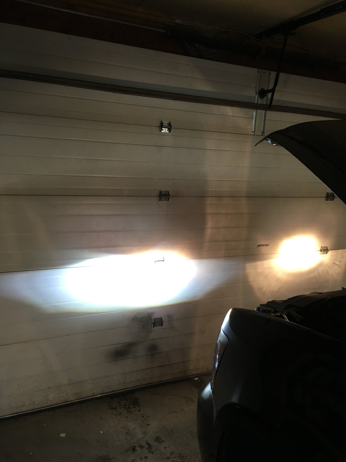

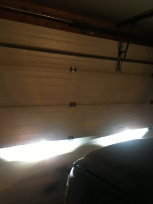

Now, light output is tremendous compared to before, even without proper alignment (driver side is low, passenger height is good).
I did wire in the bi xeon solenoid to open when high beams are activated, the high beam output rocks.
Ill try to upload some install photos i took. Also i will try and get some actually night shots when i can complete it. A young child equals much less garage time.
