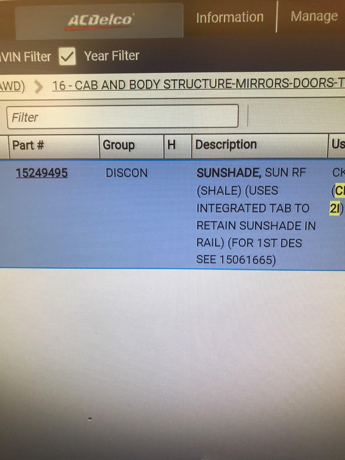

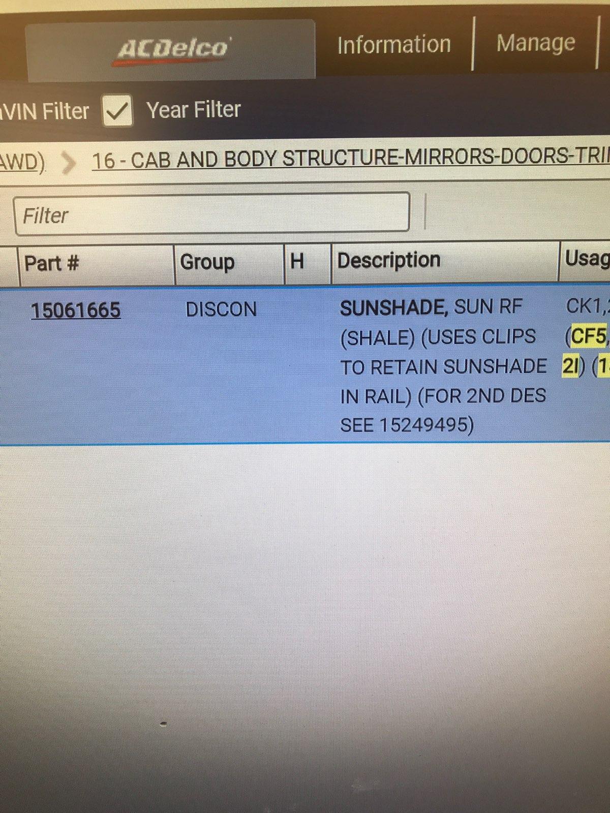

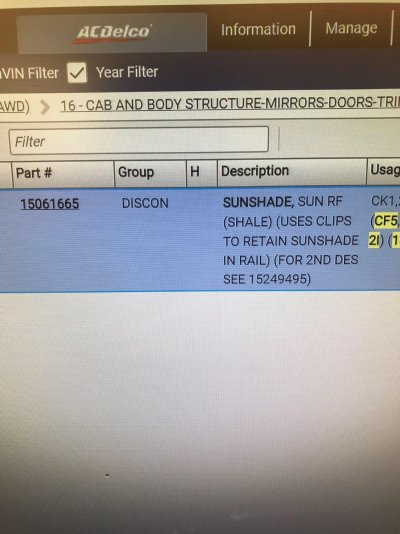

2 designs
Discontinued Both

Yeah I figured it was discontinued. I can find the beige ones on eBay but no pewter.
I can try to redo mine again but I won't be able to use the fabric. It's far too damaged.
