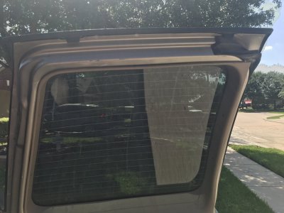

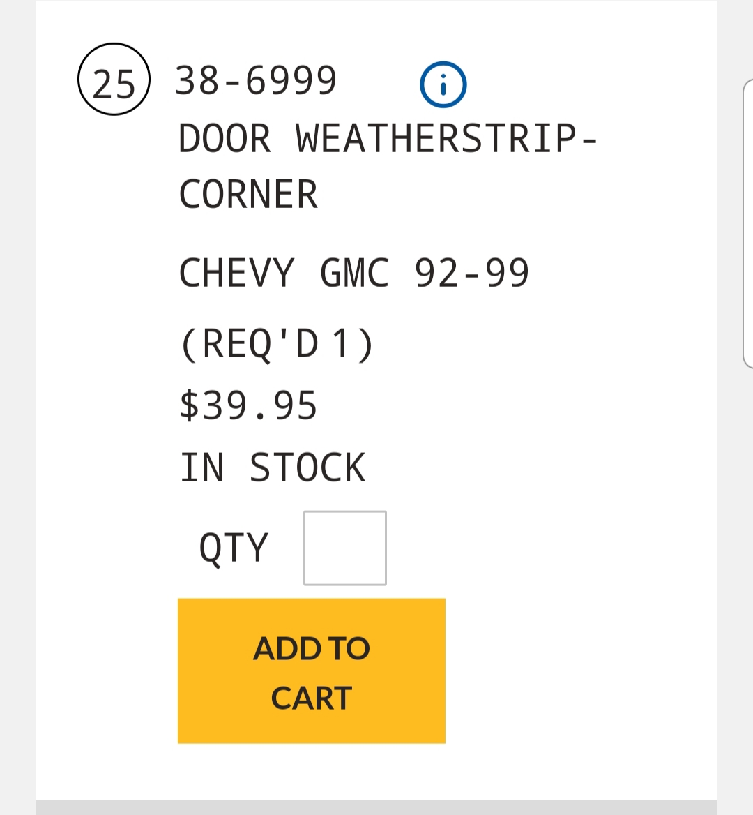

Says it fits Blazer/Tahoe 92-99 so wouldn't think model year matters.
33,162
51,352

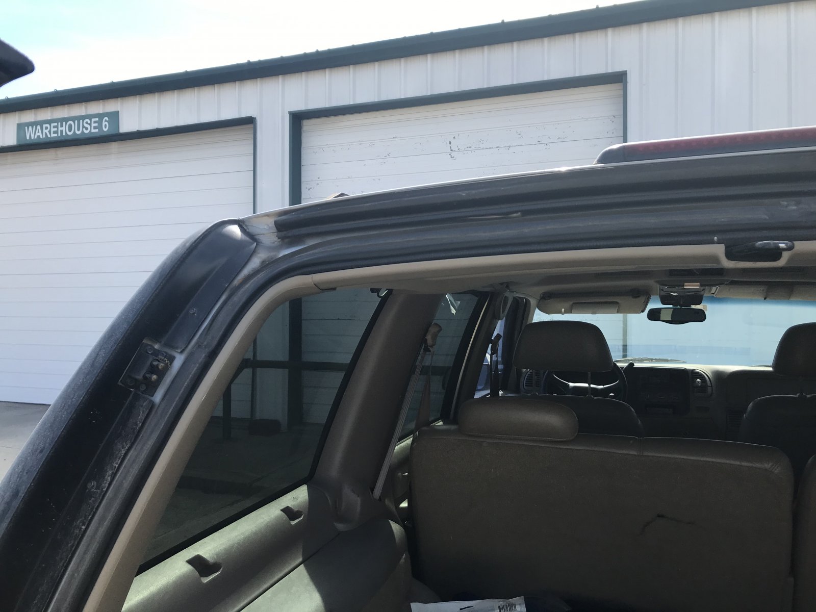

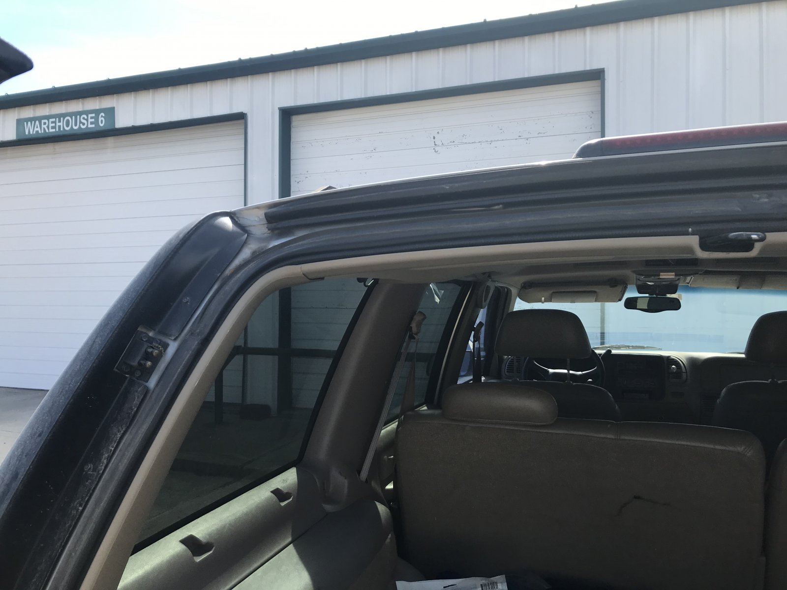

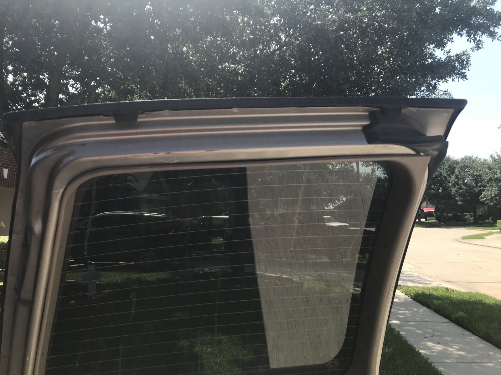

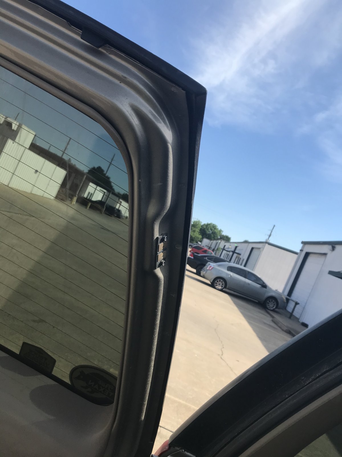

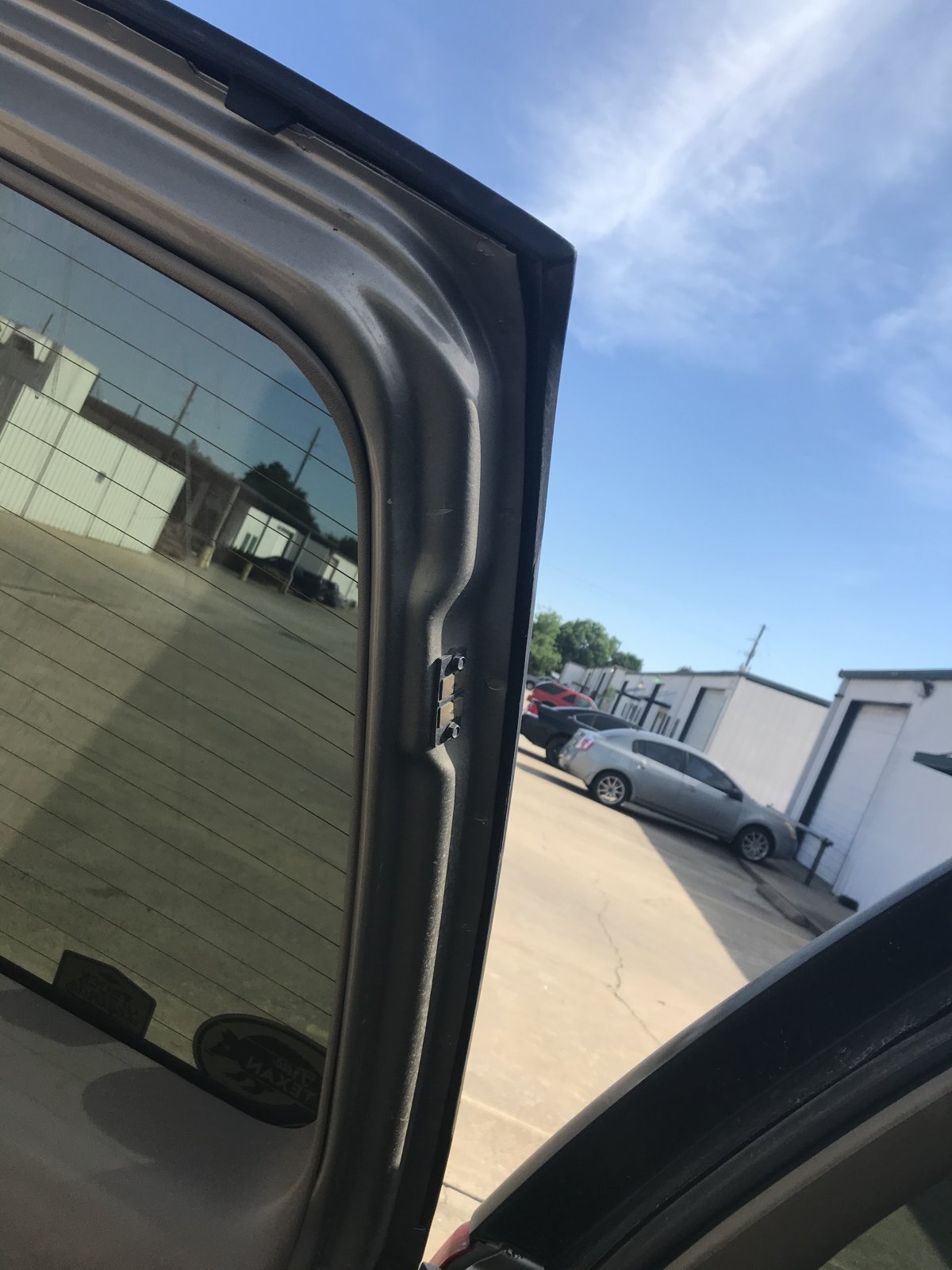

That's the weather strip in the upper corner. Do you have a gap in that corner where the upper gasket meets the gasket going down the side? Or is it just metal exposed?
Could just be flattened from age too, allowing water to get through.

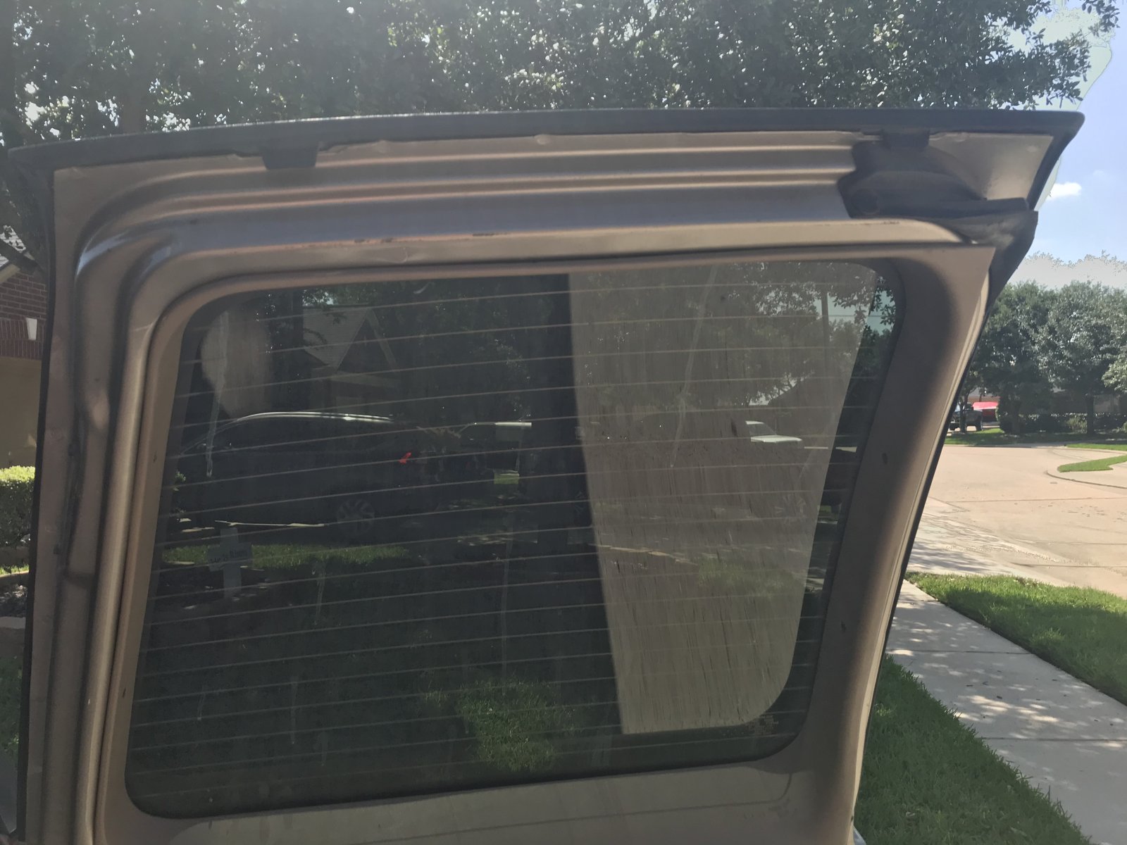

That's the weather strip in the upper corner. Do you have a gap in that corner where the upper gasket meets the gasket going down the side? Or is it just metal exposed?View attachment 246010 View attachment 246011
I have the flat piece that runs east west and then the surround a little lower. There is a flat metal edge about 1/2" long on either side of the east west piece. I wonder if cleaning the gasket and all the stuff we've done has left a gap that wasn't previously smooshed and now I got intrusion?
33,162
51,352
Gaskets loose their flexibility over time--they just go flat, letting air and water get through. Maybe you can put some thing under it to bring it up some--other just replace it and be done with it--looks cheap enough.

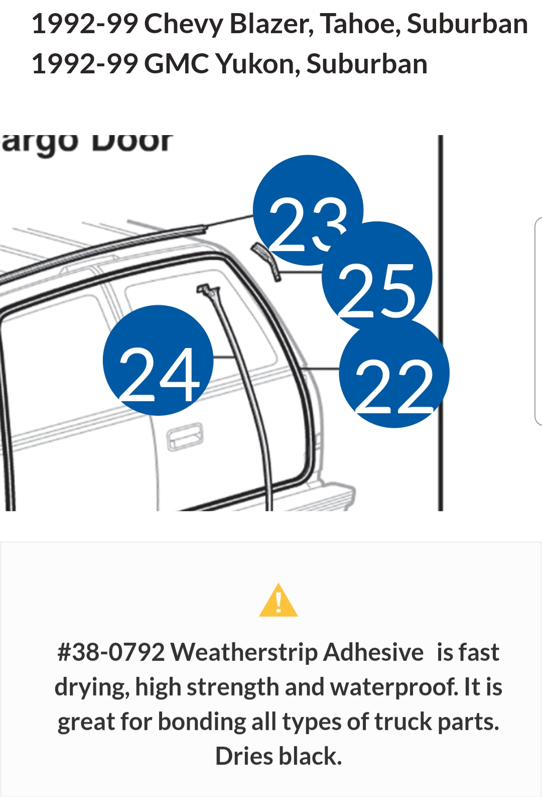

Might just replace. Just need to figure out which pieces I need.

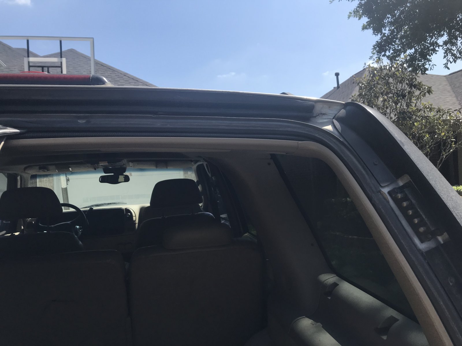

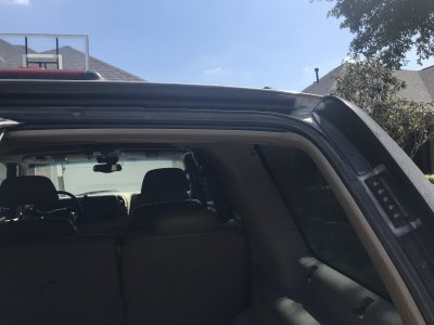

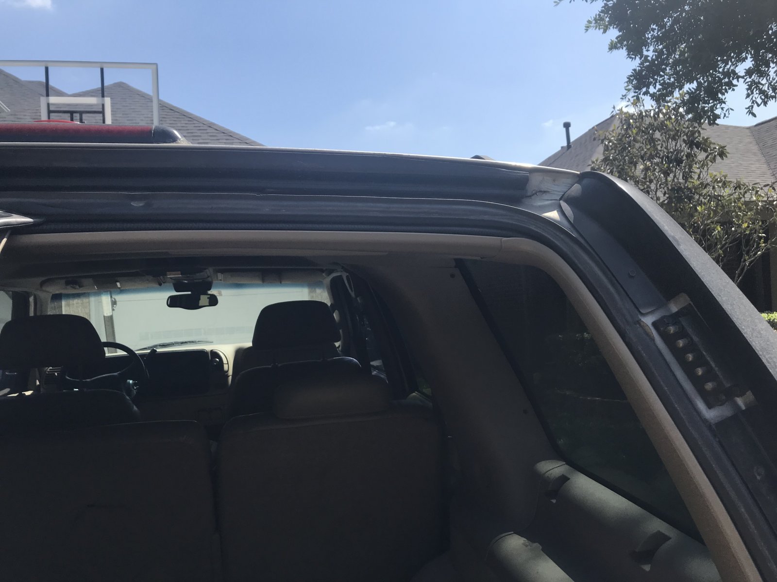

Can you take a pic of the upper passenger side? Hate to be a pain but I want to figure out if I need that one corner piece, LMC shows one needed on the right side, against the body to the right of the long east west piece
Will do in the daylight
exp500
May 14, 2017
2,016
1,965
Looks like#25 pushes seal in place, you have the electric contacts right there too. Check that the seal around corners is attached to body well. Don't want water behind seal. Wipe entire seal with wd40 after it is clean, or wipe it twice, 1st cleans it. ( one of my 3 uses for WD40) Leave doors open in the sun a few hours, seal will dry off and swell back up to normal. I don't recommend those Li Made Chit door seals to anyone, have to urethane them in place.
new door seal comes Sunday, when it's supposed to rain. We have the back trim out of it to see if we can figure out exactly where the water intrusion is coming plus a tarp handy if it starts leaking really good. Tim re-sealed the third brake light, I guess he messed with it when they did my roof rusting job.

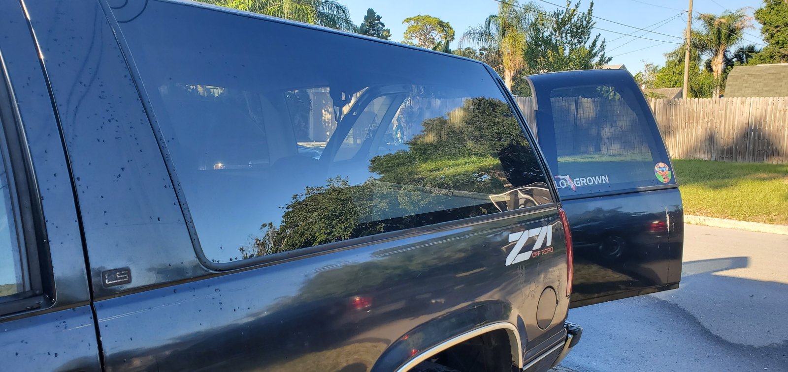

Did a better water test today and guess what is leaking? Quarter glass window seal on the driver side. Got someone coming on Monday to replace. $245 installed which is way better than I expected. And it's gonna pour on Sunday so we will tarp her again.
dkknaebel
dkknaebel
Keeping LKQ in business
Sep 25, 2017
438
726
St. Petersburg, FL
Got the quarter glass installed today. $245 + tax wasn't bad. The guy who did it also did the windshield. He said Betty was looking good. Not only was the rubber seal lifting at the left rear lifting but water had gotten behind there and rusted out a small pinch weld seam and made a pocket for the water to go from the corner, down to that pocket and along the headliner. And you couldn't see it without the glass out and pulling the headliner down a bit. Tim installed the replacement weatherstripping and really seated it with a rubber mallet and we are good to go. And rainy season is fast approaching.
